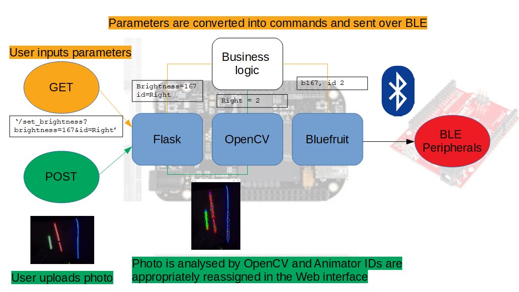

2.The Beagle Bone
Beagle Bone Black Wireless has proven invaluable in this project. Serving as the brains of the system, it creates the Web interface and also makes and maintains the BLE connections with Animators. It runs a single Python script, main.py, that covers everything from Bluetooth to Flask web interface to image recognition, each elaborated on in separate updates. The components are also briefly described below. They are all connected together by Python's Multiprocessing, running one loop continuosly for the BLE, and one function when the image analysis has to be performed. The Flask app is the main one, it starts first and runs in the foreground. The subprocesses exchange information via Queue and Value objects provided by the Multiprocessing module. Here is a graphical overview:

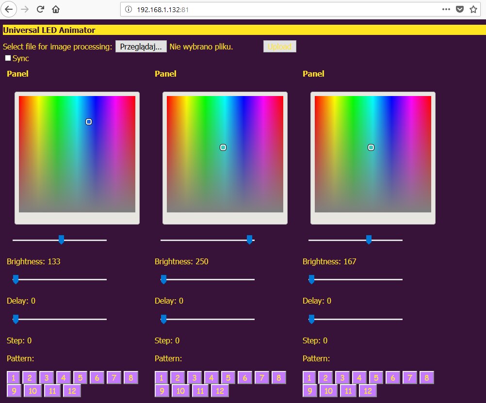

3. HTML & JavaScript
No web interface is possible without some HTML documents or HTML embedded in Python code well technically a plain text interface can also be served, so after walking through tons of tutorials, I managed to make something that doesn't really look great, but it does the job:
The index.html holds just the title bar, file selection form and sync checkbox. All other parameters are accessed via IFrames that I want to dynamically generate based on the number of connected BLE peripherals, but at the moment there are always three. The colour picker, sliders and buttons are described here, and everything is served via Flask. Style is provided by <style> markups directly embedded into the HTML docs:

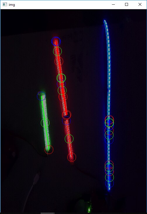

5. OpenCV
The analyse() function ran by Multiprocessing in the code snippet above is the OpenCV script I'm using, with most debugging features removed. It fires up immediately after the upload is complete and runs in the background. Here is more on the algorithms used, let me just repost this pic that I really like, presenting the effects of line-tracing on a photo taken of the LED strip setup:
Unfortunately due to time constraints I could not implement direction recognition like I originally planned to - a big problem here was making some calculations on the Blend side, while the Blend is grossly overworked at the moment, with hardly any Flash and just a small bit of SRAM left unoccupied. Also, recognizing strips' orientation is implemented, but the IFrame titles are not changed based on this - again, not enough time to add the feature. Still, OpenCV serves very well to identify which strip went where, turning IDs based on when the BLE connection was established into real-life relative locations.

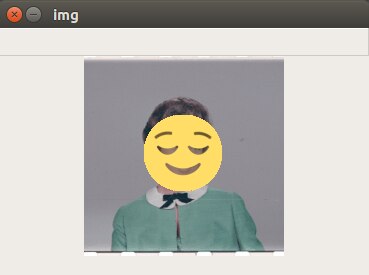

And let me also mention again that when learning for this project, I taught myself how to algorithmically put emoji on people's faces:
No people were harmed.
