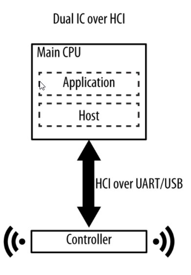

Raspberry Pi supports Bluetooth Low Energy because they integrate a combo Wi-Fi + Bluetooth chipset. The exact chipset supported varies depending on the board being used. For example, Raspberry Pi 4 has a CYW43455 chipset with support for 802.11ac and dual band (2.4GHz and 5GHz), whereas older Raspberry Pi boards used BCM43438 chipset from Broadcom. But... here comes the first problem: Raspberry Pi 4 uses this hardware configuration
The Bluetooth controller is an external chip and communicates with the main CPU on a UART which is, unfortunately, the same UART used by the Gertbot board. For this reason, I had to disable the Bluetooth interface (see this post for further details). Luckily, I have a USB Bluetooth dongle that I can use as a replacement.
BLE Network architecture
In a typical BLE network, there is a central device (e.g. a smartphone) and one or more peripheral device (e.g. the Gr0G box, or your smartwatch). The way the central device interacts with the peripheral device is defined by GATT (Generic Attribute Profile). GATT is based on the concept of ATT (Attribute Protocol)

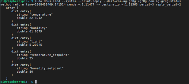

D-Bus service
A D-Bus service is not a strict requirement. I could have integrated the code that implements the BLE service in the Gr0G's main application. However, the use of a separate process for this very specific feature brings all the advantages that are intrinsic in a modular design: reliability, clean interfaces, maintainability
The Gr0G main application will expose a D-Bus interface named com.ag.gr0g with just two methods
  • status: returns a json object with the following fields
    • temperature
    • temperature_setpoint
    • humidity
    • humidity_setpoint
    • light
  • cmd: allows a client to execute a command. Supported command are
    • setlight: switch on or off light, thus overridng automatic control
    • humidity_setpoint
The class that implements the D-Bus interfase is TheGr0G and can be found in dbusservice.py
Some special decorations are needed to indicate that a method is exposed on the D-Bus
    @dbus.service.method("com.ag.gr0g",
                        in_signature='', out_signature='a{sd}')
    def status(self):
With this decoration, we are saying that
  • the method is part of the com.ag.gr0g interface
  • there are no input parameters (in_signature='')
  • the method returns a set of tuples of (string, float)  (out_signature='a{sd}')

I can now test the D-Bus service using the dbus-send command line utility
