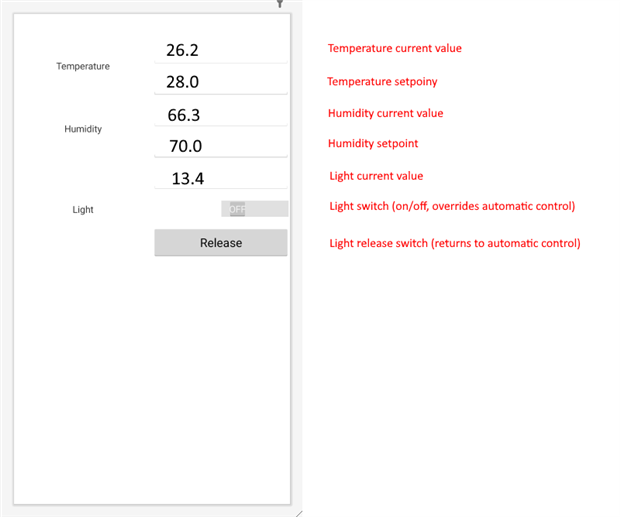

When a BLE device is clicked in the list, the DeviceActivity is opened. This activity receives the Bluetooth device that has been selected as an extra parameter.
The DeviceActivity has the following layout
The first think to do, is to connect to the device itself
