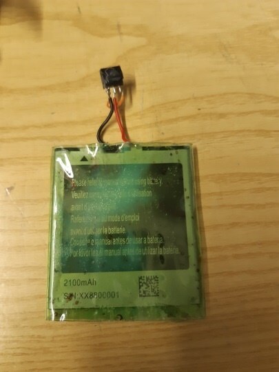

In this post, I will provide some details about the case I built for the ACE wearable device
Building the case
Compared to the first version I made, I created a new case from a plastic bottle. The resulting case has many qualities
  • it's free
  • it's made of recycled materials
  • it's light and surprisingly rigid
  • it's easy to build (event if it needs some practice to get good results)
All in all, this technique it's a good solution to make parts with simple shapes quickly and at no cost

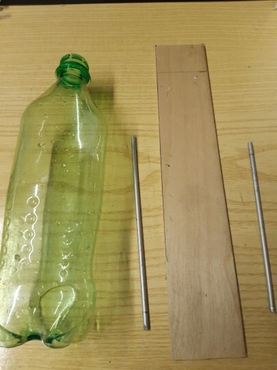

Bill of materials
The bill of materials for this build is
  • a board of plywood cut at the same width of the better. Length is not important
  • two round bars of aluminum. Again, length is not important here
  • a 66 centiliter plastic bottle
  • tape
Required tools are
  • scissors
  • cutter
  • hot air gun

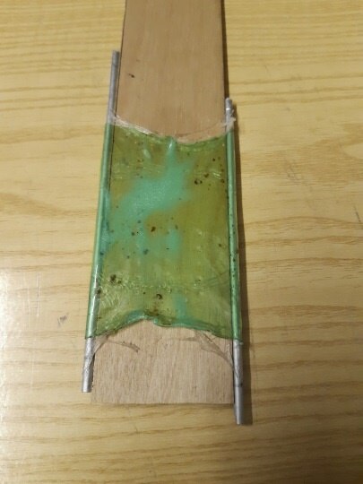

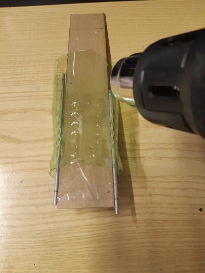

Forming the case

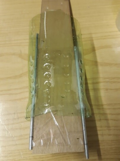

Use same adhesive tape to keep the round bars close the the plywood board
Cut the top and the bottom of the plastic bottle place the plywood board with the aluminum bars inside the bottle

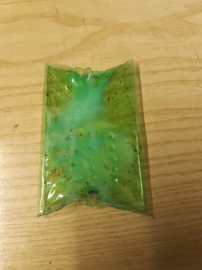

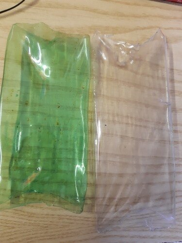

With the hot air gun, heat the plastic bottle until it shrink and takes the shape of the plywood board. I need some more practice here, because the temperature at which the thermoplastic material can be modeled is very closed to the temperature where the material becomes liquid. Of course, the material should not be melted down, or the final result will not be so good to look
This is the final result. As I said, I need more practice for a perfect result...
Remove the aluminum bars and then the plywood board. With the scissors and the cutter, finish the edges

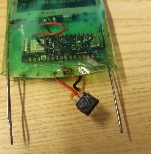

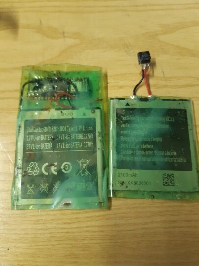

The batteries and the boards fits perfectly in the case. I wrapped batteries with some tape to be absolutely sure they will not slide out

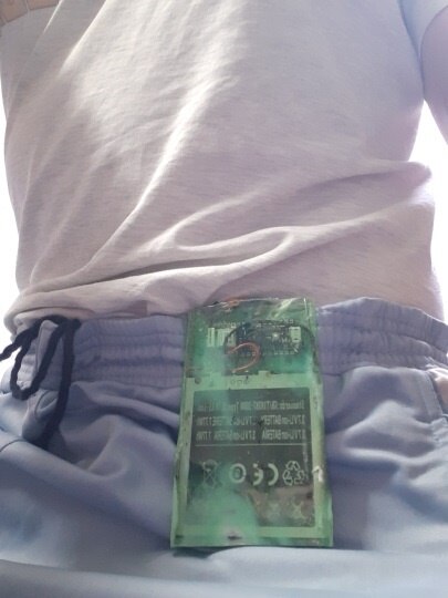

Finally, I added two clips made of harmonic steel to join the two halves and make a sort of clothespin you can pin to your trousers
And this is the final result
Update
After some practice results are getting better
The trick is to use to be patient and move the hot air flow away for a couple of seconds when the plastic starts shrinking

    The low-cost housing is a great idea, thanks for sharing. I think PET bottles soften and melt at a temperature much lower than a typical hot-air gun, hence the scorching: maybe try a larger outer enclosure…
