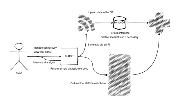

Overview of basic functions is visible below:
Initially we wanted to send the data over BLE (assuming no WiFi connection) and then send the data to the server with the ML model via cellular connection. However, we checked and it seems like we cannot send commands to the host device (mobile) via BLE. Therefore we need to change our approach slightly.
We also thought, that some models may be deployable on the device directly. However, since this is medical world, most of the models require quite big complexity (more on that later), and we would require either external memory or offloading the models to a server (what we chose).

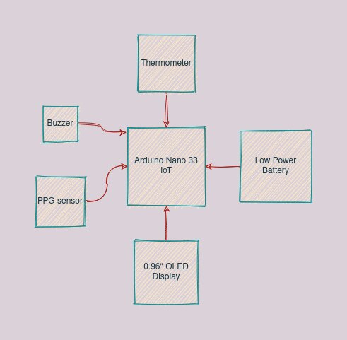

The components used in the project are listed here for brevity:
  • Arduino Nano 33 IoT - main MCU + WiFi/BLE + Secure + IMU
  • MAX30102 - PPG and SpO2
  • Galvanometer - skin resistance
  • LiPo Battery - mAh still not decided upon
  • 0.96" SH1106 - display
  • Small bezels, such as pushbuttons or a buzzer
A small graph visualizing the system:
