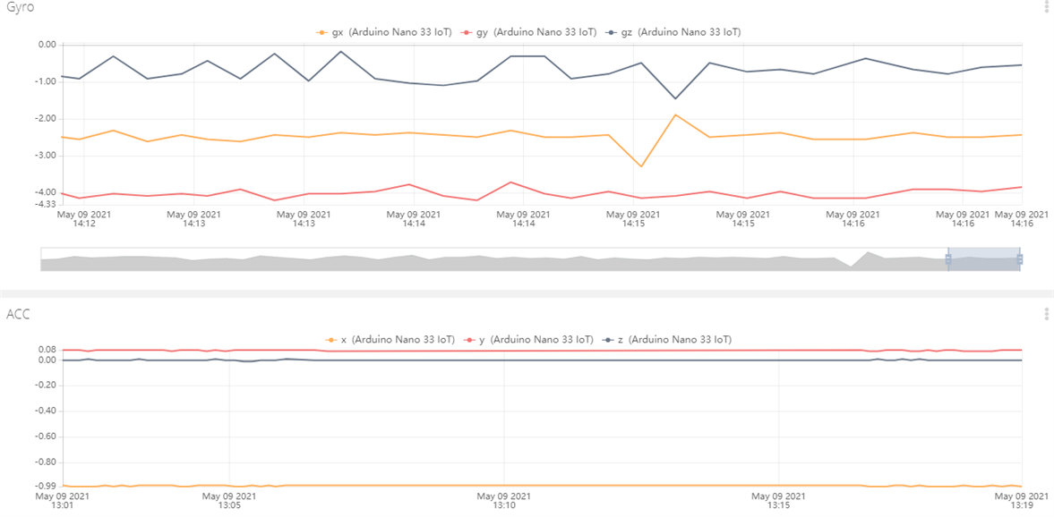

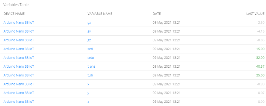

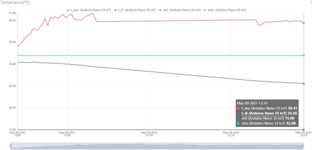

IoT Dashboard
Live Parameters
Heat sink Temperature(analog type)-t_ana
Inside container Temperature(digital type)-t_di
Reference values
(Inner)-15*C
(Outer)-32*C
Accelerometer- x,y,z
Gyro-gx,gy,gz
Temperature- https://stem.ubidots.com/app/dashboards/public/widget/xgp5XfhBtZXIcAdTjsxINB-UeFOWUiCEFZ5xeI047lQ
Table--https://stem.ubidots.com/app/dashboards/public/widget/Z8IStnEENTVZIXRGaR5D6SXMQ-dcQN_mOBkmrquTBFc

    Jan Cumps over 5 years ago +1
    Do the ubidots widgets work with a fixed date range? I get "No data withing given date range" when following the hyperlinks.
  • sidastro
    sidastro over 5 years ago +1
    thanks for feedback I just change the span of data now links are working
    Jan Cumps over 5 years ago in reply to sidastro
    Yes! Thank you.
