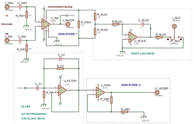

Step - 01:      design of a simple Bio-Amp with filters for single LEAD ECG

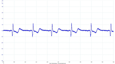

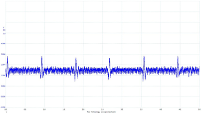

For LEAD I configuration, the conventional LEAD arrangement produces an output of about 0.6 Vp-p. The resultant signal has 50 Hz [in my country] component contributed by the body [common mode signal] and the mains ground of the oscilloscope and hence the computer. In real life the 50 Hz component will be less as because the whole system will be driven by battery power supply and there will be less 50 Hz interference in an open playground. However, a digital filter can be implemented in the software end, but we'll lose information [like P wave will be flattened]. It's not a diagnosis purpose ECG and a very few amount of information can be found by only one LEAD. So, considering that the detailed wave shape is not much important here, we can implement digital filter if it's necessary later on.
image image

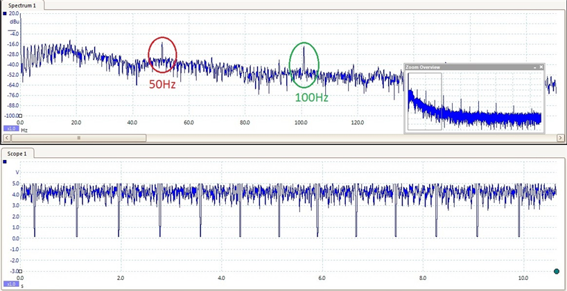

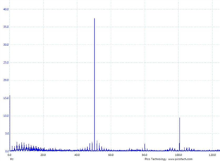

Above ECG plot is for LEAD1 captured from ARM using clip electrode. For chest arrangement, the electrodes are placed too closed to RLD or the reference of Einthoven's triangle, which results an ECG output with slightly different shape for T wave and comparatively reduced QRS complex. However, the overall peak to peak voltage is increased from 0.6 Vp-p to about 2 Vp-p for chest arrangement.
the output seems to have high 50 Hz component. If we look into the spectrum view -

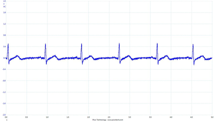

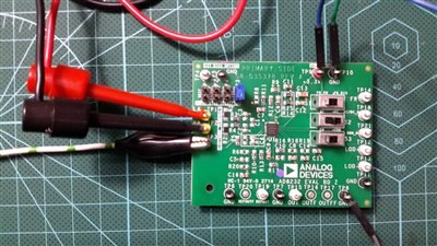

Step - 02:      compare output of AD8232 ECG module
I have tried to compare the output signal of a single LEAD ECG captured by AD8232, a single chip ECG Bioamp designed by Analog Devices Inc.
Spectrum view shows that 50 Hz noise is added by oscilloscope.

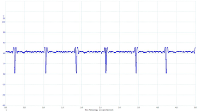

By using an opto-isolator, the 50Hz noise can be eliminated. However, it also inverts the ECG output.

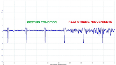

If I compare the output of previous Bio-Amp and AD8232 output -
It shows that the AD8232 is missing detail information in the signal. Like the P-wave is flatten and the whole T-wave is superimposed with the 50Hz noise.
May be that’s because of the filter bandwidth. In my design I had captured in between a range of 0.3Hz to 159Hz where AD8232 limits the low pass far below 50Hz to get rid of common noise. However, this won’t be necessary as it’s not for diagnostic purpose. I just need to get the heart rate with single LEAD ECG, so it’s pretty good enough. Moreover, AD8232 produces a better, sharp QRS complex which will be more helpful.
However, AD8232 responded effectively for removing motion artifacts. For general movement, it maintains the output signal pretty good. But for fast strong movements or contraction of the muscle the signal gets distorted. I have to check it's performance over motion artifacts once again after mounting it on human body.

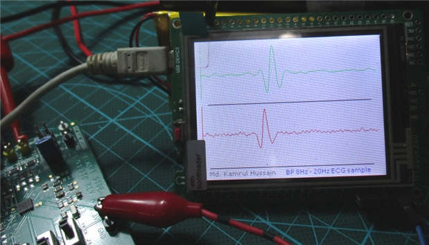

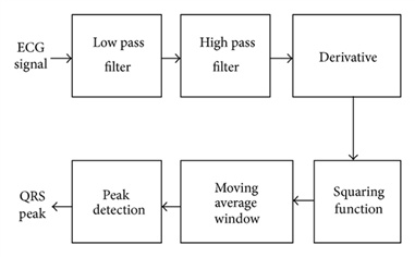

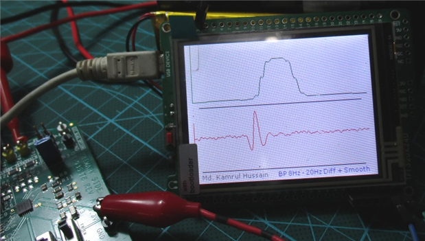

Step - 03:      process the output and apply heart detection algorithm using dsPIC33EP512MU810
For Heart Beat Rate detection from QRS complex of ECG signal, I have used a modified version of the algorithm developed by PAN and TOMPKINS [1985] and further described by HAMILTON and TOMPKINS [1986]. This algorithm has several steps -
  1. Filtering
  2. Slope detection
  3. Moving  Window Integral
  4. Amplitude analysis
  5. Width analysis
Block Diagram -

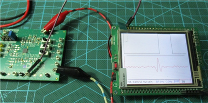

I have used AD8232 AFE EVAL and MikroMedia dsPIC33EP from Mikroelektronika in this experiment. Later on the dsPIC33EP256MU810 will be used along with RN4020 BLE module to send the data to Arduino NANO 33 IOT through bluetooth low energy.
Output -

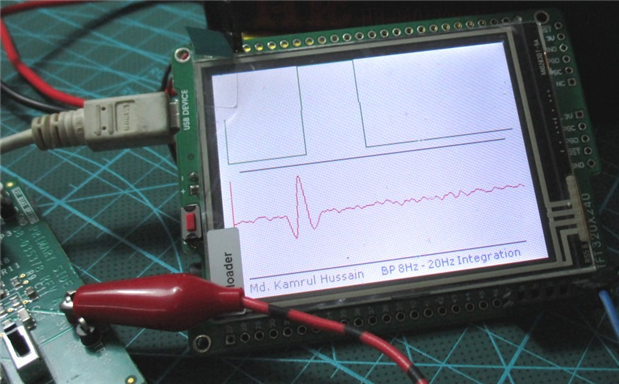

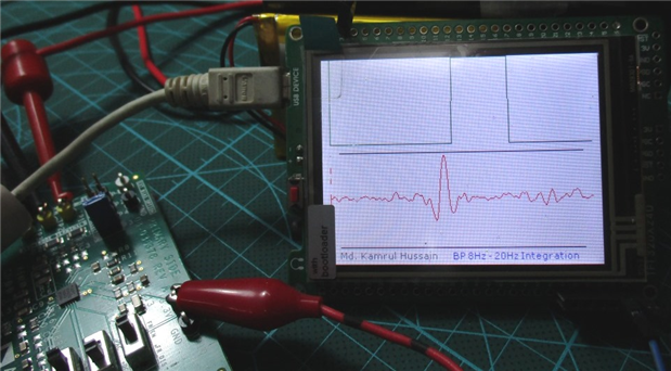

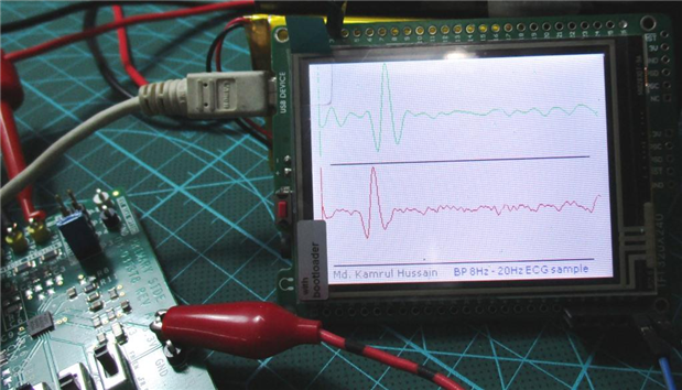

Output of the QRS complex detection at different stage of applying Band Pass Filter, taking Derivative, Squaring function, Moving Window Integral and applying threshold are presented below.
{gallery} QRS complex detection
Band Pass Filter: 8-20 Hz 32nd order FIR Bertlett with 366Hz sampling at resting condition
Band Pass Filter: 8-20 Hz 32nd order FIR Bertlett at 366Hz sampling with rapid body movement
Signal conditioning: After taking Derivative, Squaring function and applying Moving Window Integral at resting condition
Signal conditioning: After taking Derivative, Squaring function and applying Moving Window Integral with body movement
Threshold: Applying threshold at half peak point in resting condition
Threshold: Applying threshold at half peak point in body movement

     Body is in resting condition                                                                                          With body movements

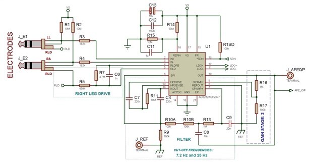

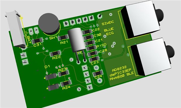

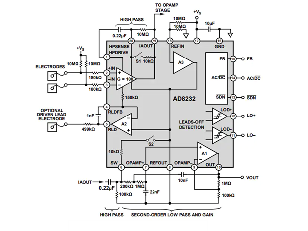

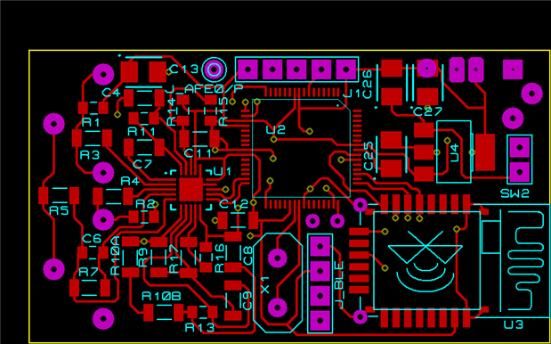

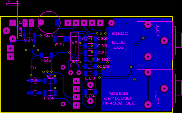

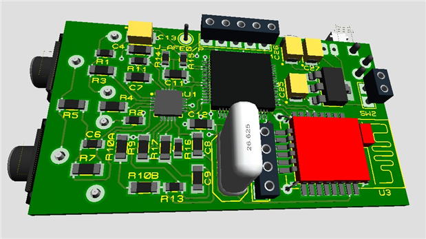

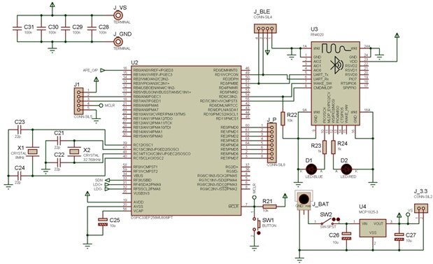

Custom Module :
A custom module is designed with following parameters -
AFE --> AD8232 with 7.2Hz to 25Hz bandwidth.
Gain --> 1100 [inamp = 100, filterout gain = 11]
LEAD configuration --> LEAD 02
Mode --> Three electrode combination [LL - RA with RLD]
RLD --> R7 has been used to limit the loop gain for DC or low frequencies.
Shield --> Electrode cables are shielded with RLD output. Bottom layer of the PCB on the AFE side is copper filled with GND to reduce the noise
MCU --> a dsPIC33EP256 microcontroller is used to process the output signal from the AFE and get the Heart Rate. It also controls the Bluetooth communication.
BLE --> RN4020 from microchip
PCB dimension --> 5.4cm x 3cm double layer
The small form factor will be helpful to mount it on chest comfortably. However, it is not assembled yet.
{gallery} Custom ECG module with BLE
Circuit Diagram: Analog Front End
PCB: TOP layout
PCB: Bottom layout
3D view: TOP
3D view: Bottom

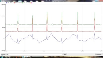

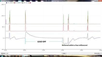

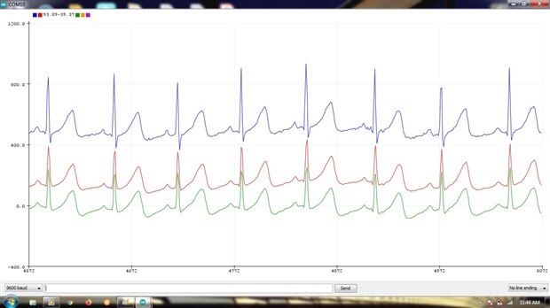

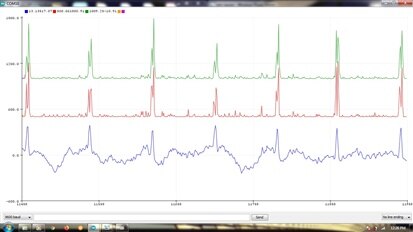

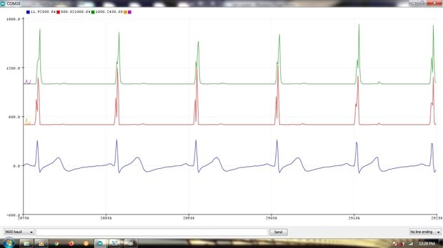

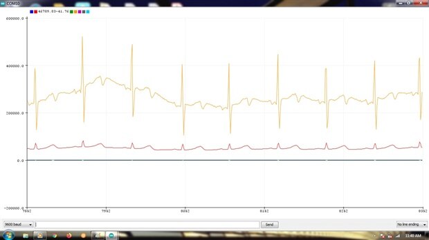

Signal acquisition and QRS complex detection for heart rate calculation:
ECG single LEAD signal was acquired at PIN A0. It showed comparatively clean signal as I have used a Laptop running on battery to provide isolated supply. It reduced the 50 Hz noise. The AD8232 has excellent CMRR and PSRR which removes other noise regarding muscle contraction, electrode potential etc. However, the line noise can still be noticed and some high frequency components were there. I have to remove it and pre-condition the signal for further QRS complex detection to get the Heart Rate. Steps and filters / processes used are mentioned below -
StepsGoalFilter / Process
1Line noise [notch] and low pass filterEwma ADCfilter and KickFiltersRT NOTCH
2Highpass filter to get rid of the DC offsetKickFiltersRT Highpass
3Rectification and amplificationDerivative and Squaring [sq(x)]
4smoothing and integralEwma ADCfilter1 [moving average]
5Peak detectionEwma ADCfilter, V-peak amplitude threshold, millis() for QRS complex beat time threshold

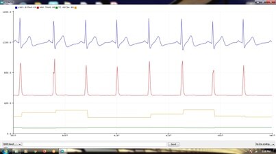

OUTPUT:
Blue plot gives the RAW ECG from A3 analog input. It has a DC offset of 512 [ADC value - mid point of the supply voltage 3.3v]. AD8232 corrects the baseline wander and shifts it at the mid supply voltage. However, it may contain 50Hz line noise and other high frequency noise due to muscle contraction.
Red plot shows signal after 50Hz notch and low pass filter [STEP 1]. The high frequency small components are removed.
The GREEN plot [STEP 2] is the output of the high pass filter where the DC components are removed.
The Red plot gives the output of taking derivatives and squaring function respectively to identify the peaks of QRS complex [STEP 3]. It takes both the negative and positive change and rectifies it using squaring function [moves to positive side]. Thus the Red plot shows double peaks for both the positive and negative slop of the QRS complex. At the same time the small changes are filtered out and the sharp changes / slopes are amplified more to give clear peaks.
The Green plot represents the smoothing integral of the Red plot using a moving average filter [STEP 4]. The double peaks of the Red plot are integrated and the small changes are reduced more which gives clearance to apply amplitude and time threshold to identify the QRS complex certainly

Now, the question is, WHY???
Why so many filters and processing??

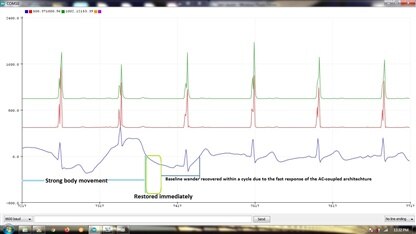

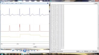

Well.... the following plots gives the answer - We need to detect the HEART BEAT even if we move. I'll be using chest belt to place the electrodes. So, my target is even if I jump a little, I should be able to detect the heart beat clearly. If I apply only amplitude threshold at the very beginning of the RAW ECG signal, I won't be able to detect the heart beat clearly when I move. Following plots show that.
This method is less prone to noise and motion artifacts. Peaks can be detected even when large movements modifies the signal a lot. Below, two plots are showing how this method of beat detection is highly effective. The left one resembles strong arm movement and the right one shows a deflected signal due to jumping. In both cases, this algorithm detects the peaks efficiently.
AD8232 can restore the signal almost immediately after strong movements are stopped. It has a very fast recovery from any LEAD off.
Now, the filtered signal is conditioned enough to apply Amplitude and Time threshold. That's STEP 5.
Generally, QRS complex can have 120 - 140 ms time duration.
The peaks have amplitude of 400 - 500. The previous plots during strong body movements showed that the false peaks can be upto 40 - 60. Therefore, I put 50 as the amplitude threshold.
Now still the higher level noise can produce a fake peak detection. To prevent that I am using the time threshold also. When the beats rises above 50 and comes back to 50 the average time duration between these start and end points can be around 70 - 100 ms in my calculation. Therefore, I put a time threshold of 40 ms. So, even if the noise due to strong body movements produces a fake peak, it will not be considered as a QRS complex if the duration is less than 40 ms. I should give a high limit of the time threshold [like 150 ms], but I found that the low limit if good enough.
Heart Rate calculation:
Time difference between two consecutive QRS complex gives the heart beat rate calculated in beats per minute.
Heart rate = 60000 (milliseconds) / QRS peak time difference in milliseconds
Calculated heart beat rates were pretty stable. The green plot represents the heart beat rate. The orange plot actually represents change of peak value due to the respiration.
