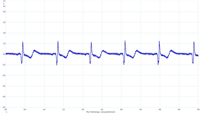

Step - 01:      design of a simple Bio-Amp with filters for single LEAD ECG
For LEAD I configuration, the conventional LEAD arrangement produces an output of about 0.6 Vp-p. The resultant signal has 50 Hz [in my country] component contributed by the body [common mode signal] and the mains ground of the oscilloscope and hence the computer. In real life the 50 Hz component will be less as because the whole system will be driven by battery power supply and there will be less 50 Hz interference in an open playground. However, a digital filter can be implemented in the software end, but we'll lose information [like P wave will be flattened]. It's not a diagnosis purpose ECG and a very few amount of information can be found by only one LEAD. So, considering that the detailed wave shape is not much important here, we can implement digital filter if it's necessary later on.
image image
Above ECG plot is for LEAD1 captured from ARM using clip electrode. For chest arrangement, the electrodes are placed too closed to RLD or the reference of Einthoven's triangle, which results an ECG output with slightly different shape for T wave and comparatively reduced QRS complex. However, the overall peak to peak voltage is increased from 0.6 Vp-p to about 2 Vp-p for chest arrangement.
the output seems to have high 50 Hz component. If we look into the spectrum view -
Step - 02:      compare output of AD8232 ECG module
I have tried to compare the output signal of a single LEAD ECG captured by AD8232, a single chip ECG Bioamp designed by Analog Devices Inc.
Spectrum view shows that 50 Hz noise is added by oscilloscope.
By using an opto-isolator, the 50Hz noise can be eliminated. However, it also inverts the ECG output.
If I compare the output of previous Bio-Amp and AD8232 output -
It shows that the AD8232 is missing detail information in the signal. Like the P-wave is flatten and the whole T-wave is superimposed with the 50Hz noise.
May be that’s because of the filter bandwidth. In my design I had captured in between a range of 0.3Hz to 159Hz where AD8232 limits the low pass far below 50Hz to get rid of common noise. However, this won’t be necessary as it’s not for diagnostic purpose. I just need to get the heart rate with single LEAD ECG, so it’s pretty good enough. Moreover, AD8232 produces a better, sharp QRS complex which will be more helpful.
However, AD8232 responded effectively for removing motion artifacts. For general movement, it maintains the output signal pretty good. But for fast strong movements or contraction of the muscle the signal gets distorted. I have to check it's performance over motion artifacts once again after mounting it on human body.

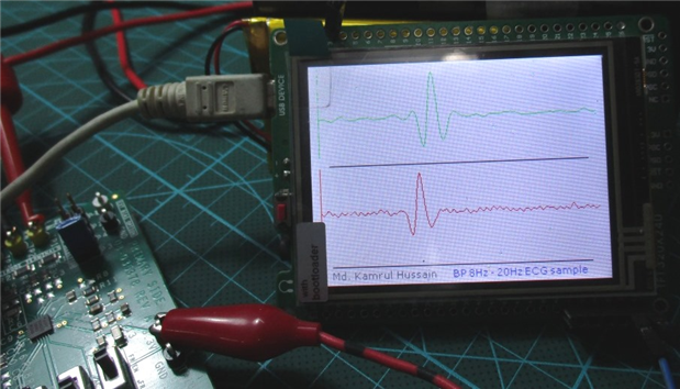

Step - 03:      process the output and apply heart detection algorithm using dsPIC33EP512MU810
For Heart Beat Rate detection from QRS complex of ECG signal, I have used a modified version of the algorithm developed by PAN and TOMPKINS [1985] and further described by HAMILTON and TOMPKINS [1986]. This algorithm has several steps -
  1. Filtering
  2. Slope detection
  3. Moving  Window Integral
  4. Amplitude analysis
  5. Width analysis
Block Diagram -
I have used AD8232 AFE EVAL and MikroMedia dsPIC33EP from Mikroelektronika in this experiment. Later on the dsPIC33EP256MU810 will be used along with RN4020 BLE module to send the data to Arduino NANO 33 IOT through bluetooth low energy.
Output -
Output of the QRS complex detection at different stage of applying Band Pass Filter, taking Derivative, Squaring function, Moving Window Integral and applying threshold are presented below.
{gallery} QRS complex detection
Band Pass Filter: 8-20 Hz 32nd order FIR Bertlett with 366Hz sampling at resting condition
Band Pass Filter: 8-20 Hz 32nd order FIR Bertlett at 366Hz sampling with rapid body movement
Signal conditioning: After taking Derivative, Squaring function and applying Moving Window Integral at resting condition
Signal conditioning: After taking Derivative, Squaring function and applying Moving Window Integral with body movement
Threshold: Applying threshold at half peak point in resting condition
Threshold: Applying threshold at half peak point in body movement

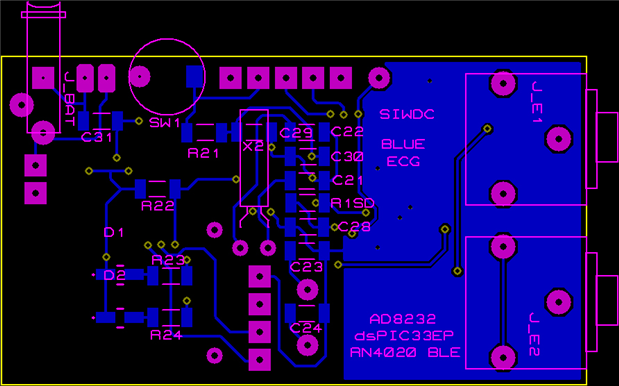

Custom Module :
A custom module is designed with following parameters -
AFE --> AD8232 with 7.2Hz to 25Hz bandwidth.
Gain --> 1100 [inamp = 100, filterout gain = 11]
LEAD configuration --> LEAD 02
Mode --> Three electrode combination [LL - RA with RLD]
RLD --> R7 has been used to limit the loop gain for DC or low frequencies.
Shield --> Electrode cables are shielded with RLD output. Bottom layer of the PCB on the AFE side is copper filled with GND to reduce the noise
MCU --> a dsPIC33EP256 microcontroller is used to process the output signal from the AFE and get the Heart Rate. It also controls the Bluetooth communication.
BLE --> RN4020 from microchip
PCB dimension --> 5.4cm x 3cm double layer
The small form factor will be helpful to mount it on chest comfortably. However, it is not assembled yet.
{gallery} Custom ECG module with BLE
Circuit Diagram: Analog Front End
PCB: TOP layout
PCB: Bottom layout
3D view: TOP
3D view: Bottom
