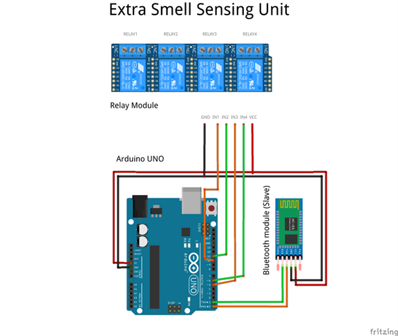

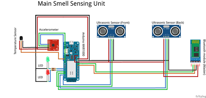

Circuit Diagram
     Below is the circuit connection diagram for the integrated 'Smart WheelChair' part of my project. This comprises of the main and extra smell sensing units. For a more detailed explanation on the hardware part of the Smart WheelChair, visit this link - Cue System for Anosmia and Smart WheelChair #7 - Hardware Explained and Case That blog also includes gas sensors which will be used for 'Cue System for Anosmia' part of my project. So ignore the gas sensors alone, rest of the hardware is for 'Smart WheelChair'.

 * Hardware components Required (Main Unit)
 * 1. Arduino MKR1000 board
 * 2. TMP36 temperature sensor
 * 3. HC-SR04 Ultrasonic Sensors - x2
 * 4. Accelerometer ADXL335Z Evaluation Board (any ADXL XXX should work)
 * 5. LEDs (Green/ Red) - x2
 * 6. Bluetooth module
 * 7. ProtoShield/ Breadboard and Few Jumper wires
 * Connections
 * Arduino MKR1000  |   TMP36 Temperature Sensor
 *      3.3V        |         +Vs
 *      Gnd         |         Gnd
 *      A1          |         Vout
 * Arduino MKR1000  |   Ultrasonic Sensor
 *      5V          |         Vcc
 *      Gnd         |         Gnd
 *      D2/3        |         Echo
 *      D5/4        |         Trig
 * Arduino MKR1000  |   ADXL335Z Evaluation Board
 *      VCC(3.3V)   |         VSS
 *      Gnd         |         Gnd
 *      A2          |         Y
 *      A3          |         X
 * Arduino MKR1000  |   LED (Green/ Red)
 *      D0          |   Positive of Green LED
 *      D1          |   Positive of Red LED
 *      Gnd         |   Negative of both the LEDs

void sendSMS(){
  Serial.println("\nStarting connection to server...");
  /*If you get a connection, report back via serial:*/
  if (client.connect(server, 80)) {
    Serial.println("connected to server");
    /*Make a HTTP request:
    Find instructions to obtain the below value here - https://www.element14.com/community/community/design-challenges/designforacause/blog/2018/08/16/cue-system-for-anosmia-and-smart-wheelchair-5-fall-and-collision-detection#jive_content_id_Obtaining_the_Webhook_URL_to_trigger_an_event_from_Arduino_MKR1000  */
    client.println("GET /trigger/{YOUR_IFTTT_EVENT_NAME}/with/key/{YOUR_IFTTT_KEY} HTTP/1.1");
    client.println("Host: maker.ifttt.com");
    client.println("Connection: close");
    client.println();
    digitalWrite(statusLED, HIGH);
  int reqReceived = 1;
  while(reqReceived){
    while (client.available()) {
      char c = client.read();
      Serial.write(c);
      reqReceived = 0;
    /*If the server's disconnected, stop the client:*/
    if (!client.connected()) {
      Serial.println();
      Serial.println("disconnecting from server.");
      client.stop();
      digitalWrite(statusLED, LOW);
void changeRelayState(){
  if(relayState == 1)
    Serial1.print(1);
  else if (relayState == 2){
    Serial1.print(2);
  else if(relayState == 3)
    Serial1.print(3);
  else if (relayState == 4){
    Serial1.print(4);
  else  if(relayState == 5)
    Serial1.print(5);
  else if (relayState == 6){
    Serial1.print(6);
Arduino UNO Extra Unit (Slave) Code:
/* This is the code for the 'Home Appliance Control' section of the Smart WheelChair deisgned for the Element14 Community's 'Design for a Cause' design challenge,
 *  sponsored by Arduino. In particular, this is for the extra smell sensing unit with Bluetooth Slave Arduino UNO.
 * Design Challenge Page - https://www.element14.com/community/community/design-challenges/designforacause/blog
 * Blog Link -
 * Author : Dixon Selvan
 * Date   : September 04, 2018
 * Project: Cue system for Anosmia and Smart WheelChair
 * Website:
 * 1. Arduino UNO board
 * 2. Four Channel Relay Module
 * 3. Bluetooth module
 * 4. ProtoShield/ Breadboard and Few Jumper wires
 * Connections
 * Arduino UNO      |   Relay Module
 *      5V          |         VCC
 *      Gnd         |         Gnd
 *      IN1         |         D10
 *      IN2         |         D11
 *      IN3         |         D5
 *      IN4         |         D6
 * Arduino UNO      |   Bluetooth Module
 *      5V          |         +5V
 *      Gnd         |         Gnd
 *      RX          |         RX
 *      TX          |         TX
int Relay1 = 10;
int Relay2 = 11;
int Relay3 = 5;
int Relay4 = 6;
int serialData = 0;
void setup() {
  // put your setup code here, to run once:
  pinMode(Relay1, OUTPUT);
  pinMode(Relay2, OUTPUT);
  pinMode(Relay3, OUTPUT);
  pinMode(Relay4, OUTPUT);
  Serial.begin(38400);
  digitalWrite(Relay1, HIGH);
  digitalWrite(Relay2, HIGH);
  digitalWrite(Relay3, HIGH);
  digitalWrite(Relay4, HIGH);
void loop() {
  // put your main code here, to run repeatedly:
  if(Serial.available()>0){
     serialData = Serial.read();
     Serial.println(serialData);
     if (serialData == 49){
      digitalWrite(Relay1, LOW);
     else if (serialData == 50){
     else if (serialData == 51){
      digitalWrite(Relay2, LOW);
     else if (serialData == 52){
     else if (serialData == 53){
      digitalWrite(Relay3, LOW);
     else if (serialData == 54){
     else if (serialData == 55){
      digitalWrite(Relay4, LOW);
     else if (serialData == 56){
Hurdle
     The main hurdle I faced is in 'Serial Communication'. The Arduino MKR1000 uses Serial1 (14 - TX,13 - RX digital pins) for serial communication but the Arduino UNO uses Serial (1 - TX,0 - RX digital pins) for serial communication. So while programming Arduino MKR1000 you have to use Serial1 for initialization and for further use in the code. I usually test the setup with Arduino UNO and then migrate them to other dev boards. So the entire hardware setup is working in UNO but not in MKR1000. Since I had faced the same issue in my previous project Traffic Predictor, I was able to realize the mistake faster.
