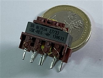

Model 063xxx and 093830 Series SP-E16/5 Flyback Transformers are based on a standard E 16/4,7 power ferrite core with a high clearance, high creepage distance coil construction designed for various silicon controller families. The Model 063xxx Transformer Series is capable of transferring up to 9 watts and is optimized for a working frequency of 132 kHz.
image  imageimage

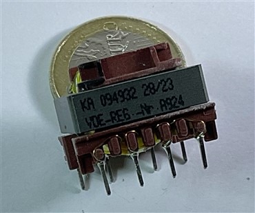

Model 0949xx Series SP-E 20/6 Flyback Transformers are based on a standard E20/6 power ferrite core shape with a high clearance and high creepage distance coil construction designed for various silicon controller families. These transformers are capable of transferring up to 22 watts and are optimized for a working frequency of 132 kHz.
image  imageimage

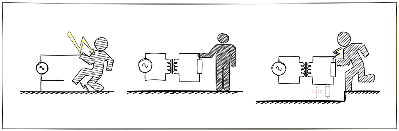

Flyback transformers provide galvanic isolation. Galvanic isolation is a technique that provides electrical separation between circuits or systems to enhance safety, prevent ground loops, and protect electronic components from electrical hazards.
Electrical risks without and with galvanic isolation.
International safety standards are constantly changing and it is difficult to stay up to date with them if you are not a specialist in safety standards. I have tried to make a small summary of the standards under which this Bourns components are been designed. Safety is super important, and we're talking about things like fire risks and electric shocks here. It's a good idea to really dig into all the certifications these components have earned to make sure they're up to snuff in protecting against these kinds of hazards.

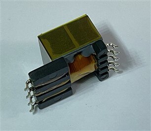

Push-pull transformers, such as the Bourns HCTSM8 series, are widely employed in push-pull DC/DC converter setups. While flyback converters effectively handle a broad range of input voltages, they often present electromagnetic interference (EMI) issues and generally necessitate intricate closed-loop control systems for stable operation. In contrast, a push-pull transformer operates more straightforwardly in an open-loop configuration. Schematic source: SN6501-Q1 Transformer Driver for Isolated Power Supplies
HCTSM8 Series - High Clearance and Creepage Distance Transformers   image image
HCTSM8 Series Transformer & Typical Application

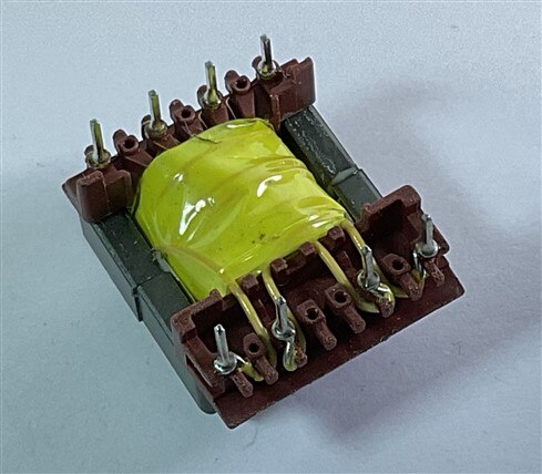

Identifying transformer wirings and polarities

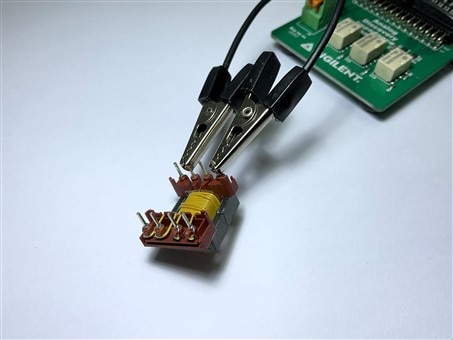

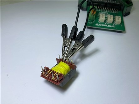

To figure out the different components of a transformer we can use a Digital Multimeter (DMM), start by turning on the DMM and checking out the pairs of wires on the transformer. Measure the resistance of each pair by touching the DMM probes to the wires, noting the readings.
Bourns 094932 SMPS Flyback Transformerimage

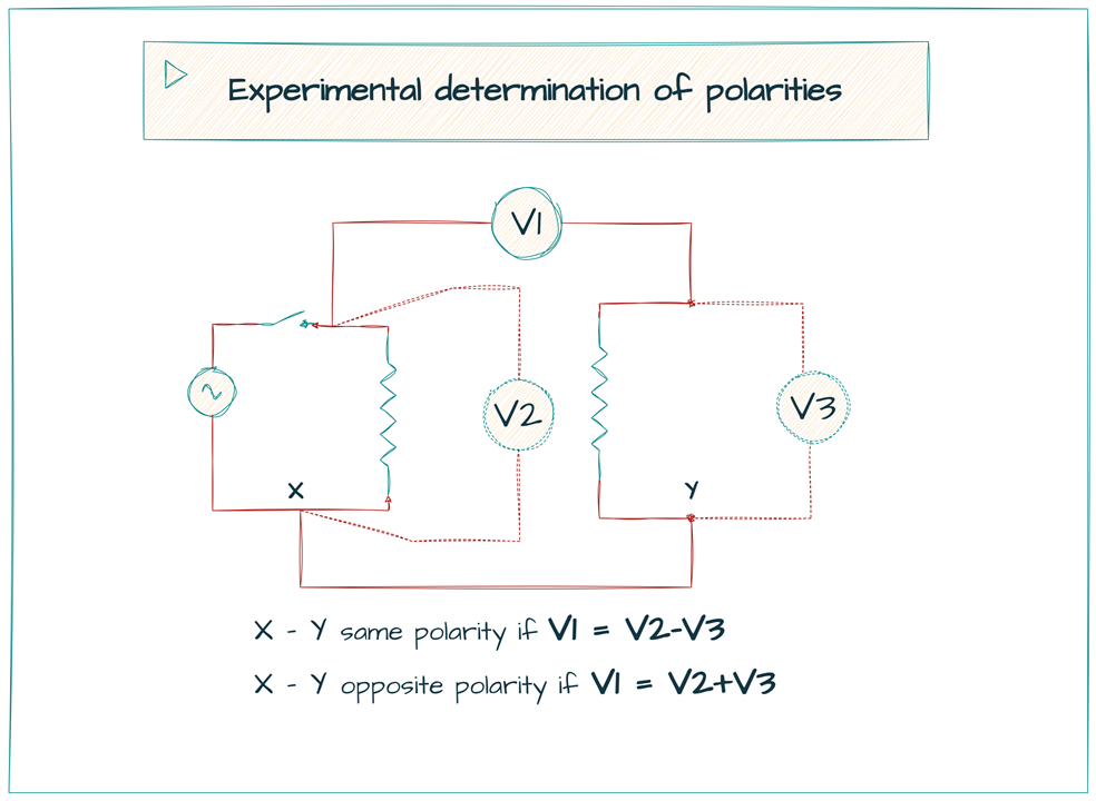

For determining the polarity of the windings, we can perform a polarizing test by applying a small AC voltage (using a low-voltage AC power source) to one winding and observing the direction of current flow in the other windings. We can obtain the direction of current through several voltmeter measurements as in the diagram shown below:
Experimental determination of polarities diagram
If we have a two-channel oscilloscope and a signal generator it would be much easier. Fortunately, Digilent's Analog Discovery 2 provides us with an all-in-one. Same polarity vs opposite polarity with an oscilloscope. Sine wave 100 kHz applied to the primary:
image image
Identifying wiring polarities for the Bourns 094932 SMPS Flyback Transformer

Outputs for the Bourns 063932 SP-E 16/5 Flyback Transformer. Examining the response of impedances to frequency.
In series, the SRF is approximately half that of the parallel configuration due to the increased inductance.
Amplitude 0.1V, Resistor 10Ω Frequency 100 kHz
WIII 5-8 WIV 6-7 Series Parallel
Ls Series Inductance  12.4349263 uH 12.4234684 uH 48.9916305 uH 12.3645565 uH
|Z| Impedance 7.81443603 Ω 7.80734698 Ω 30.7846309 Ω 7.769542 Ω
Rs Series Resistance  144.785743 mΩ 150.546082 mΩ 374.79241 mΩ 101.422428 mΩ
Xs Series Reactance 7.81309462 Ω 7.80589539 Ω 30.7823493 Ω 7.76888 Ω
∠ Input Phase 37.6081431 ° 37.5668892 ° 71.3883966 ° 37.5695579 °
θ Phase 88.938364 ° 88.8951189 ° 89.3024261 ° 89.2520483 °
D Dissipation 0.018531165 0.019286203 0.012175562 0.013054961
Q Quality  53.9631488 51.8505381 82.1317307 76.5992308
Let's check if If the inductance of the series configuration is four times that of the parallel configuration when two coils with equal turns are wound on the same core.
Inductance Relation: series vs parallel configuration inductances
48.9916305 uH / 12.3645565 uH = 3.94
≈ x4
(series inductance is four times that of the parallel configuration)

Examining Model 063932 SP-E 16/5 Flyback Transformer
063932 SP-E 16/5 Flyback Transformer: Buy Now
Bourns SMPS Flyback Transformer, 250 mA, 44khz to 132khz, 6 W, 85v at 265v
Model 063932 SP-E 16/5 Flyback Transformer  image
imageimageimage  image  image
WI 1 4-1 WI-WII 4-2 WII 1-2 WIII 5-8 WIV 6-7
Ls Series Inductance  1.45310055 mH 3.78585954 mH 523.994067 uH 14.9685025 uH 14.8770987 uH
|Z| Impedance 914.405684 Ω 2.37891466 kΩ 329.251215 Ω 9.40634805 Ω 9.34820614 Ω
Rs Series Resistance  50.5023702 Ω 29.9829335 Ω 3.24920372 Ω -159.979268512 mΩ 110.180558 mΩ
Xs Series Reactance 913.010003 Ω 2.3787257 kΩ 329.235183 Ω 9.40498752 Ω 9.34755681 Ω
∠ Input Phase 86.2242024 ° 87.0269224 ° 72.7314015 ° 5.38304654 ° 42.7630041 °
θ Phase 86.8339592 ° 89.2778467 ° 89.4345695 ° 90.9745099 ° 89.3246804 °
D Dissipation 0.055314148 0.01260462 0.009868944 0.017010046 0.011787097
Q Quality  18.0785575 79.3359897 101.327959 58.7887894 84.8385318
Frequency response of the individual wirings:
Examining Model 094932 SP-E 20/6 Flyback Transformer
Model 094932 SP-E 20/6 Flyback Transformer: Buy Now
0Bourns 94932 SP-E 20-6 Flyback Transformer.jpgimage
imageimageBourns 094932 SMPS Flyback Transformer  Bourns 094932 SMPS Flyback Transformer
Amplitude 0.1V, Resistor 10Ω Frequency 132 kHz
WI 1 5-3 WII 1-7 WIII 8-10 WIV 13-15
Ls Series Inductance  829.661863 uH 15.0554441 uH 15.2006369 uH 5.69572509 uH
|Z| Impedance 688.746087 Ω 12.4885068 Ω 12.6077117 Ω 4.72459588 Ω
Rs Series Resistance  29.7021179 Ω 212.948263 mΩ 123.043942 mΩ 79.7294894 mΩ
Xs Series Reactance 688.105338 Ω 12.4866912 Ω 12.6071113 Ω 4.7239231 Ω
∠ Input Phase 86.7182489 ° 50.7327174 ° 51.2496131 ° 25.1144299 °
θ Phase 87.5283577 ° 89.0229714 ° 89.4408176 ° 89.0330644 °
D Dissipation 0.043165074 0.017054019 0.009759884 0.016877813
Q Quality  23.1668778 58.637206 102.460235 59.2493836
Examining BA60951CS – Flyback Transformer
BA60951CS – Flyback Transformer Buy Now
FEATURES: Isolated flyback transformer, Designed for isolated power supplies operating at 120kHz, 800V working voltage, Basic insulation, 2.25W of output power
APPLICATIONS: Electric vehicles requiring high isolation voltage, Battery management systems, Flyback controller ICs,SPECIFICATIONS 25µH at 250kHz/0.1V primary inductors, 8mm minimum creepage distance, -40°C to +155°C operating temperature range
Bourns BA60951CS – Flyback Transformerimage
imageimageBourns BA60951CS Flyback Transformer  Bourns BA60951CS Flyback Transformer
Amplitude 0.1V, Resistor 10Ω Frequency 250 kHz
Primary 1-2 AUX1 1-4 Secondary 6-8
Ls Series Inductance  26.0613937 uH 16.3672187 uH 43.7414393 uH
|Z| Impedance 40.9427379 Ω 25.7238413 Ω 68.7185145 Ω
Rs Series Resistance  676.93365 mΩ 856.842683 mΩ 1.1499414 Ω
Xs Series Reactance 40.9371414 Ω 25.709567 Ω 68.7088922 Ω
∠ Input Phase 75.4186898 ° 67.1397423 ° 80.8203976 °
θ Phase 89.0526474 ° 88.0911656 ° 89.0411629 °
D Dissipation 0.016535929 0.033327776 0.016736428
Q Quality  60.474378 30.0050026 59.7499076
