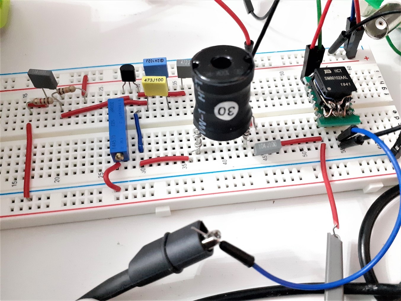

Experimenting with Magnetics Components (year 2021)
On the Experimenting with Magnetics Components with Bourns I decided to learn about magnetic components by developing an application that interested me quite a bit, the discrimination of coins using their magnetic properties. The design led me to experiment on the magnetic properties of coins, on Eddy currents, on magnetic insulation and magnetic flux losses. I learned how to make oscillators with magnetic components, used EMI filters and pulse transformers to galvanically isolate two stages of the circuit. It was a fascinating learning journey of which I have very fond memories.
Image from my participation in the 2021 Experimenting with Magnetics Components Competition: Smart Coin Sorter by Inductive Sensing

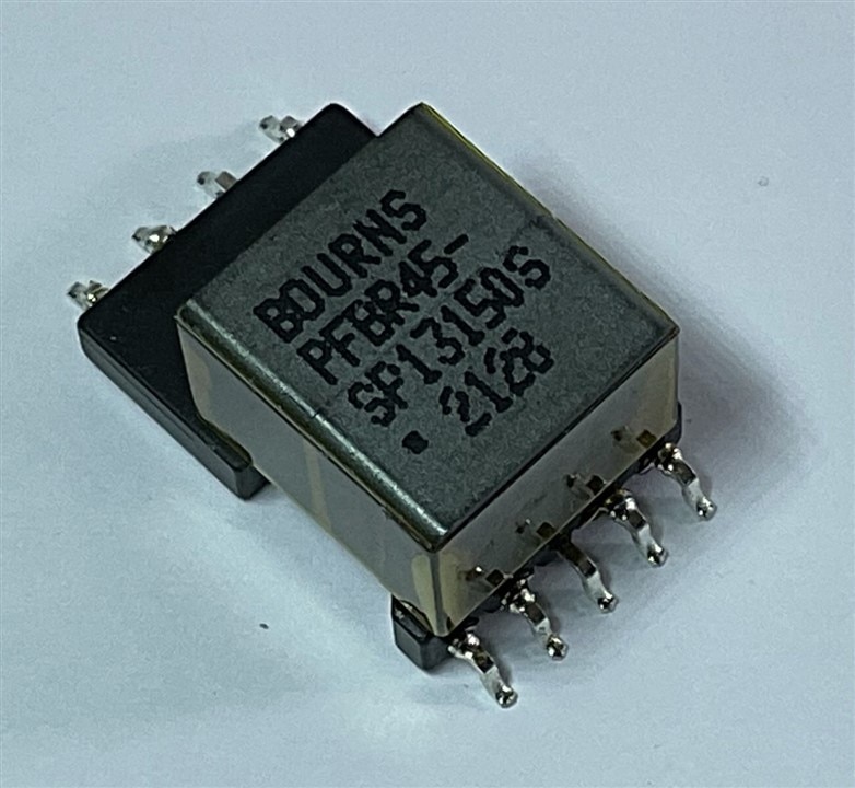

What is a PLC transformer?
Power line communication (PLC) carries data on the power line. PLC transformers are designed for detection and transmission of wideband low voltage differential data and communication signals (LVDS). The PLC transformer provides galvanic isolation between the PLC modem and the power line, helping separate the PLC from the AC mains. A key characteristic of these transformers is their minimal insertion loss, which reduces signal distortion and attenuation.
Bourns PLC Transformer PFBR45-SP13150SBourns PLC Transformer PFBR45-SP13150S

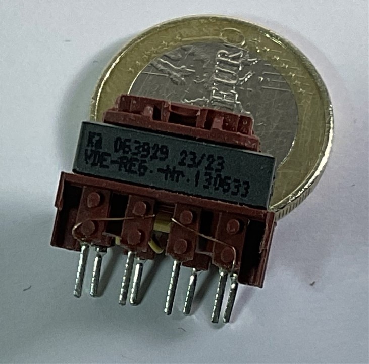

What is a SMPS Flyback transformer?
A flyback transformer is actually a coupled inductor with a gapped core. Flyback transformers are used to provide voltage transformation and circuit isolation in Flyback converters. During each cycle, when the input voltage is applied to the primary winding, most of the energy is stored in the core gap. It is then transferred to the secondary winding to provide power to the load.
Bourns 063929 Flyback Transformer Bourns 063929 Flyback Transformer
