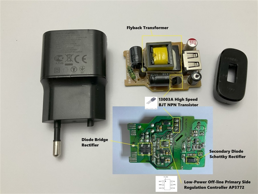

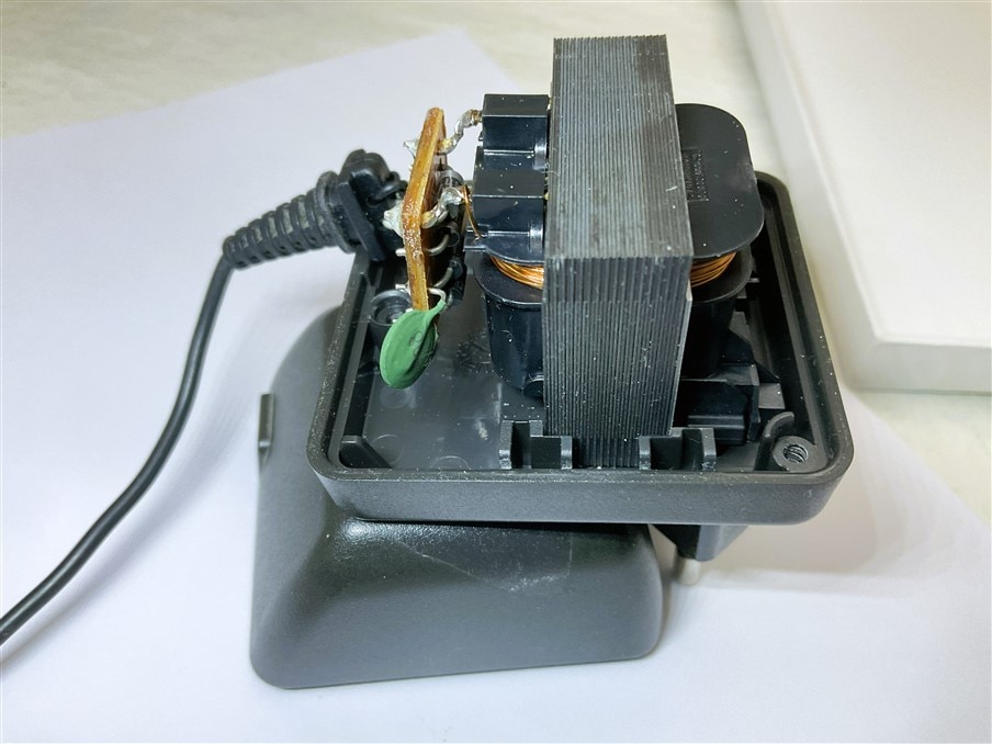

Let's see what's inside two small mobile chargers. The following two images show us two generations of mobile chargers. The image on the left is of a mobile charger for an old Nokia 3110 and the charger on the right corresponds to a somewhat more modern LG brand mobile charger.
Unregulated Nokia Power SupplySmall LG Mobile Phone Charger Power Supply
Unregulated Nokia Power Supply and Small LG Mobile Phone Charger Power Supply
The Nokia charger was a small unregulated linear power supply. It simply consisted of a linear transformer and rectifier circuit plus overcurrent protection.
The charger on the right is a small, light and compact charger that uses the switched mode power supply topology. Switching is performed using a regulator IC that generates a pulse width modulated (PWM) signal that controls the closing and opening of a power transistor acting as a switch.
The linear transformer is a large, heavy transformer with a laminated iron core in contrast to the lighter and small flyback transformer on the right which contains a ferrite core.
The Nokia linear charger is only suitable for 220 VAC line voltages while the transformer on the right is suitable for both 110 VAC and 220 VAC voltages without any modification, the regulator is responsible for guaranteeing the output voltage.

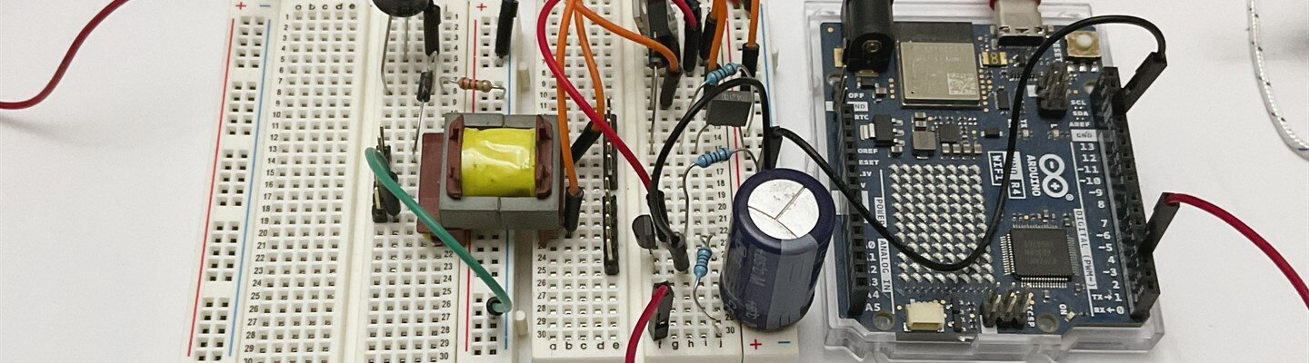

In the next image it is our experimental unregulated flyback switched mode converter surrounded by several comercial switched mode power supplies from abandoned printers, scanners, mobile chargers and PC power supplies. Switching power supplies are totally ubiquitous, they are in many electronic devices.

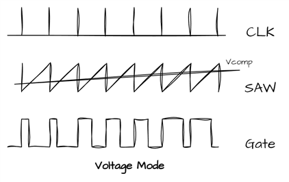

Regulation in flyback converters

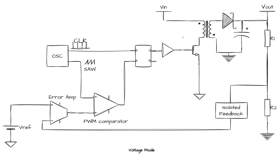

There are a couple of ways to go about it. You can use traditional PWM (Pulse-Width Modulation), either in voltage mode or current mode, where a free-running oscillator takes charge and controls the show. On the flip side, there are more budget-friendly designs where the transformer itself plays a role in a blocking oscillator. This setup helps save on a few components, making the design more cost-effective.
Voltage Mode PWM:
In voltage mode, we compare the integrated error signal (Verr = Vref − FB) with the oscillator's sawtooth waveform. What this means is that we're looking at the difference between a reference voltage (Vref) and the feedback voltage (FB). This helps us figure out how much adjustment is needed. Then, we compare this with a sawtooth waveform generated internally. This comparison helps control how long the switch stays ON.

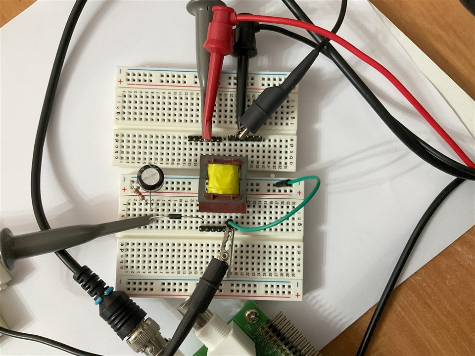

Experiment 1: Working as a linear power transformer
Once I selected the transformer to be martyred, the first thing I worry about is learning to identify the different windings of the transformer. I didn't want to have surprises and find voltages higher than expected. So the first thing I tried is to work with the transformer as a linear power transformer with two of the windings chosen for the rest of the experiments. The BIAS winding and one of the two secondaries.
First problem: The pin spacing of this transformer is not suitable for working on a breadboard, I understand that for safety reasons. To be able to work with a breadboard environment, I used two breadboards, one without one of the power strips. In such a way that the inputs and outputs of the primary windings of the transformer rest on a breadboard different from the breadboard where the inputs and outputs of the secondary windings rest.
There is a good separation between both breadboards.
For this first experiment I used the wave generator and the oscilloscopes of the Digilent Analog Discovery 2, always with small signals and low currents.
Response to sinusoidal wave:
Using the wave generator I applied a 100 kHz 1V signal to the BIAS winding
We can try to calculate the turns ratio between the two windings using the Peak2Peak measurements
443.31 / 162.65 = 2.72 That's very close to the 2.75 indicated on the data sheet.
In the graph we can also see that the chosen polarities of the two windings are in phase and coincide with the references chosen with the two probes of the two-channel oscilloscope.
With this small experiment we have been able to check the turns ratio of the two windings, identify our primary and secondary for the rest of the experiments and the polarities of both windings.

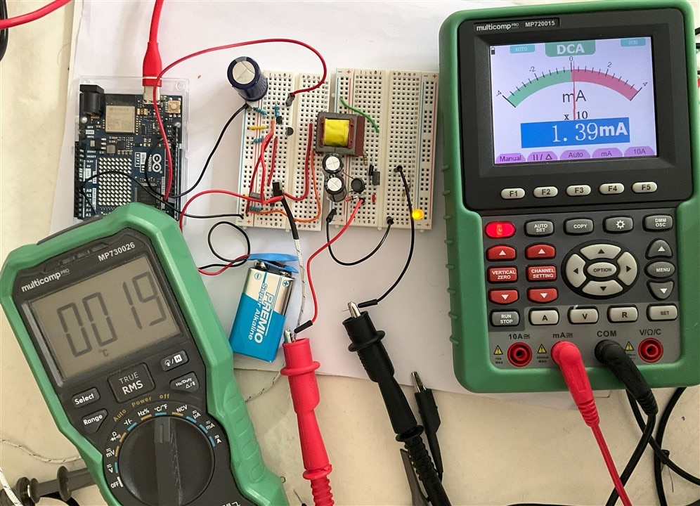

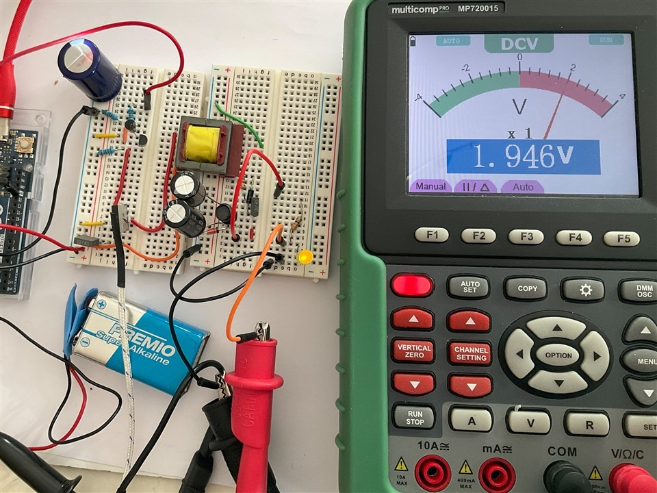

Experiment 3: Pulse response, secondary rectifier diode and capacitor
For this experiment I connected a 1N5819 Schotty fast switching diode to the secondary of the transformer and a 470 uF electrolytic  capacitor.
We are getting closer to the typical configuration of a flyback DC/DC converter.
The load is a 2K2 resistor. For these experiments I had to increase the amplitude of the pulses so that the diode could switch to conduction in the off phases of the switch.
I tried different pulses of different widths at a frequency of 100 kHz.
We already have a DC output at the output of this simple converter.
In the video you can see the response while changing the pulse width, with a limit of 50% duty cycle.

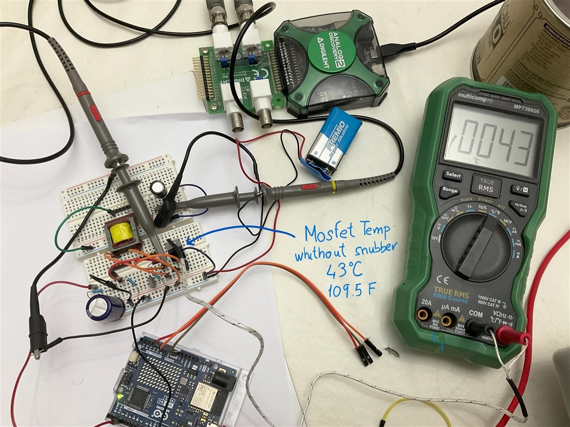

Experiment 8: 1st Don't Try This. Flyback converter without primary snubber.
Excited by the previous results, I decided to optimize ahead of time without taking into account that I could destroy the transformer due to carelessness or an unexpected software error.
First I carried out tests without the snubber RCD network, I wanted to see those voltage peaks that I had read so much about, I was not worried about losing this MOSFET since I have several more and science was the most important thing at that time. Fortunately nothing broke.
Everything seemed to be going correctly. In the image the PWM signal of the Arduino and the output of our unregulated source outputing 2.6 VDC
By zooming in on both signals we can see a small resonance in the output signal.
But when I went to analyze the voltage on the MOSFET Drain terminal I got a little scared. There was no attenuation on the probe and there were 30 volt spikes. Everything in red, bad symptom.
Vds over the range limits for x1
By attenuating the signal with the probe in position x10 I was able to observe the reasons for the snubber network in the primary.
x10 Attenuation. VDrain
At different duty cycles it went even worse: 5% 15% 20% PWM Duty cycle. 45 VDC
The MOSFET started to heat up. 43 °C The temperature in the room was 6 °C with the windows open.

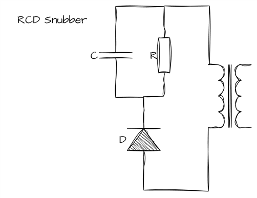

Experiment 9: 2nd Don't Try This. Flyback converter with primary snubber.
Ideally, when the MOSFET turns OFF in the flyback converter, all the current from the primary side should smoothly transfer to the secondary side, and everything would be fine. But, in the real world as we have seen in the previous experiments there's a hitch. The incomplete connection between the primary and secondary sides creates what it is called "leakage inductance." This leads to a bit of an issue: a positive voltage spike at the switch, even though the secondary side is under control. Not ideal. To fix this, we can use something called a snubber network. This could be a simple RC (resistor-capacitor) combination across the winding, or, for a more effective solution, a "DRC" network involving a diode in series with a parallel RC. This helps to keep things smooth and prevent unwanted voltage spikes.
I did tests both with a snubber circuit in the primary and without it to check the voltage spikes and their mitigation by the snubber network.

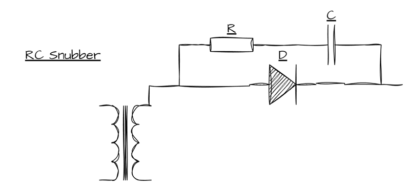

RC Snubber for the secondary diode
This is the circuit I used to check the effects of the primary snubber network. Again the warning that this circuit could damage the primary of the transformer by having the MOSFET on when the PWM signal is not present.
The snubber network consists of a fast rectifier diode and a parallel RC circuit in series with the diode.
The snubber circuit really worked.
This is the voltage on the mosfet drain over time for various duty cycles of the pwm signal.
The temperature in the MOSFET dropped to 22 degrees with the room at 16 C.
Vout for different duty cycles
Comparing Vds with the primary RCD snubber and without it. The snubber circuit is doing its job. I have to learn how to improve these results in a more scientific way and not in a totally experimental way.

Voltage supported by the diode: 1.946 V
Input Current: Current measured at the positive connector of the 9V battery, 36.42 mA
Load current: A small 38 Ohm resistor is limiting the current through the diode.
The temperature of the MOSFET is 19 C, the same ambient temperature, very far from the 43 C that was reached without the snubber network of the transformer primary.
