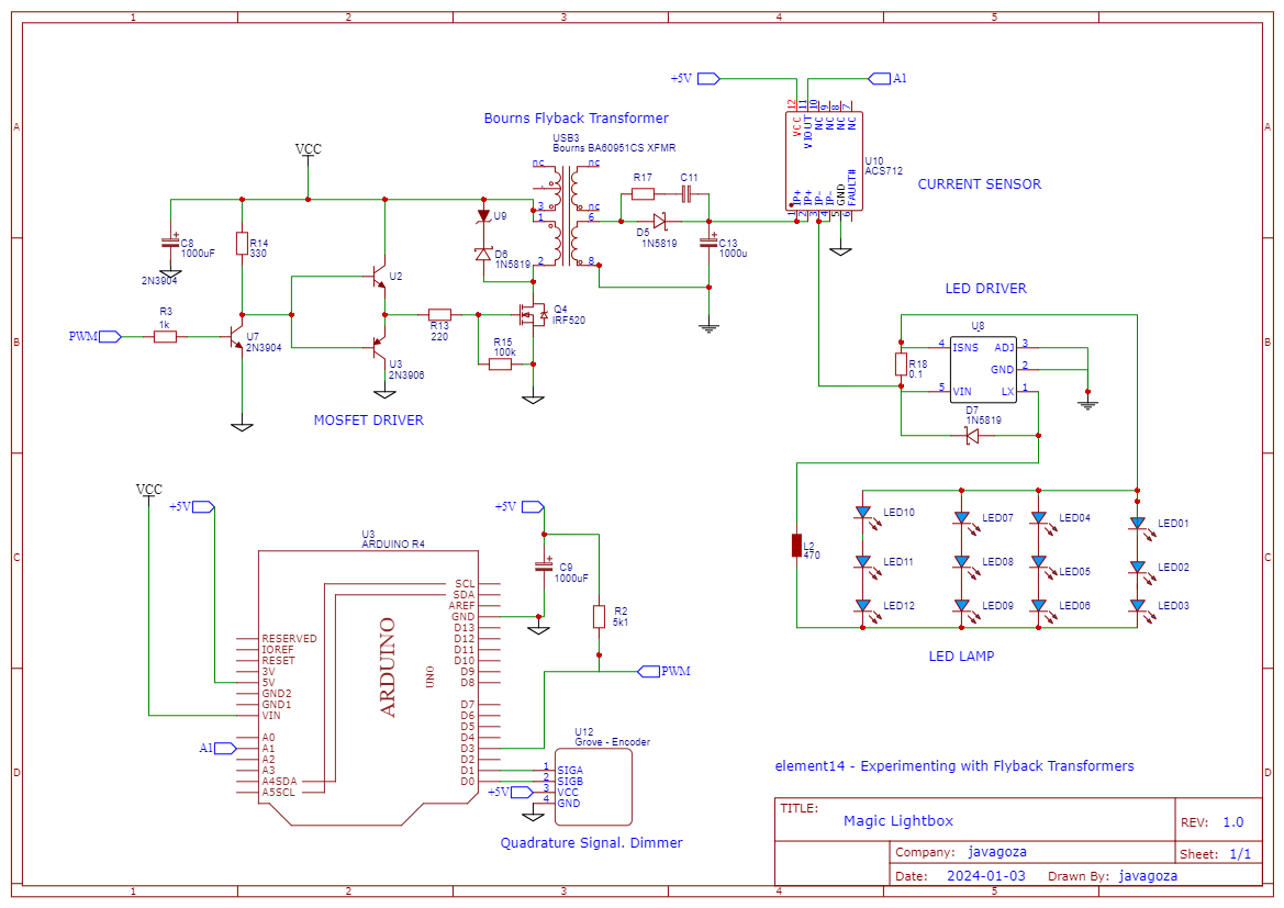

System overview
The system integrates a PID controller for closed-loop regulation, adjusting Proportional, Integral, and Derivative actions based on the difference between actual and desired states. A Pulse Width Modulation (PWM) controller modifies the duty cycle, regulating energy storage in the Flyback transformer. The Flyback converter provides DC to DC conversion with galvanic isolation, transferring energy from the primary coil to the load through an output capacitor acting as an energy pump. A current probe facilitates non-intrusive current measurement, converting it for analog to digital. The Computer Vision Controller analyzes image contrast, proposing a target current for the PID controller, while a camera captures light, converting it into an electrical signal for digital image processing.
Magic Lightbox High Level Circuit Diagram
The project has focused on the device that controls the LED panel with automatic dimming. This part of the system utilizes a flyback transformer from the received kit and has allowed me to experiment with this type of transformers. The rest of the system is presented as a justification for the project but has not yet been fully developed.

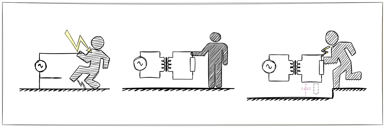

imageElectrical risks without and with galvanic isolation.

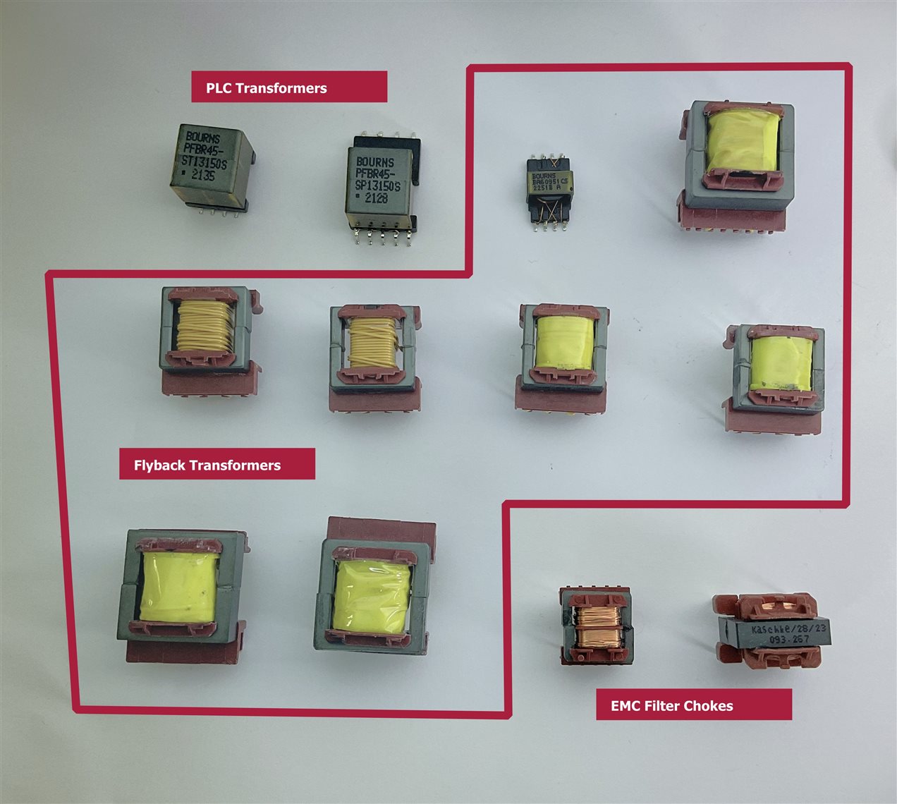

In the kit I received, all flyback transformers, except one, were configured to operate with primary voltages ranging from 110 to 220 VAC. Given that my country operates on a 220 V system, prioritizing safety over risk, I opted to work with lower voltages. Since there was only one transformer specifically designed for low-voltage applications, and I aimed to reserve it for the final project, I delved into the realm of creative transformer use to continue my learning journey through experimentation.
A dedicated blog was devoted to exploring transformers, experimenting with various types from the kit, and uncovering insights into their versatile applications.

In the course of my exploration, I gained the knowledge to differentiate Flyback Transformers from their linear counterparts. Unlike linear transformers, Flyback Transformers exhibit a unique energy storage and release mechanism, making them particularly suitable for applications requiring efficient energy transfer, such as in switched-mode power supplies (SMPS).
The image captures the distinction between linear transformers, sourced from old power supplies in radios and sound amplifiers, and Flyback Transformers. Noteworthy differences include the size contrast and the unique design of the Flyback Transformers. Unlike linear transformers with laminated iron cores, Flyback Transformers feature cores made of ferrite, concealing a secret gap or airspace within or at the ends of the core arms.
Linear vs Flyback Transformers
A flyback transformer is a component with primary and secondary windings wound around a core. Unlike traditional transformers, flybacks intentionally include an air gap in the magnetic circuit. This gap alters how energy is stored and released, impacting efficiency. While regular transformers aim for instantaneous energy transfer, flybacks store energy in the core before releasing it.
In a typical flyback transformer, a switch (often a power transistor) connects to the primary winding. When the switch is on, the magnetic field gradually builds up in the core. A diode in the secondary part prevents current flow during this stage. When the switch turns off, the primary current is cut, causing a change in voltage polarity on the secondary winding, releasing current in the circuit. Adding a bypass capacitor after the secondary winding helps smooth out ripples from the fast transistor switching.

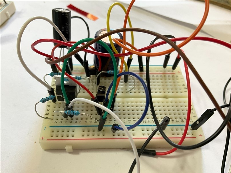

Using BJT transistors to drive the MOSFET from the microcontroller
After discarding the optocoupler option, I considered building a driver circuit using two NPN BJT transistors, two 2N5551 transistors. The chosen frequency for the experiments was 100 kHz, requiring a MOSFET balancing low gate charges, low on-resistance (RDS(on)), and high efficiency.
The IRF530 Power MOSFET was selected thinking it was suitable for the experiments. Later on, I replaced the IRF530 MOSFET with an IRF520 after encountering switching time issues with the former.

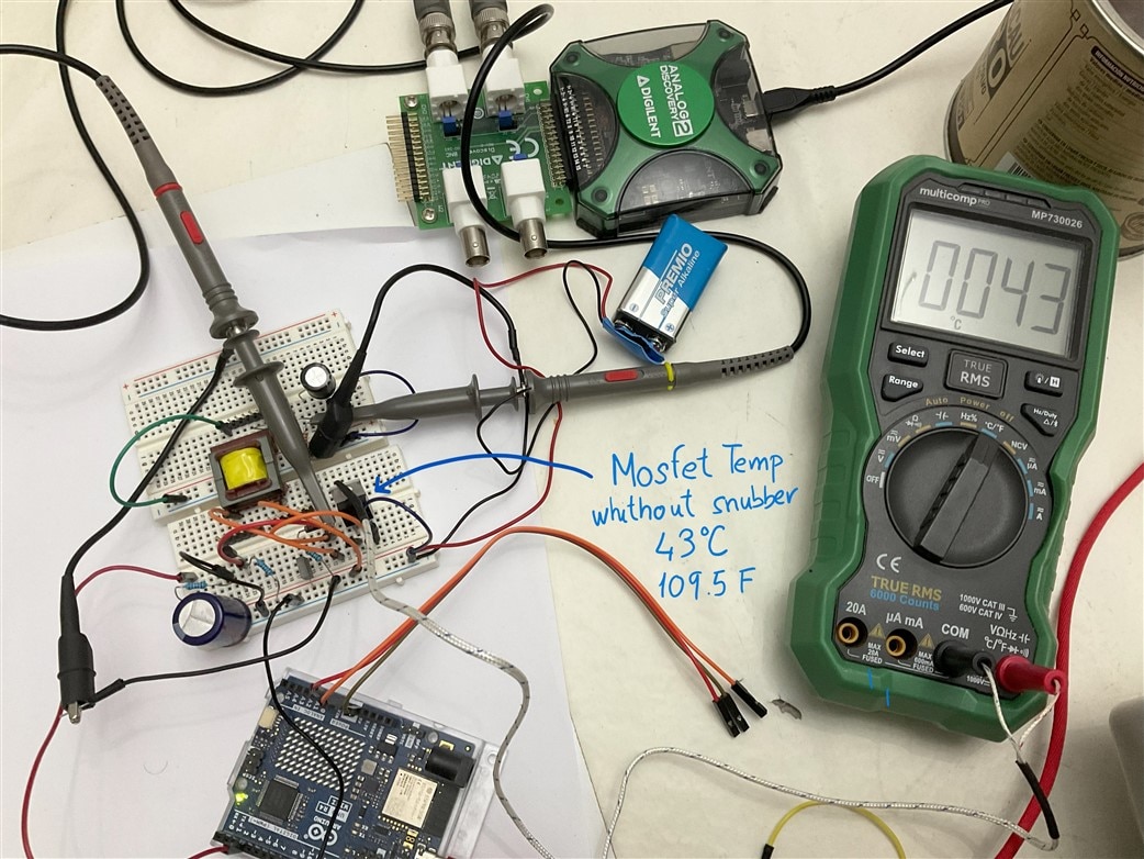

Having successfully generated the PWM signal from the Arduino microcontroller and designed an initial driver for the MOSFET gate, I built a simple Flyback DC/DC converter circuit on a breadboard. It was exciting to witness my first converter in action.
At first, I was a bit terrified. I had the oscilloscope probe without attenuation, and all the measurements turned red. After setting the probe attenuation to x10, everything became clear – there were peaks of 41 volts, even though I was working with a battery that provided only 7.5V
Additionally, something was not right. The MOSFET started to heat up, reaching 43 °C, despite the room temperature being 6 °C with the windows open.

Redesigning the Arduino Shield Circuit
This the electronic circuit governing the automatic dimmable LED panel. In the initial tests of the shield, protections for the MOSFET and secondary diode were omitted. This revision incorporates them for the final prototype.
