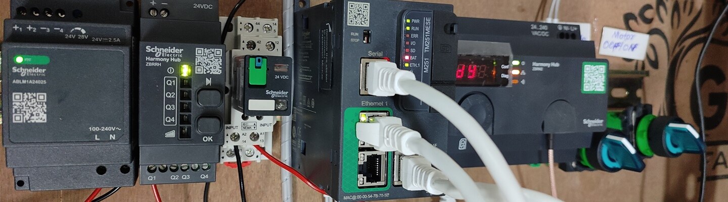

PLC and other instruments on the D-IN rack
I would like to thank Element14 community and Schneider Electric for choosing me as official challenger for their Experimenting with Industrial Automation contest. For this design challenge, my project was to create a project for overhead tank liquid level monitoring for smart home/industry. This means the project can be useful to monitor water level in the tank inside house but at the same time it can be used to monitor other liquids and chemicals in the industry considering and using required safety considerations.
This is a final project blog for Overhead tank monitoring for smart home/Industry.

Working with Harmony Hub(ZBRN2) and device association was one of the interesting work during this design challenge. ZBRN2 has possibility to connect to serial Modbus ASCII or RTU device using one of the two RJ-45 port pins. On the PLC side also there is one serial port that can be used for this purpose. After connecting the devices through RJ-45 cable one can add Device tree node for the ZBRN2 device(I have explained this in previous blogs as well).
When I added ZBRN2 the input registers and address were already specified so I did not need to do anything to see the pushbutton status. As soon as I went online with the PLC, I was able to see that the respective bit Boolean value changes on the press of a button. From there I got an idea to use this value and use the ZBRT2 with switch rather than a push button for my project so that I can create manual/auto and ON/OFF switch states easily.
For setting up the push buttons or ON/OFF switch it was required to assemble the wireless and battery less transmitter ZBRT2 with the mechanical switch. It was somewhat tricky in the beginning how to do that but the final results of this innovative assembly is in the bellow picture. Finally, an indicator module ZBRV1 can be attached to transmitter and the switch that blinks LED when we change the switch positions. (Finally, switches are ready Sunglassesto run the motor remotelySatellite)
Now it is time to look at ZBRRH wireless receiver module. Upto 60 ZBRRH wireless receivers can be connected to ZBRN2 hub. It has four outputs Q1, Q2, Q3 and Q4. These outputs can be in one of the following states.
  • 0x00 --> Output off
  • 0x5A --> Output blink
  • 0xFF --> Output on
The receiver ZBRRH can be associated to the output channel on ZBRN2 by using jog dial on the ZBRN2. I have connected Q1 output of the receiver to the relay module hence it can be controlled from the PLC. For that I tried simple ST(Structured Text) program.

The final project uses devices listed in the following picture plus ZBRA1 antenna. The antenna is mounted on the top flor of the home so that radio signal can be received from all parts of the house and outside of the house. I have tested the range of antenna. It has quite some range in open field(at least up to 100 meters I have tested).
