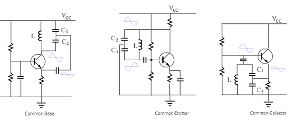

To begin with I am going to do experiments using a BJT NPN transistor for the amplifier. The amplifier can be made with different configurations such as common-base, common-emitter or common-collector.
In the first experiments I will use the common'base configuration.
Common-Base, also known as grounded-base, amplifier is one of three basic single-stage bipolar junction transistor (BJT) amplifier topologies, typically used as a current buffer or  voltage amplifier. In this circuit the emitter terminal of the transistor serves as the input, the collector as the output, and the base is connected to ground, or "common", hence its name.

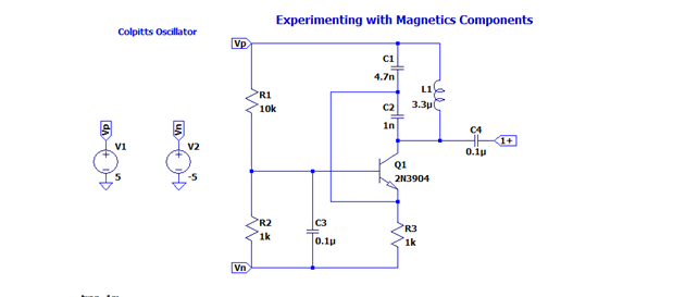

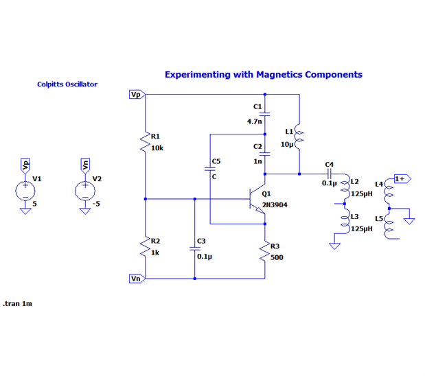

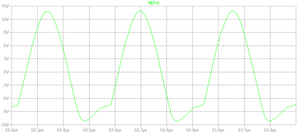

#E05 Colpitts Oscillator -  Ltspice simulations
Build a simulation schematic of the Colpitts oscillator as shown below. Then calculate values for bias resistors R1 and R2 such that with emitter resistor R3 set to 1 KΩ, the collector current in NPN transistor Q1 is approximately 1 mA.  The circuit is powered from a +10V power supply. To keep the standing current in the resistor divider as low as practical keep the sum of R1 and R2 ( total resistance greater than 10 KΩ) as high as practical . C3 provides an AC ground at the base of Q1. Set base decoupling capacitor C3 and output AC coupling capacitor C4 to 0.1uF.
The calculate a values for C1 and C2 such that the resonance frequency, with L1 set equal to 3.3 uH will be close to 3.049 MHz
C1 = 4.7nF, C2 = 1 nF, R1 = 10KΩ, R2 = 1KΩ
Simulation with LTSpice

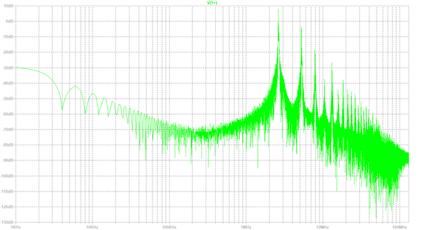

Initially construct the oscillator with separate positive and negative DC voltage supplies .
Schematic
Transient simulation
FTT
Resonant frequency 2.620 MHz

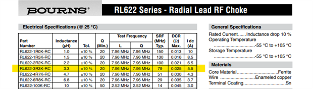

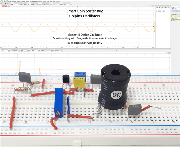

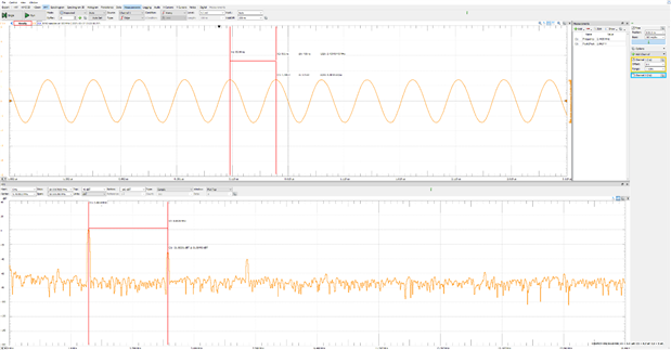

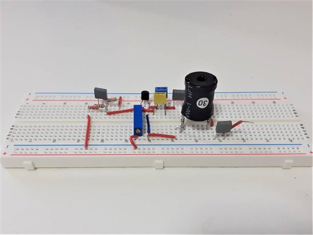

#E06 Colpitts Oscillator with Bourns RL622 3.3uH RF choke

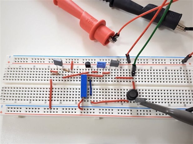

In this experiment I use a 3.3 RF Choke in a Colpitts oscillator circuit with an amplifier with BJT in common-base configuration.
Required components:
1 - 2N3904 NPN transistor
1 - 3.3 uH inductor
1 - 1 nF capacitor ( marked 102 )
1 - 4.7 nF capacitor ( marked 472 )
2 - 0.1 uF capacitors ( marked 104 )
1 - 5 KΩ potentiometer to find the best value for R3,
Product LinkProduct Link
RF Choke, Radial Lead, 3.3 uH
http://www.farnell.com/datasheets/2283900.pdf
I build the circuit on a breadboard. It would be better to have the components soldered but it is worth to see the behavior of the oscillators despite the noise.
For R3 I use a 5K potentiometer to adjust the value of the emitter resistor. It is a very critical value so that the wave is not clipping or disappearing.
The potentiometer allows to vary IE to tune the output voltage amplitude.

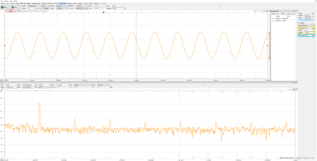

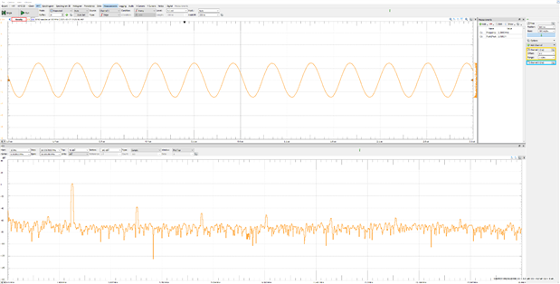

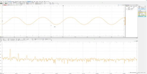

A plot example using R1=10KΩ, R2=1KΩ, C1=4.7nF, C2=1nF, L1=3.3uH
  • C1 = 4.7nF,C2 = 1 nF,C3 = n/a,R1 = 10KΩ,R2 = 1KΩ
Frequency: 2.441 MHz
  • C1 = 4.7nF, C2 = 1 nF, C3 = 47 nF, R1 = 15 K, R2 = 5K6
  • C1 = 33 nF, C2 = 10 nF, C3 = 47 nF,R1 = 10 KΩ, R2 = 1K
Adjusting R3, emitter resistor
The optimal value for R3 may change depending on the resonant frequency.
When the emitter resistance is not well chosen, clipping and deformation of the signal occur.

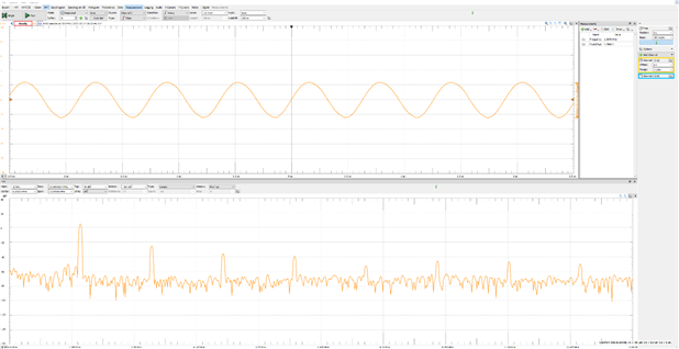

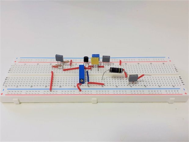

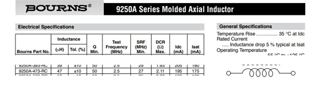

#E07 Colpitts Oscillator with Bourns 9250A 47uH RF choke
In this experiment I use a 47uH RF Choke in a Colpitt oscillator circuit with an amplifier with BJT in common-base configuration.
https://www.farnell.com/datasheets/2360326.pdf
1 - 47 uH inductor
  • L1 = 47 uH C1 = 33 nF C2 = 10 nF C3 = 47 nF R1 = 10 KΩ R2 = 1K
I build the circuit on a breadboard.  he circuit is the same as the previous one by changing the inductor and adding a bypass capacitor in the feedback signal.
Wave Frequency: 886.5 kHz

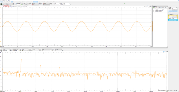

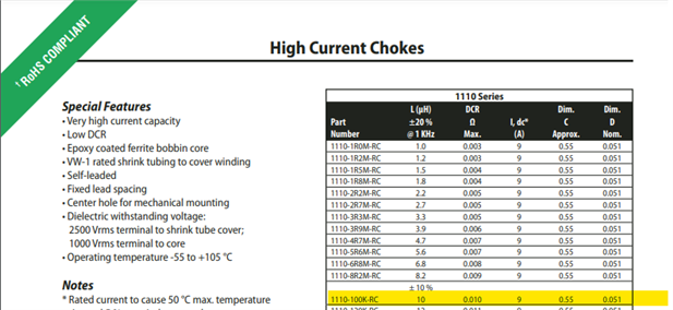

#E08 Colpitts Oscillator with Bourns 1110 10uH High Current Choke
In this experiment I use a 10uH High Current Choke in a Colpitts oscillator circuit with an amplifier with BJT in common-base configuration.
1 - 10 uH inductor
http://www.farnell.com/datasheets/167630.pdf
Wave Frequency 1.587 MHz
with c3
Observations
  • As the inductance increases, the output voltage increases.
  • Increasing the emitter current increases the amplitude of the output voltage.
  • Decreasing the capacitance increases the output voltage.
  • Decreasing the inductance decreases the resistance of the output.
  • Controlling the emitter current is critical for the circuit to oscillate.

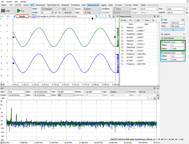

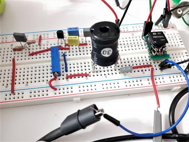

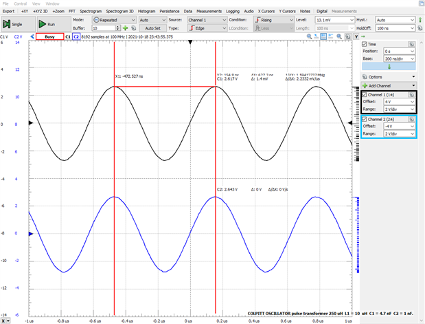

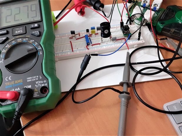

#E09 Colpitts Oscillator with Isolated Output. Using Bourns HCT  Pulse Transformer
To finish the experiments with the Colpitts oscillators with BJT I am going to add a transformer to the output to isolate the output circuit from the oscillator circuit.
An isolation transformer is a transformer used to transfer electrical power from a source of alternating current power to some equipment or device while isolating the powered device from the power source, usually for safety reasons. Isolation transformers provide galvanic isolation and are used to protect against electric shock, to suppress electrical noise in sensitive devices, or to transfer power between two circuits which must not be connected.

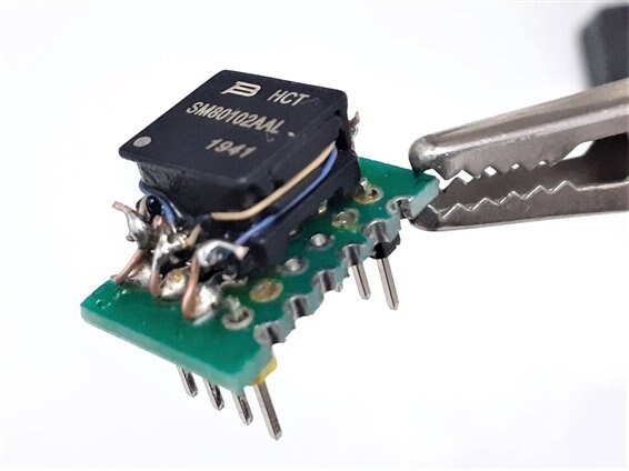

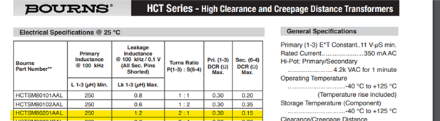

The kit has no isolation transformer but I use a pulse transformer that is in a kit with a 1: 2 ratio but with 1: 1 ratio as an isolation transformer.
http://www.farnell.com/datasheets/2897691.pdf
Making and adapter for breadboard
before cleaning flux:
Configuration with 1:1 ratio
  • Collector out to Primary 1-3
  • Isolated output to Secondary 6-5
Measuring collector current. Near 22.8 mA
Probe 1 to transformer primary
Probe 2 to transformer secondary
The transformer works very well

    javagoza over 4 years ago in reply to shabaz
    Hi Shabaz I'm using the Analog Discovery 2 with the Discovery BNC adapter board.
    https://digilent.com/reference/test-and-measurement/analog-discovery-2/start
    https://digilent.com/reference/test-and-measurement/bnc-adapter-board/start
    The software is the Digilent Waveforms for windows: https://digilent.com/shop/software/digilent-waveforms/
    I've got it very recently, a Sparkfun award for a project, and I'm still learning how to use an oscilloscope and how to use the software so I'm still not quite sure with the results.
    I have no way of comparing the oscilloscope to another, I have switched from the ADALM1000 SMU to the Digilent Discovery 2 and am really impressed.
    I am not professionally dedicated to hardware but to application software. My knowledge of electronics is almost 40 years old and I am quite rusty. But I am enjoying like a child with this challenge.
    shabaz over 4 years ago
    Hi Enrique,
    Nice work with the oscillators! The results were very impressive, with the second harmonic so low for them, approx 30 dB difference.. that's probably as good as things can get!
    What 'scope are you using, if you don't mind me asking? The screenshots from the software look nice.
