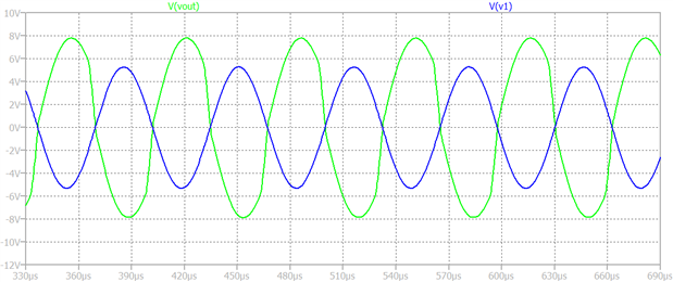

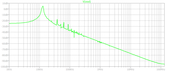

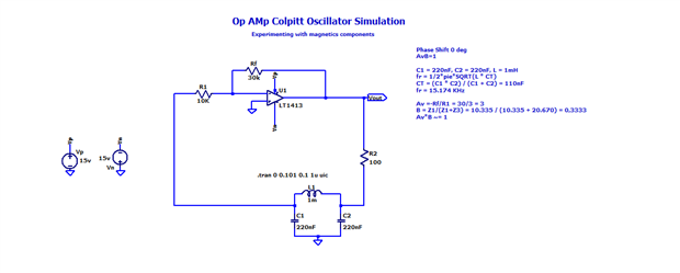

#E10 Op Amp Colpitts Oscillator -  Ltspice simulations
As well as using a bipolar junction transistor as the oscillators active stage, we can also use an operational amplifier. Negative feedback can be used for op amp oscillators. A part of the output signal is sampled and then added to the out-of-phase input signal (it is subtracted). In doing so, the circuit sees the difference between the input and the output. If the output signal is too large, the difference will be negative. On the contrary, the difference signal will be positive if the output is too small.
This signal is then multiplied by the gain of the circuit and cancels the output error. This process is carried out continuously; the only time delays involved are the propagation delays of the circuits used.
In an inverting amplifier, the output voltage changes in an opposite direction to the input voltage.

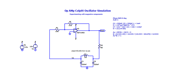

Simulation with the LT1413 Op Amp
Requirements:
  • Phase Shift = 0 deg
  • |Av|B=1
Being an inverting amplifier configuration, the ratio of Rf/R1 sets the amplifiers gain.
Resistor R3 provides the required feedback to the LC tank circuit.
  1. When | Ab | it is small the system is not able to maintain the oscillation.
  2. When | Av | is large the resulting wave is excessively wide and will be clipped and distorted
Calculations
  • C1 = 220nF, C2 = 220nF, L = 1mH
  • fr = 1/2*pi*SQRT(L * CT)
  • CT = (C1 * C2) / (C1 + C2) = 110nF
  • fr = 15.174 KHz
  • |Av| =Rf/R1 = 30/3 = 3
  • B = Z1/(Z1+Z3) = 10.335 / (10.335 + 20.670) = 0,3333
  • |Av|*B ~= -1

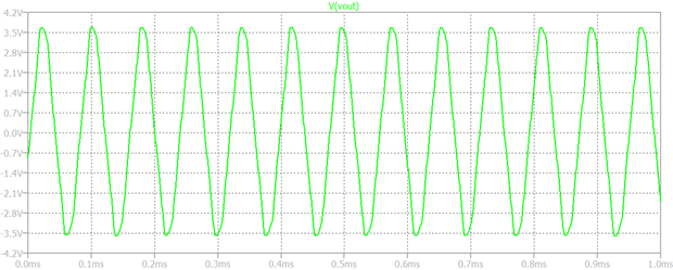

Transient response
12.759 kHz

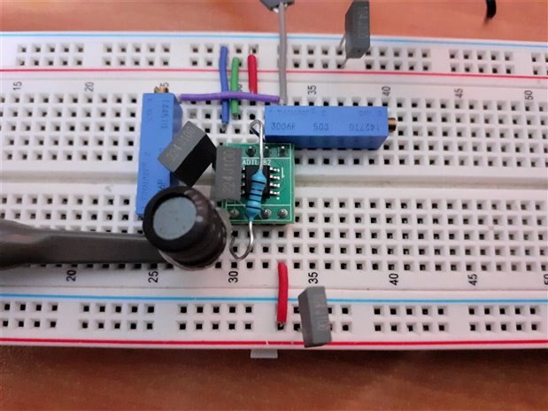

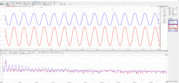

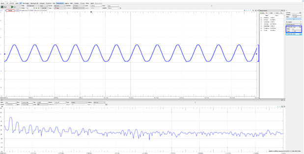

#E11 Testing with the ADTL082 Op Amp
For the first experiments I use an ADTL082 JFET op amp included in the ADALP2000ADALP2000 kit from Analog Devices
ADTL082 Datasheet and Product Info | Analog Devices

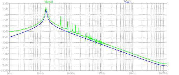

Ltspice Simulation with the ADTL082 Op Amp.

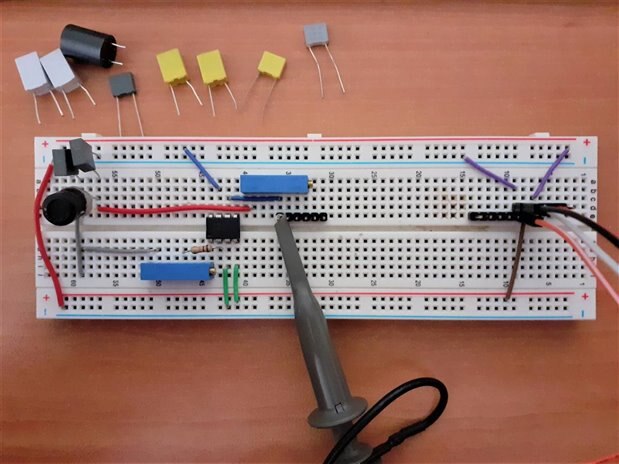

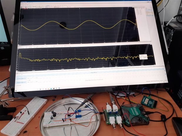

The circuit built on a breadboard. I tested several layouts for the elements by first prioritizing the display of the components and then minimizing the paths. See below the section on problems with the use of breadboards with oscillators.

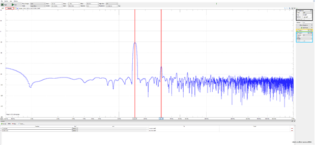

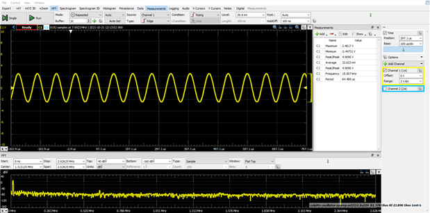

And the results with the ADTL082
after adjusting freq 15.16kHz

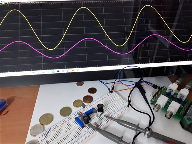

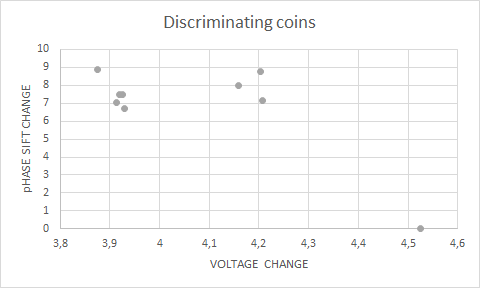

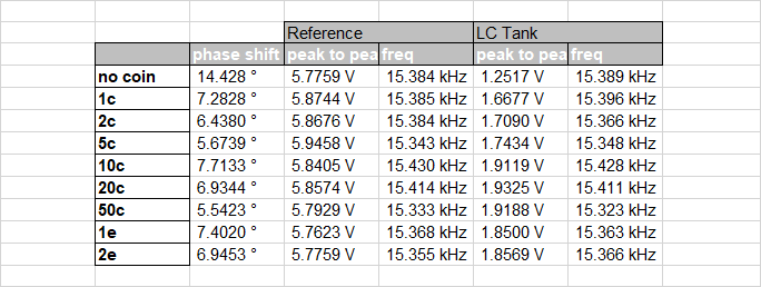

Testing the inductive sensing with the euro coin series.
The separation between the response to the proximity of the different euro coins is not as good as the one required by the discriminator. I need to fine tune the oscillator frequency with the resonant frequency of the LC tank.

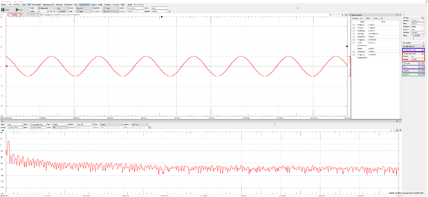

#E12 Testing with the NE5532 Op Amp
I first tried an LM741 op amp but it didn't give me good results so I tried later with a NE5532. The main reason is that I had them at home and their bandwidth is 10 times that of the LM741
NE5532x, SA5532x Dual Low-Noise Operational Amplifiers datasheet (Rev. J)

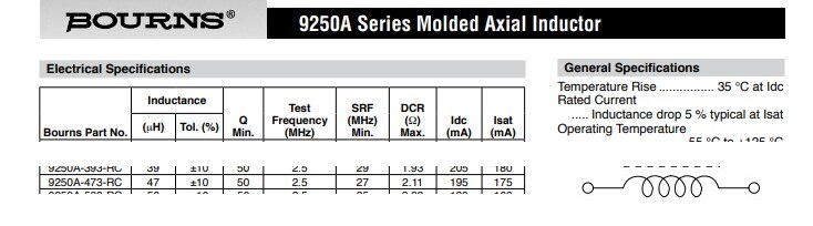

For these experiments I used the isolated 47uH RF choke https://www.element14.com/community/view-product.jspa?fsku=1695187&nsku=86K8271&COM=noscript
Product LinkProduct Link
https://www.element14.com/community/view-product.jspa?fsku=1695187&nsku=86K8271&COM=noscriptProduct Link
https://www.farnell.com/datasheets/2360326.pdf

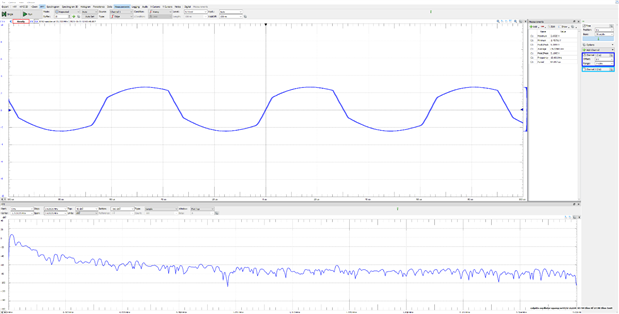

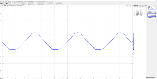

The tuning of the rf and R1 resistors is quite critical so that the signal is not clipping
After tuning with the values of the feedback gain resistors things got better.

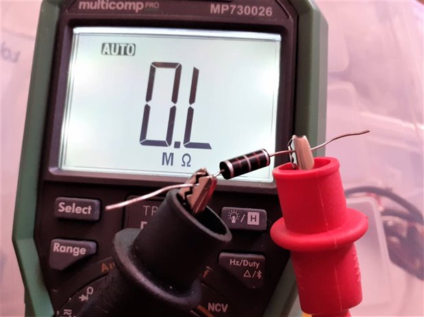

I try to lower the frequency of the oscillator using the  1.8 mH RF inductor but unfortunately it is broken, it has no continuity.

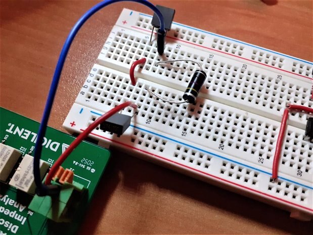

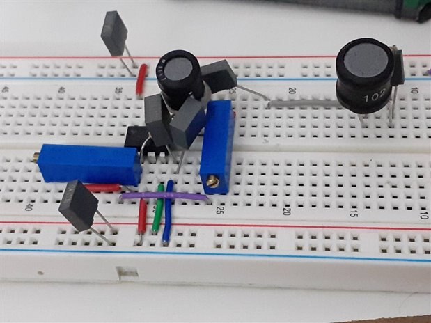

#E14 Identifying stability problems due to breadboard

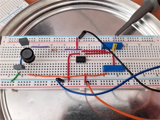

I've learned the hard way how complicated it is to experiment with oscillators on a breadboard.

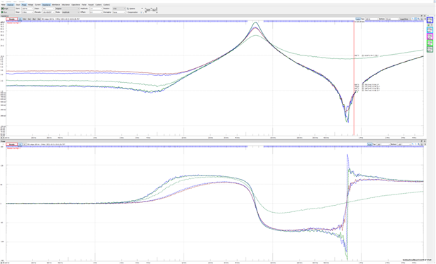

The results are often not repeatable so I will see how bad the impedance measurement of the pi-shaped oscillator circuit could be.
I use an insulated coil, RF Choke 47uF, to see the effect of having the components in a breadboard. I do different tests by moving the three components around and lengthening and shortening the distances between them. As can be seen in the plot, the behavior changes significantly between arrangements, which will not guarantee the necessary stability for the oscillator. The additional breadboard capacitance would present problems affects the oscillator. Glitches due to poor wire connections. Some parts are not through hole 0.1" (2.54mm)

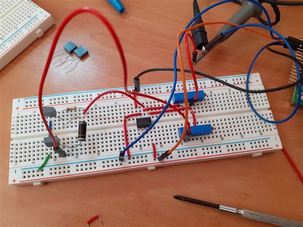

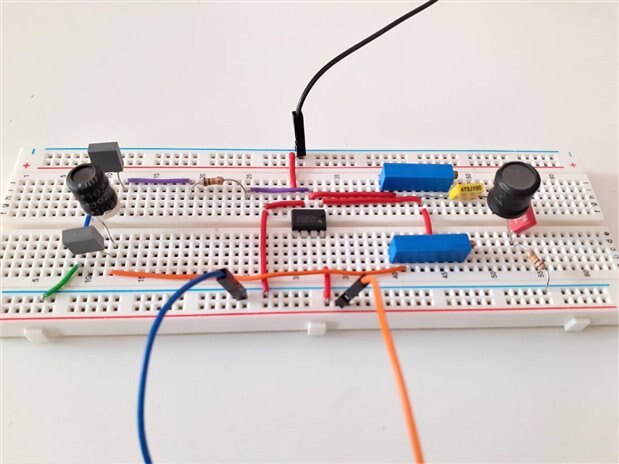

First layout to clearly show the different parts of the circuit. And in that way, accidentally, make it unstable.
New layout trying to reduce problems with the breadboard.
The two inductors are too close. It improves the stability of the oscillator somewhat but is difficult to adjust without touching a component.
15.507 kHz

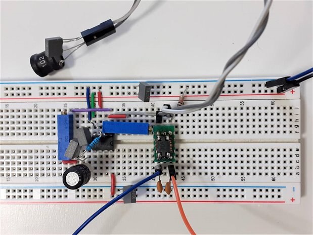

To see if the quality of the circuit on the breadboard improves, I decide to put a solid earth under the breadboard.
Some noise disappears but ...
...when testing the inductive sensitivity the LC tank almost totally loses sensitivity.
So for a next experiment I decide to move the LC tank away with a twisted-pair wire and use a common noise suppression filter.

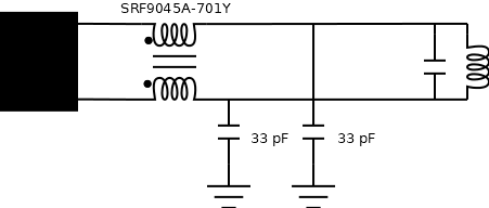

I try to integrate a common mode filter. A common mode choke produces a high impedance node that prevents common mode signals from coupling to the system. Chokes should be placed as close to the device under test as possible. Any common mode signal that travels through the device will have a short path, minimizing the possibility of any radiation, before being filtered by the chokes.
Common mode choke coil Suppresses common mode noise.
SRF9045A Series Common Mode Chokes (bourns.com)
SRF9045A-701Y
Work in progress...
I still have no clear results on how the filter affects. I see changes in the response but I don't know if they are due to mounting on the breadboard. At least the oscillator and the LC tnk are still working with the filter.
