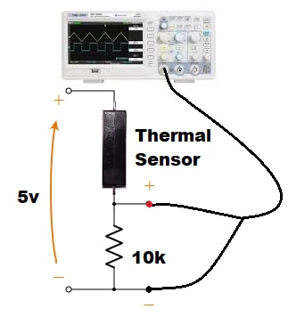

You can see the transition between ON and OFF, but it is still not clear to us how clean the signal is since the Arduino IDE has a lot of noise. The solution is to observe the signal through a digital oscilloscope since this can capture the signal at the moment of the transition, only it´s necessary to experiment with the data that is entered into the oscilloscope. Next I show you the experiment that I did.
As you can see, it's possible to see a transition of the signal from ON to OFF with the digital oscilloscope. In addition, this signal is clean and occurs in a time interval of approximately 200 microseconds. In the image below I show you a screenshot.

The signal behaves in a similar way in all the thermal sensors, below I show you an image captured with the digital oscilloscope.

  • Transition signal of a thermal sensor: a signal of 500 mv drops to approx. 40 mv abruptly. In the end, the signal falls linearly from 40 mv to 0 mv in approximately 150 microseconds.
  • Transition signal of a mechanical relay: a signal of 150 mv drops to approx. 50 mv abruptly. In the end, exponentially the signal falls from 50 mv to 0 mv in approx. 220 microseconds.
  • The thermal sensors signal behaves in a similar way with a relay, as we can see in the images captured with a digital oscilloscope. However, I see a slightly faster and cleaner response in the thermal sensor.
