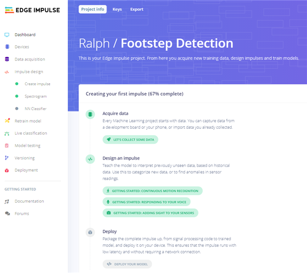

Here is a view of my project on my Edge Impulse dashboard:

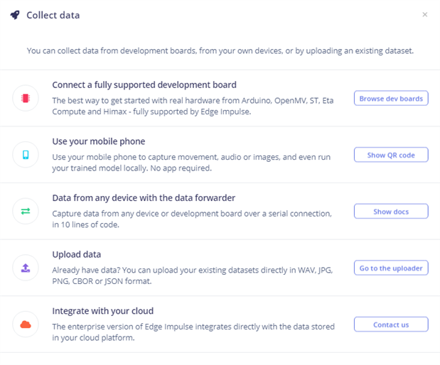

There are a few different methods for acquiring the data needed to train the model (impulse).  Using the Edge Impulse CLI, you can stream data from your device using the Data forwarder or upload data files using the Uploader.  You can also send data files to the Ingestion service https://docs.edgeimpulse.com/reference  using HTTP/HTTPS.
Here are the choices you are presented if you press the "LET'S COLLECT SOME DATA" button:
Data forwarder
The quickest way to start acquiring data is using the data forwarder.  It streams serial data to Edge Impulse.  It requires a 3 step process.

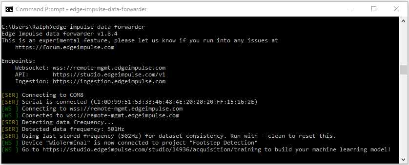

Step 2: Start the data forwarder.
The data forwarder is a node.js batch program (edge-impulse-data-forwarder) that is installed with the Edge Impulse CLI https://docs.edgeimpulse.com/docs/cli-installation  .
The first time you start the data forwarder, it requires your Edge Impulse username and password.  It then connects to your Edge Impulse dashboard and once you select the Project to associate the data, it downloads your credentials and connects the stream to Edge Impulse.  It also detects the data frequency on the port (in my case it is either 501 or 502 Hz which is slightly off the programmed rate of 500Hz).  Thereafter, it will continue to use these parameters until you reset them with a --clean argument.
Here is the transaction that followed the initial login:

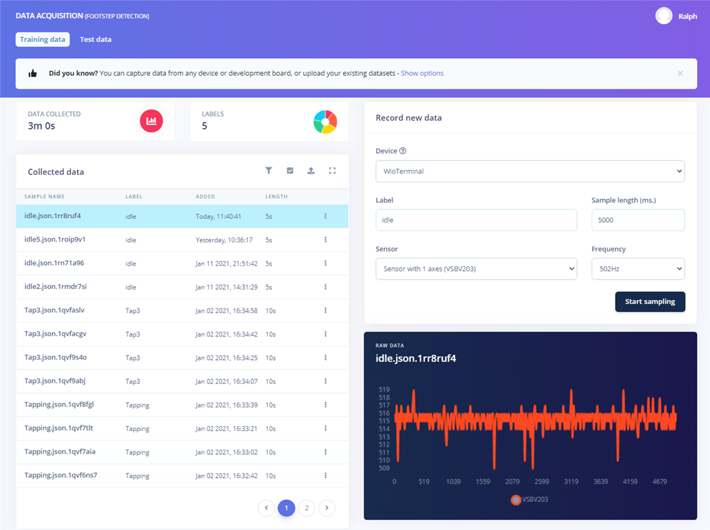

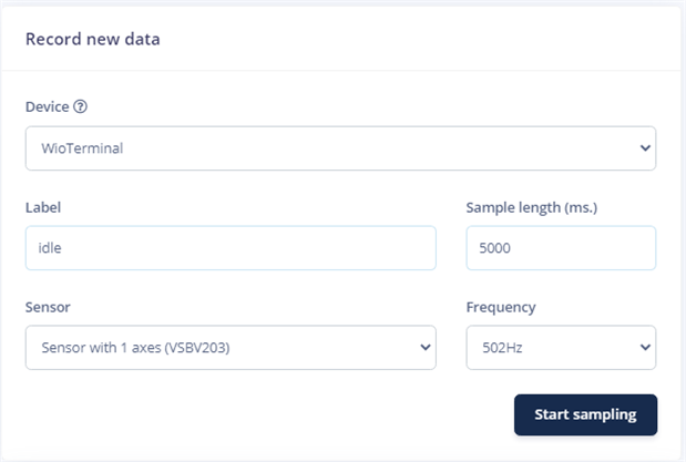

Step 3: Start sampling on the Edge Impulse dashboard.
Once the data forwarder is running, a new recording panel will appear on the Data Acquisition panel.
You need to set the Label and Sample length.  Hit the "Start sampling" button and it will capture the data set.
The highlighted file and the associated plot are what was just captured.
I've been experimenting, so there are a lot of other files captured.  I'll need to go back and clean these out.

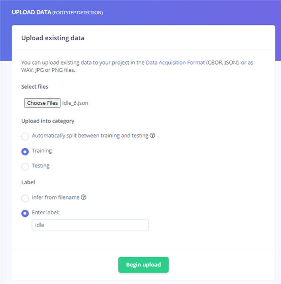

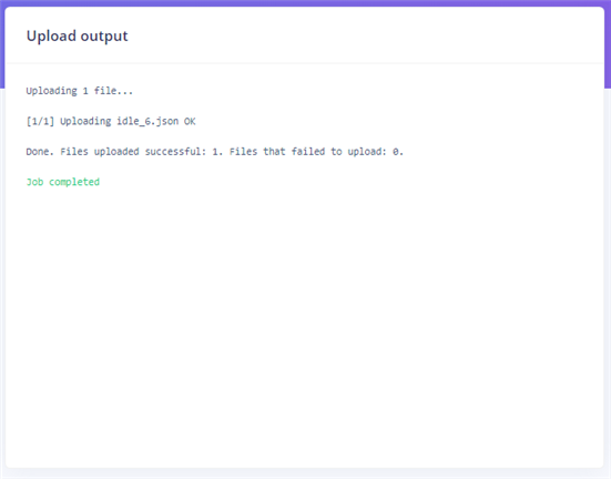

Step 3: Upload the encoded file to Edge Impulse

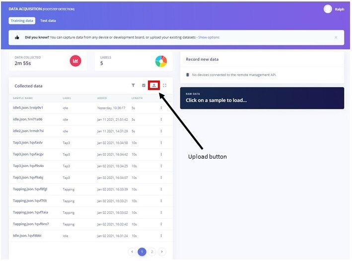

On the Data Acquisition panel there is an "Upload" button.
That brings up an Upload Data panel where you can select the files to upload, whether they should be part of the Training or Testing data set, and what Label to apply:

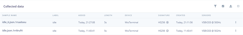

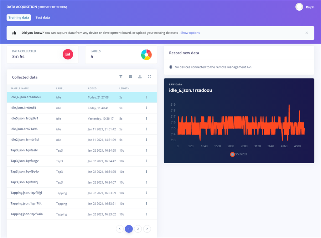

An interesting thing that I've noted is that it is easy to identify which method I've used because the sample rate is always slightly off when using the data forwarder but not the uploader.  I imagine that's some consequence of using the serial interface for uploading.  You can see that in the two files below.
A similar data plot:
