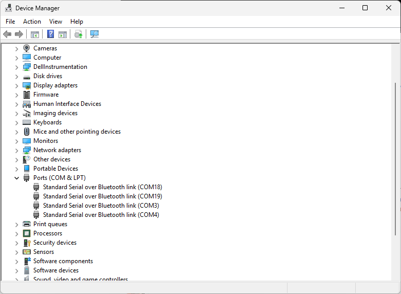

Serial console USB UART Bridge (Serial Port)
The Arty Z7 includes an FTDI FT2232HQ USB-UART bridge (attached to connector J14) that lets you use PC applications to communicate with the board using standard COM port commands (or the tty interface in Linux). Drivers are automatically installed in Windows and newer versions of Linux. Serial port data is exchanged with the Zynq using a two-wire serial port (TXD/RXD). After the drivers are installed, I/O commands can be used from the PC directed to the COM port to produce serial data traffic on the Zynq pins. The port is tied to PS (MIO) pins and can be used in combination with the UART 0 controller.

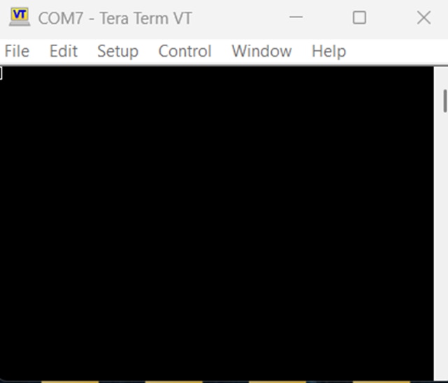

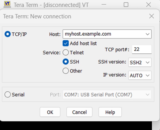

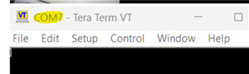

Using Teraterm to acces the serial console: configure Serial POrt communication
 tty interface
Boot console log

  • javagoza
    javagoza over 1 year ago in reply to Saif_Obaid
    The com port number is assigned by Windows. Go to the device manager and check which Port port is assigned to the board when plugging the USB port

    Jan Cumps over 1 year ago in reply to Saif_Obaid
    Your terminal tries to connect to a serial port. SSH is over the network, TCP
    Looks like your connection setup may be correct, but the terminal is not using it. Title says it's serial to COM7
