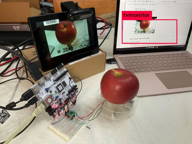

The image shows the load cell mounted on the Z-frame of the scale, with the output signal of the load cell amplified by the AD8226 instrumental amplifier. The amplified output is connected to the analog input A0 of the Arty Z7 development board. The AD8226 reference is supplied by the XVREF port of the Arty Z7.

The image of the barcode and the weight obtained by the scale are displayed superimposed on the image captured by the webcam on an HDMI screen, allowing the cashier to capture the barcode with a CCD barcode reader.

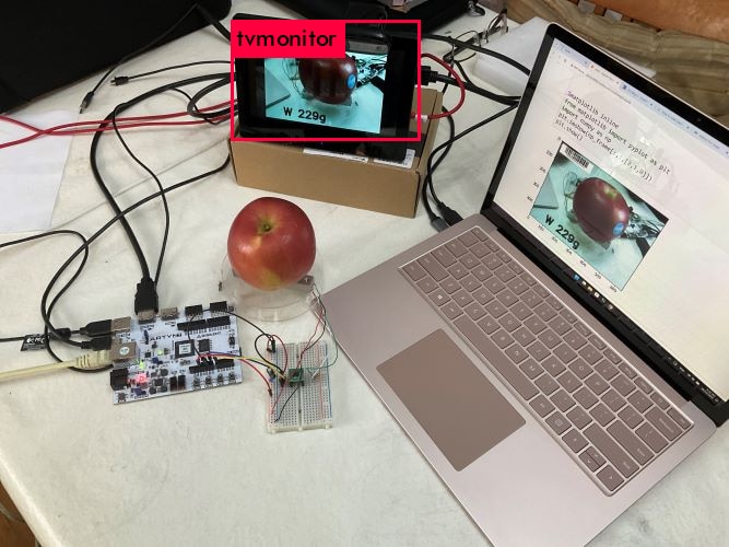

The Setup for the Experiments
In the picture, I show you the setup for my experiments. The Digilent Arty Z7 development board is connected to my local network with an Ethernet cable. It has a webcam connected through the USB port, and the HDMI output is connected to a small HDMI display. The weight sensor, the load cell, is connected to an instrumental amplifier that connects to the A0 port of the XADC analog-to-digital converter of the Zynq on the Arty Z7, which supports up to 3.3V. The Arty board provides the 3.3V that powers the instrumental amplifier and the 1.25V reference for the analog-to-digital converter. The laptop connects to a Notebook server that runs on one ARM processor of the Zynq on the Arty Z7.
