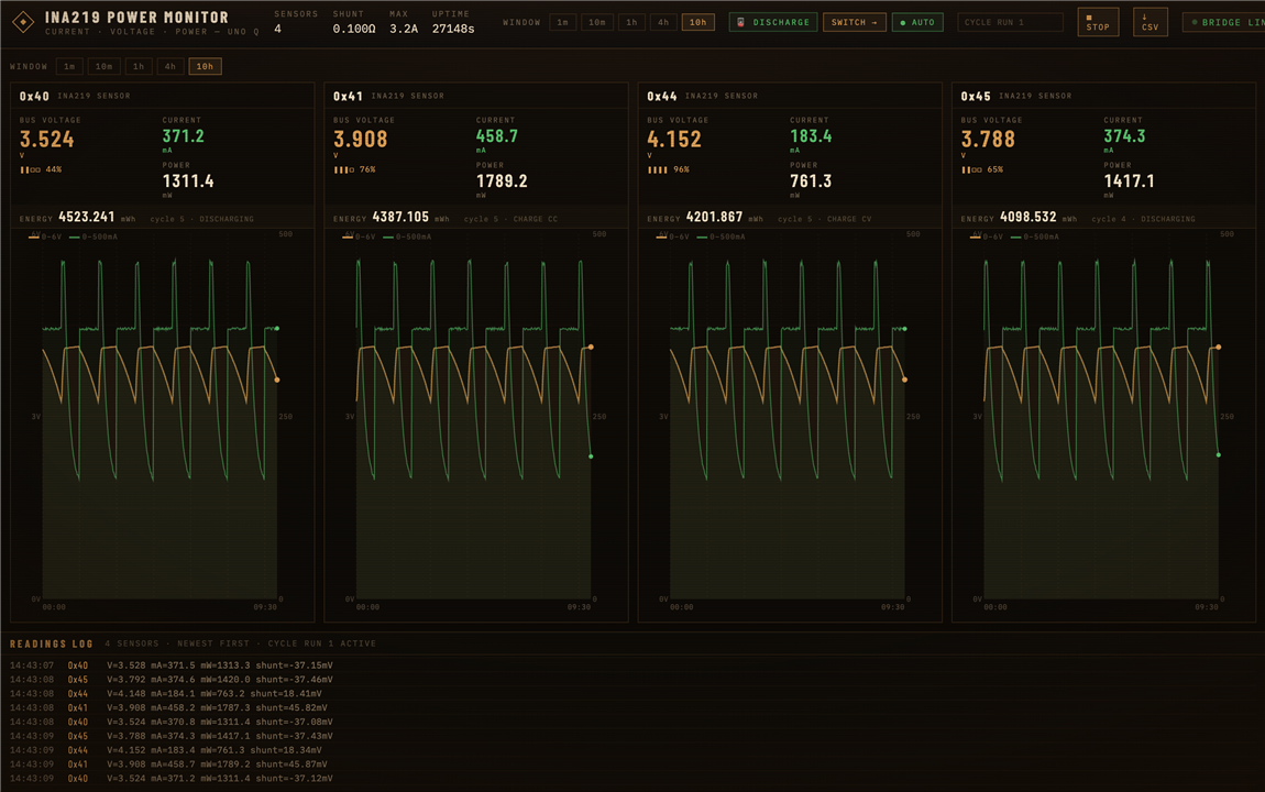

A system for characterising salvaged lithium cells from disposable vapes — measuring capacity, internal resistance, and charge/discharge behaviour — built around an Arduino UNO Q, an INA219 current/power monitor, and a live web dashboard. The relay auto-cycling works. The AliExpress “18650” turned out to have ~484 mAh of actual capacity. The vape cell data is still being collected.

Part III — INA219 Power Monitor
Although I had some ideas of OpAmp circuits and keeping to steady known discharge rates over a resistor, I came across the INA219 which was going to simplify this. Well simplify this after I got it working with the dual brain architecture of the UNO Q and some wiring issues.
Wire2.begin() isn’t optional. On arduino:zephyr, the I2C hardware peripheral uses lazy initialisation. Without an explicit Wire2.begin() in setup(), every transfer returns error 1 and nothing about the error messages hints why.
void setup() {
    Bridge.begin();
    Wire2.begin();   // i2c3: A4=SDA(PC1), A5=SCL(PC0) — without this, all I2C fails
Bus voltage needs a GND reference. The INA219 measures bus voltage at VIN− relative to GND. Current measurement is differential and works regardless, but voltage read 0.012 V until a wire ran from the battery’s negative terminal to the INA219’s GND pin. The cell was sitting at 3.87 V the whole time.

With readings flowing, a live web dashboard served from the UNO Q’s MPU: per-sensor cards (bus voltage, current, power), dual-axis sparklines with fixed scales (0–6 V amber / 0–500 mA green), session mWh tracking, time-window selector (1m → 10h), and CSV logging.
potentially up to 4 INA219 could be hooked up

Expanding the initial INA219 power monitor with a few relays, allowed me to cycle through charge and discharge cycles. Of course I ran into a few issues to get this working:
  • The INA219 calibration register resets on power glitches. Switching the relay caused a brief voltage dip on the rail that reset the INA219 — which cleared the calibration register and made the current register read zero permanently (shunt voltage still showed correctly, since it doesn’t need calibration). The fix: re-write the calibration register on every poll cycle, not just at startup.
    for (int i = 0; i < numSensors; i++) {
        // re-arm after any reset/glitch
        inaWrite16(sensors[i].addr, REG_CALIB, INA219_CALIB);
        if (inaRead(sensors[i])) sensors[i].reads++;
        else sensors[i].errors++;
  • Auto-cycling logic has a 500 ms reset bug. The first implementation reset the 30-second countdown timer inside updateRelay(), which was called on every SSE message (every 500 ms). The countdown never accumulated past 500 ms. The fix was one line: only reset the timer when the relay state actually changes.
    function updateRelay(on) {
      // only on actual state change
      if (relayState !== on) autoConditionStart = null;
      relayState = on;
Finally I got a neat dashboard to watch the auto-cycling between Battery CHARGE / DISCHARGE with a live [29s] countdown timer before the change over, battery percentage bars (❚❚❚White medium square 75%), and configurable thresholds (≥4.1 V and ≤150 mA held for 30 s to end charge; <3.0 V held for 30 s to end discharge).

Data collection in progress. First characterisation run on an AliExpress “18650”:
Metric This cell Genuine 18650 (2500 mAh)
Measured capacity ~484 mAh 2000–3600 mAh
Discharge time @ 340 mA 47 min ~430 min
Voltage sag rate 15 mV/min ~3 mV/min
Avg discharge voltage 3.50 V ~3.60 V
The discharge curve has no flat plateau — voltage drops steadily from 3.64 V to 2.92 V in under an hour. High internal resistance, re-wrapped smaller cell, or a counterfeit casing around an 18350. All three are consistent with the data. Vape cell data will follow once a full charge/discharge cycle completes.
