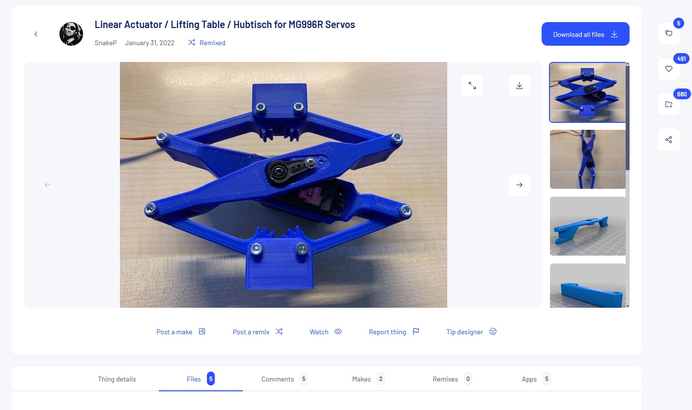

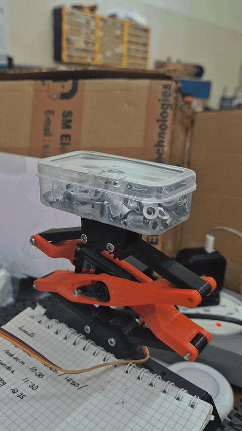

The actuator design
With the platform able to move itself around the floor, all I needed was an actuator that could lift and position the mock charger at different heights. That height adjustment matters because different car models have their charging port at different heights, and the mock charging dock on the car side won't always be identical either.
I found a design that did exactly this at thingiverse.com/thing:5225652 - credit for that goes to SnakeP (thingiverse.com/SnakeP). It worked brilliantly, and mounting it on the Devastator platform was painless.
I was able to lift around 300gms safely. I dare not try more, as I printed in the parts in the default infill of 15% and I do not have the time to reprint it if I broke it just to see how much weight it can lift.
