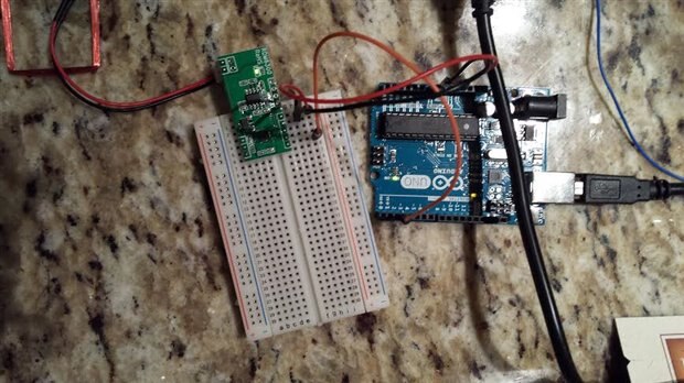

I have been using the Arduino platform for a while now(about 6 months) and I tried to hook up the RDM3600 RFID reader to my Arduino Uno and it seems like the reader does not communicate with the board. I present a card, but the serial interface does not display a serial number or anything. I am following this tutorial:
http://tronixstuff.com/2013/11/19/arduino-tutorials-chapter-15-rfid/
I modified the code to get an indication that the setup was complete:
#include <SoftwareSerial.h>
SoftwareSerial RFID(2, 3);
int i;
void setup()
  RFID.begin(9600);
  Serial.begin(9600);
  Serial.println("ready");
void loop()
  if (RFID.available() > 0)
    i=RFID.read();
    Serial.print(i, DEC);
    Serial.println(" next");
Does anyone have any idea why I don't get any communication from the RDM3600 when I present a RFID tag.

  • ellardpostma
    0 ellardpostma over 10 years ago in reply to gadget.iom
    Just followed what you stated and the module worked fine.
    Maybe it made a difference that I took the circuit apart and hooked everything up again.
    Tried three completely different tags and all worked.
    Even going back to pin 2 worked for me.
  • gadget.iom
    0 gadget.iom over 11 years ago
    Ok. Module arrived today! image
    I have hooked up the module to an Arduino Leonardo and run the following code:
    SoftwareSerial RFID(10, 11);
    int i;
    void setup() {
      RFID.begin(9600);
      Serial.begin(9600);
    void loop() {
      if (RFID.available() > 0) {
        i=RFID.read();
    (Note the change from pins 2 & 3 to 10 & 11...)
    The output is as follows:
    2 next
    53 next
    49 next
    48 next
    48 next
    55 next
    48 next
    70 next
    49 next
    54 next
    69 next
    66 next
    69 next
    3 next
    2 next
    53 next
    49 next
    48 next
    48 next
    55 next
    48 next
    70 next
    49 next
    54 next
    69 next
    66 next
    69 next
    I have tried a couple of tokens in the 125KHz band, and they both work fine.
