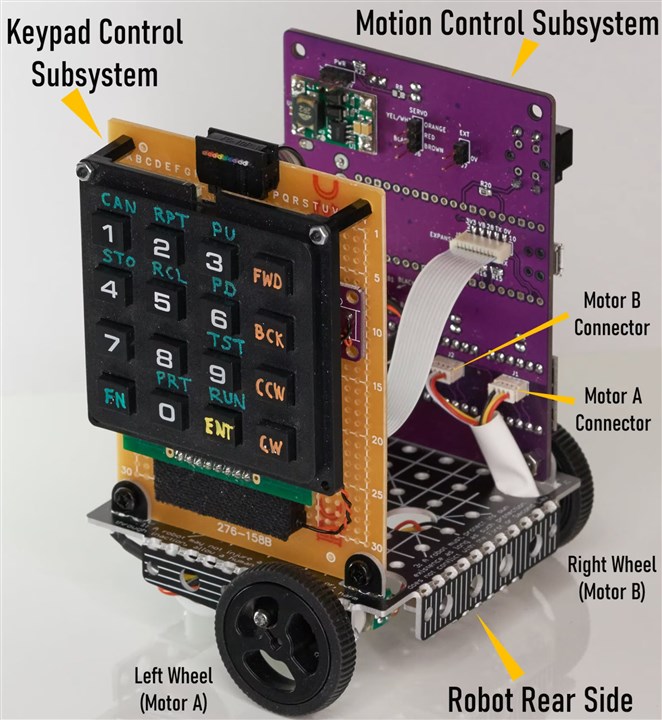

    shabaz over 3 years ago
    I always find I need one conductor more than the flat flex I choose!
    Anything 0.5 mm or higher pitch will be easily hand-solderable (especially with vertical connectors since they often had odd and even pins splayed on each side, so the pitch becomes 1mm, which then anyone can do with any iron, but even if it is on one side it is doable but that needs a bit more care). 0.4mm and smaller are intolerable to do by hand! Amazing what a difference that 0.1mm delta makes.
    1mm pitch is a pleasure to use, as easy and quicker than soldering pin headers.
    Unless space is super-constrained (which it usually is not, for non-consumer stuff) then it's good to just use (say) 10-way even if just a few conductors are needed, because there's not much board space saved between (say) a 4-way connector and a 10-way connector, and the extra conductors could be used for future expansion or doubling up, and less different inventory items.
    Example use-case where flat flex works out nicely:
    There's a bit of an art folding flat flex for (say) 90 degree turns and positioning things just right to not have any slack on boards! I think flat flex is one of the best cabling inventions ever. Curious to know its history!
