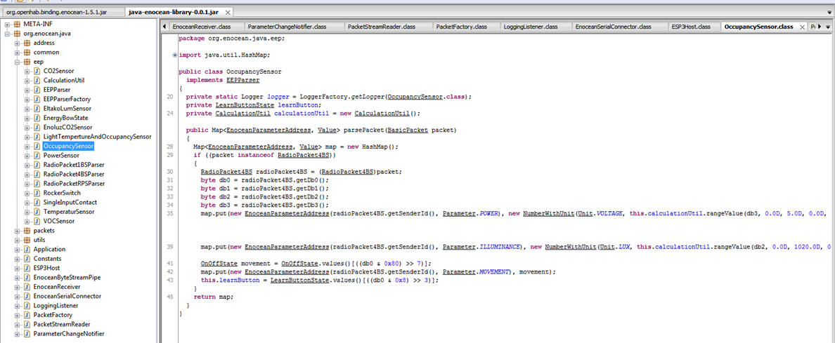

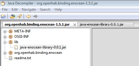

Inside org.openhab.binding.enocean-1.5.1.jar is a second file java-enocean-library-0.0.1.jar this file holds all the key elements you need.
EEPTypeParameterUnitHeader 5misc
EEP_D2_01_08PowerSensorParameter.POWERNumberWithUnit(Unit.WATT)("W")
EEP_A5_02_05TemperaturSensorParameter.TEMPERATURENumberWithUnit(Unit.DEGREE_CELSIUS("°C")this.calculationUtil.rangeValue(db1, this.scaleMin, this.scaleMax, 255.0D, 0.0D, 3)));
EEP_A5_08_02
LightTemperture
AndOccupancySensor
Parameter.TEMPERATURENumberWithUnit(Unit.DEGREE_CELSIUSthis.calculationUtil.rangeValue(db1, 0.0D, 51.0D, 0.0D, 255.0D, 3)));
Parameter.ILLUMINANCENumberWithUnit(Unit.LUX("lx")this.calculationUtil.rangeValue(db2, 0.0D, 1020.0D, 0.0D, 255.0D, 4)));
Parameter.POWERNumberWithUnit(Unit.VOLTAGE("Volt")this.calculationUtil.rangeValue(db3, 0.0D, 5.1D, 0.0D, 255.0D, 2)));
Parameter.MOVEMENTContactState.values()[((db0 & 0x2) >> 1)];
EEP_A5_07_03OccupancySensorParameter.POWERNumberWithUnit(Unit.VOLTAGEthis.calculationUtil.rangeValue(db3, 0.0D, 5.0D, 0.0D, 250.0D, 2)));
Parameter.ILLUMINANCENumberWithUnit(Unit.LUXthis.calculationUtil.rangeValue(db2, 0.0D, 1020.0D, 0.0D, 255.0D, 4)));
Parameter.MOVEMENTParameter.MOVEMENTOnOffState movement = OnOffState.values()[((db0 & 0x80) >> 7)];
EEP_F6_02_01RockerSwitch
EEP_F6_02_02RockerSwitch
EEP_D5_00_01SingleInputContact
EEP_07_06_01EltakoLumSensorParameter.ILLUMINANCENumberWithUnit(Unit.LUX,radioPacket4BS.getDb3()
EEP_A5_09_05VOCSensorParameter.VOC_CONCENTRATIONNumberWithUnit(Unit.PPB("ppb - parts per billion")
EEP_A5_09_04CO2SensorParameter.CO2_CONCENTRATIONNumberWithUnit(Unit.PPM, co2)("ppm - parts per million")radioPacket4BS.getDb2()
Parameter.HUMIDITYNumberWithUnit(Unit.HUMIDITY("%")
