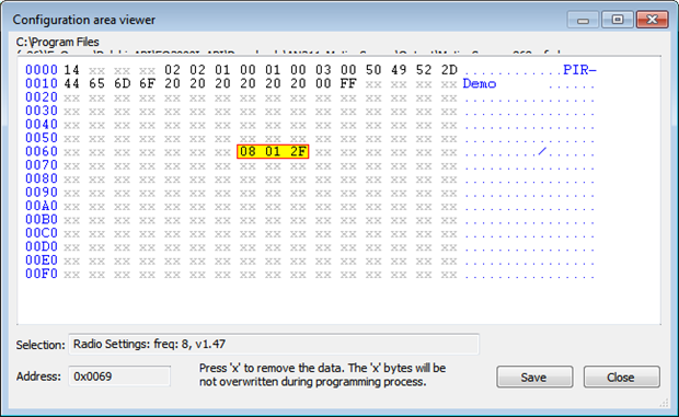

There is a very good Application Note for a Wall or Ceiling mounted sensors for room occupancy.
http://www.enocean.com/fileadmin/redaktion/pdf/app_notes/AN311_MOTION_SENSOR_BASED_ON_STM300.pdf
The advantage of these is that they are un-powered like the other sensors.
While they are used predominately to keep a light going and this is perfect for the intended purpose, this is not exactly what I wanted.
Looking at the code it appears they control a different pin to power the sensor, which then triggers the transmitter into sending a telegram.
If I've read it right the input is ignored for 5 secs after the WAKE0 is driven LOW, which sends the telegram.
So in theory I could power the PIR and use the sensor.
I have reprogrammed a STM310 with the code, and I immediately struck an issue with the wrong radio-conformity.
I was unable to find the revised XML file the error note referred to, so I edited the configuration to use the correct file.
          It seems that changing the last digit to 2F set the radio to ver 1.47 and all was happy.
ravi butani  has done a very good job of describing how to use the EOP350 programmer, so I'm not going to repeat it here.
Fireman Minion: STM330 Temp-Sensor with custom Analog and Digital Input (Part1)
Configuration
The Application Note included a zip file for reprogramming the sensor and was targeted at a STM300, but seems to work on a STM310.
You cannot change any parameters or settings, so don't bother trying.
Testing
I used Dolphin View and the Programmer with the TCM320 to view the results.
It shows a value of 255 when its triggered but stays quiet when not triggered ... so I might need timer in my rule.
