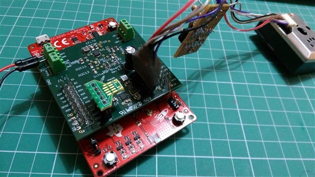

The board was designed using Eagle and made by Wurth Elektronik and I'm more than happy with how it turned out. Great job Wurth.de and thank you sleuz for your help!
Figure 1. Connected board with TI's HDC1000 and Sharp dust sensor
My board is using two TI boost converters with fixed output voltage for 3.3V (TPS61201 | Step-Up (Boost) Converter | Converter (Integrated Switch) | Description & parametrics) and 5V (TPS61202 | Step-Up (Boost) Converter | Converter (Integrated Switch) | Description & parametrics) rails on TI Launchpad. 5V supply is used for the Sharp dust sensor. This part of circuit works fine - if I drive this part of board with 3.8V input from a LiPo battery, I get proper voltages on TPS61201 and TPS61202 outputs.

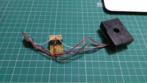

This board also includes two headers one for TI HDC1000 and one for Sharp dust sensor. I followed shabaz's advice and included a OpAmp to put the dust sensor output in the MSP430 ADC input range. Since I wasn't thinking about this problem (input incompatibility) I designed the board without taking the OpAmp into account so I had to build a small board for that and place it in the middle of the dust sensor "cable". This isn't pretty but it works (especially that epoxy connector)! image
Figure 2. Small board with OpAmp for level adjustment

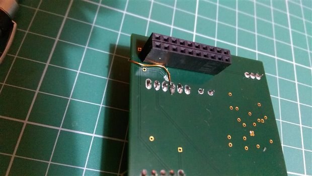

One more thing that wasn't well considered was the choice of pin for the dust sensor output - I selected a pin that's being used for UART Rx and since I plan to use UART later I did a small PCB modification (using X-acto knife and a piece of wire) and changed the dust sensor reading pin.
Figure 3. PCB modification image
