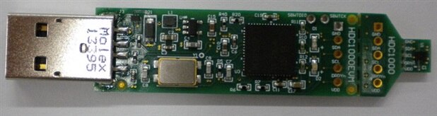

Thanks to Texas Instruments I received my HDC1000EVM - TEXAS INSTRUMENTS - EVAL BOARD, HDC1000 TEMP/HUMIDITY SENSOR | Farnell element14 UK evaluation module.
Figure 1. HDC1000 Evaluation module
This small module is based on a USB<->I2C interface made using MSP430 MCU. It also contains a HDC1000 chip soldered to specially designed board that can be broken into three separate pieces so that you can use the same HDC1000 chip in your own test circuit. I think that this is really great because you don’t have to make a breakout board to test it in your circuit – it’s already provided.

Under the hood, this application is using serial port to send and receive data. I couldn’t find source code or any additional details about this application so I did my own research. It turned out that the application sends very simple and short commands to the USB module. For example, sending ‘1’ over serial port will result in module sending back the temperature value in hexadecimal format, ‘2’ is used to request humidity. ‘3’ is used to request continuous updates with both temperature and humidity values and ‘4’ stops that. I didn't really have to inspect this but I was curious and it was fun image.

The next step was to test the sensor without the USB motherboard. For this, I used the Bus Pirate 4.0 (nice little tool that can be used to test different devices).
I soldered the male headers to the broken board so that I can easily hook up the probes.
Figure 3. Bus Pirate 4.0 with HDC1000 broken off the evaluation module
