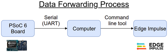

In this blog, we will be collecting our gesture data so that we can train our model on Edge Impulse. Firstly, we will create a data forwarder so that we can send the data. Next the data is collected and trained to create a model.
This is the process of data forwarding

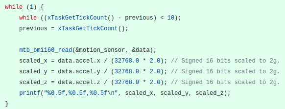

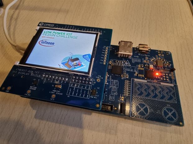

PSoC code for data forwarding
If the user button is pressed upon turning on the device, it will go into a section of the code for Data forwarding mode. It consists of an infinite loop where it readings (x, y and z axis)to the serial UART console.
To summarize, we are sampling the sensor at 100Hz which will be the data sent to Edge Impulse.
Here is a snippet of the code:
The full changes are in my Github commit:
  • https://github.com/zst123/Element14_Low-Power-IoT/commit/fa9ebb7eb5c7b60d6ef6cf7a204d50c040249829

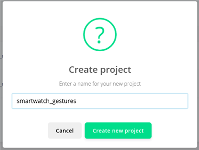

Create a new project in Edge Impulse
This will be the project we will forward the data into

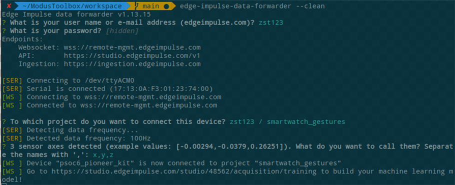

Install command line tools for data forwarding
Now that we have the board sending data over serial, we need to forward it using Edge Impulse's command line tool.
The instructions are found here on their official page:
  • https://docs.edgeimpulse.com/docs/cli-installation
Set up the tools according to their instructions too
  • https://docs.edgeimpulse.com/docs/cli-data-forwarder
Plug in the board and run the command (edge-impulse-data-forwarder).
In my case, it prompted for my username, password and project name.
The 3-axis data is detected and I named it as x,y,z respectively.

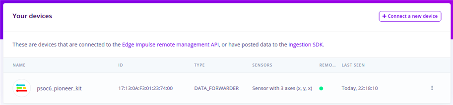

Click on the link as shown in the command line, or visit your project devices page. On Edge Impulse, the device has been recognized successfully.

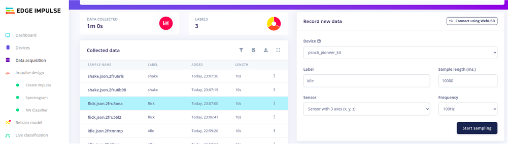

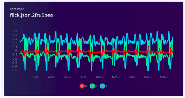

Collect the data

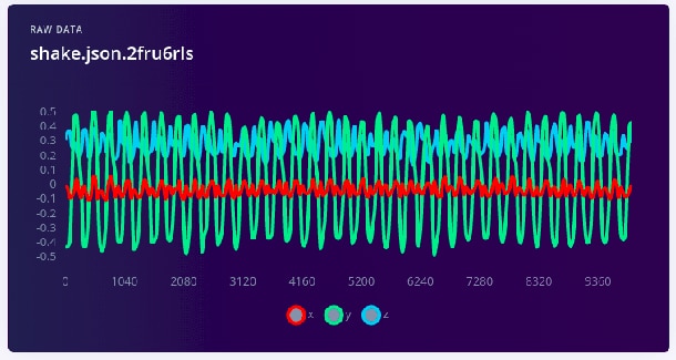

Under data acquisition, I did the data collection. I collected 20 seconds flick, 20 seconds shake and 20 seconds idle.
Shake is swinging the device back and forth
Flick is a quick turn of the wrist
Lastly, idle is simply placing the device on the table without touching it.

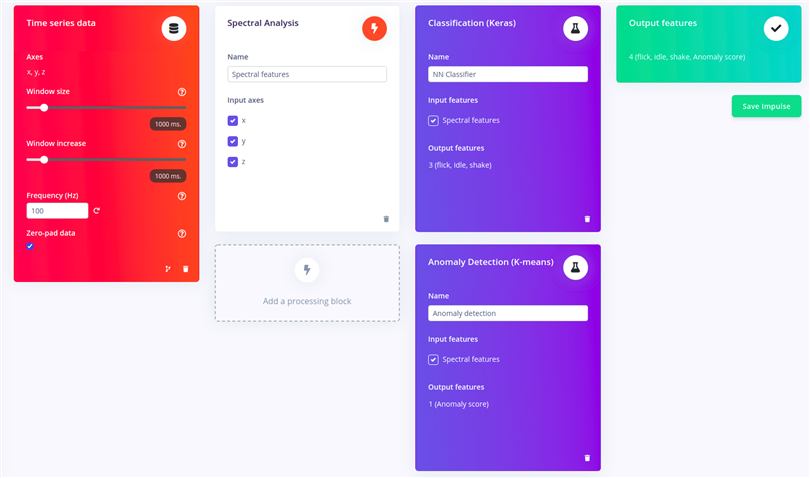

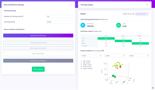

Training the model
I left most settings of the model as the default recommendation. For your reference, this is my impulse settings.

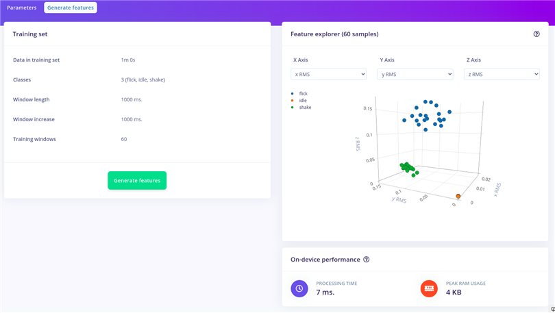

On the next page, generate the features. We can see that the 3 classes are very spaced apart in the graph, so there should be no problems in our model.
Lastly, I trained the classifiers and the accuracy is 100%. There may be problems due to the limited amount of data, and the model has probably overfitted to the data. However, I think I will proceed with this for the purpose of this project as a proof of concept.

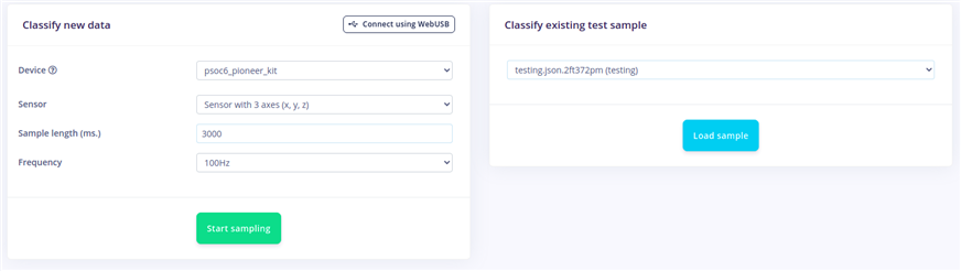

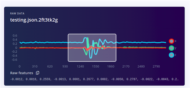

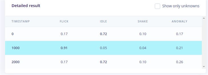

Live classification of the model
Now we have the model trained, I plugged in the board with the data forwarding again. We will be checking if we can classify gestures properly with this model. I started the testing sample and did a flick gesture
These are the results. You can see that the flick gesture was detected successfully in the middle section, and the sections before and after are detected as idle.
