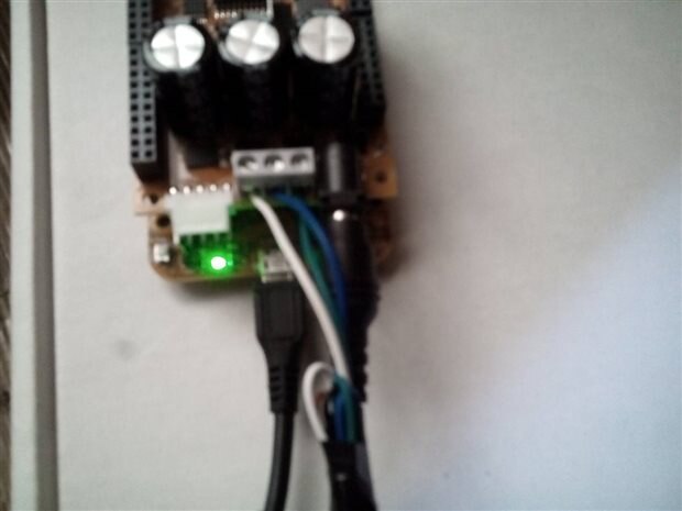

The hardware setup is not complex at all. The only missing pieve of information was how to connect the motor to the connector on the LVPMSM board. The only reference was the picture on the NXP site, so I connected the motor as shown in picture and fortunately it works. Pay attention to connect the thicker wires, since there are other green, blue and white wires for the sensor (they are thinner)
