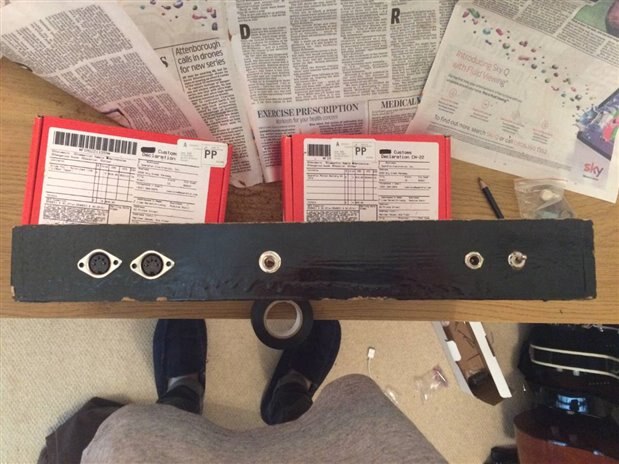

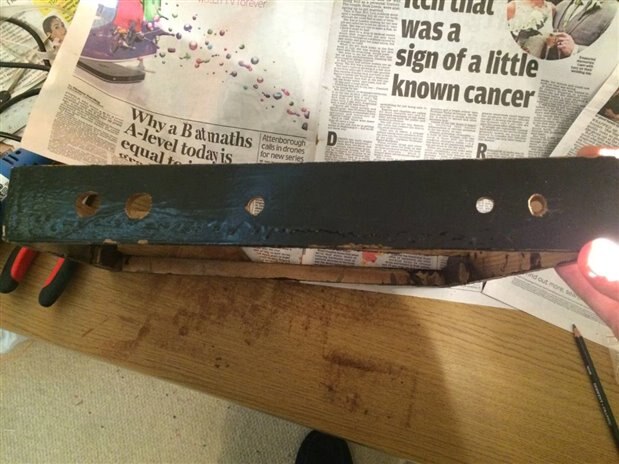

The first thing I needed to do was to get out my Dremel and cut out some holes for all five components. Below is a photo of the back of the piano enclosure after I had done this:
Back of the vintage toy piano with holes cut out for sockets and controls
I'm in no way saying that this is my best Dremel work - the holes aren't perfect circles or in line. However as it is a vintage hand-build piano nothing is perfectly straight anyway, so my sloppy drilling actually goes quite well with the existing enclosure!

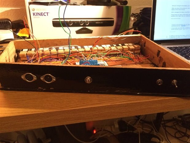

Below are some examples of what the back will look like once the sockets and controls are added:
Back of the toy piano with the sockets/controls added

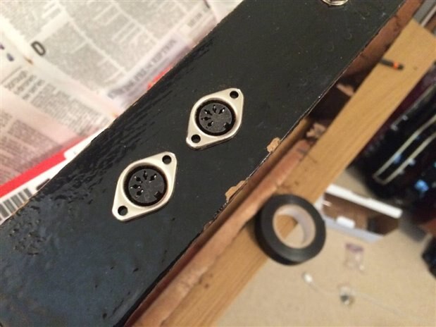

5-pin DIN MIDI sockets

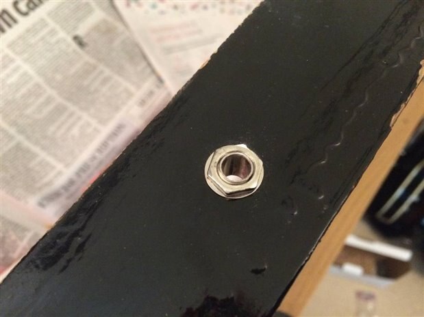

6.3 mm stereo jack socket
DC socket and toggle switch
An example of the sockets with the rest of the synth

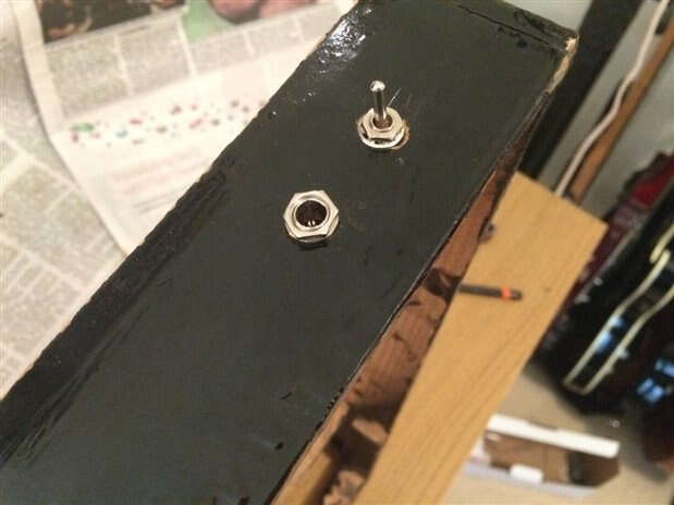

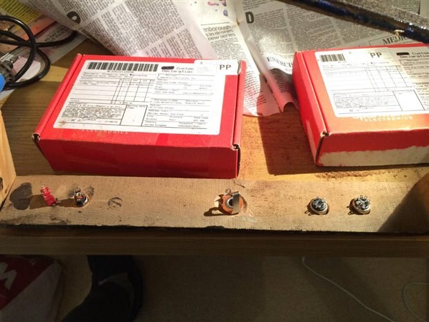

The MIDI sockets and the toggle switch were long enough to fit through the wooden panel, however the jack and DC sockets were too short to allow me to fit a washer and nut to them for securing the sockets to the panel. Therefore on the inside of the enclosure I had to cut away an area of wood around the holes for these sockets so that the components would fit correctly, as show in the below photo:
Inside of the back

  • I decided to use the metal-framed MIDI sockets rather than the more-commonly used right-angle MIDI sockets as they are much easier to connect and secure to 6mm-thick wood. Also the right-angle sockets are designed to be secured to a PCB/circuit instead of the enclosure, which would have given me less freedom in regards to where I place the MIDI circuit/stripboard within the synth.
  • I decided to use a 6.3mm audio jack socket instead of a 3.5mm mini jack socket as they are more commonly found on commercial synthesisers and similar products. Even though the current synth engine is just monophonic, I chose to use a stereo jack instead of a mono jack so that stereo headphones could be used without only one ear being active.

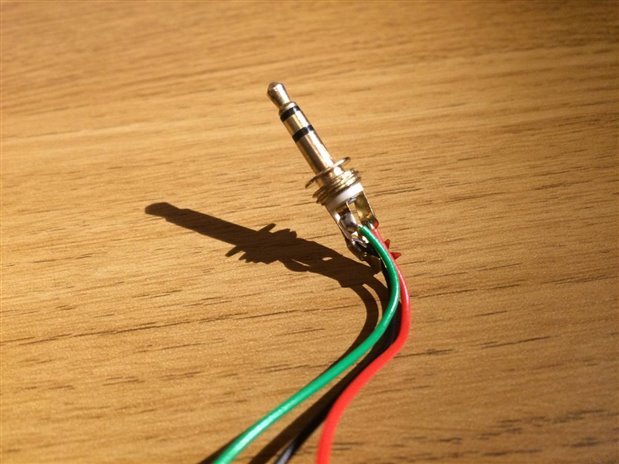

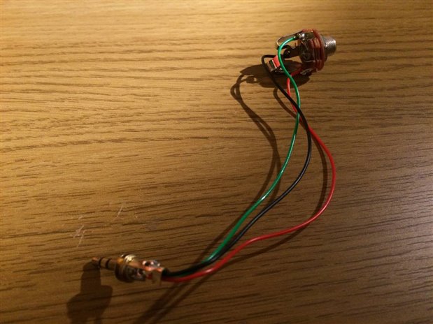

Audio Jack Socket

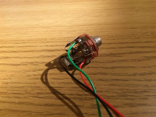

From my previous blogpost on BeagleBone Black audio you would have read that I'm using an EC Technology USB audio adapter for the audio output of the BBB within my synth, which has a standard 3.5mm stereo mini jack as the audio connector. Initially I was trying to find an existing cable/adapter that goes from a male 3.5mm jack to a female 6.3mm jack, where the socket side of the cable could be secured to a hole using a washer and nut, however I had no luck finding this cable. Therefore I ended up making my own cable, where I have attached a mini-jack plug the the jack socket using the three need wires - left (tip),  right (ring), and ground (sleeve). As the cable isn't longer than 8 inches I didn't need to worry about insulating the wires to prevent noise interference.
MY DIY audio cable
The jack socket side of the cable, which will be attached to the back of the synth
The jack plug side of the cable, that will connect to the USB audio adapter connected to the BBB

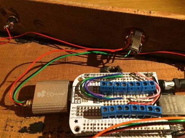

The DIY audio cable connected to the BBB

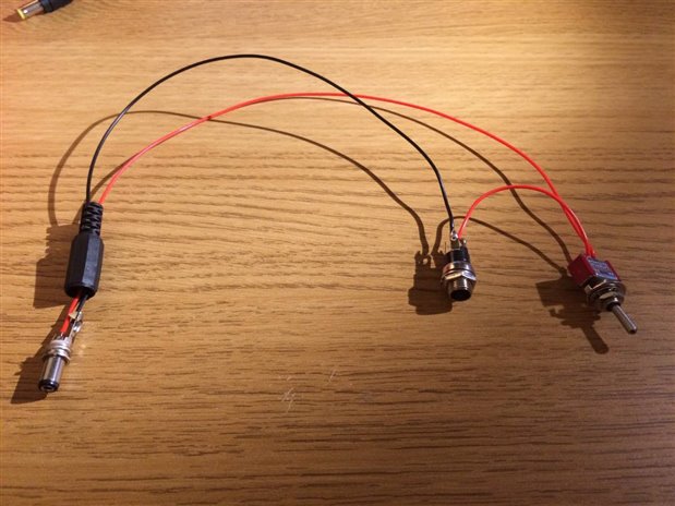

DC Power Socket

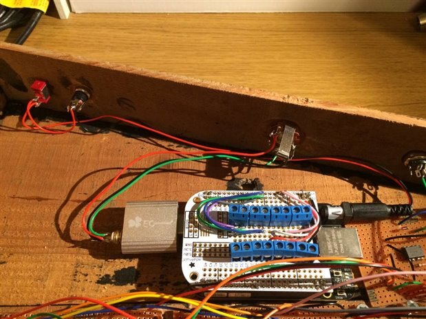

For the power socket I have essentially done the same kind of thing as that for the audio connection - I've build my own cable that goes from the socket to a DC plug that connects to the 5V power socket on the BBB. However here I have also added in the power switch that breaks the power line when turned off.
My DIY power cable
The DIY power cable connected to the BBB
