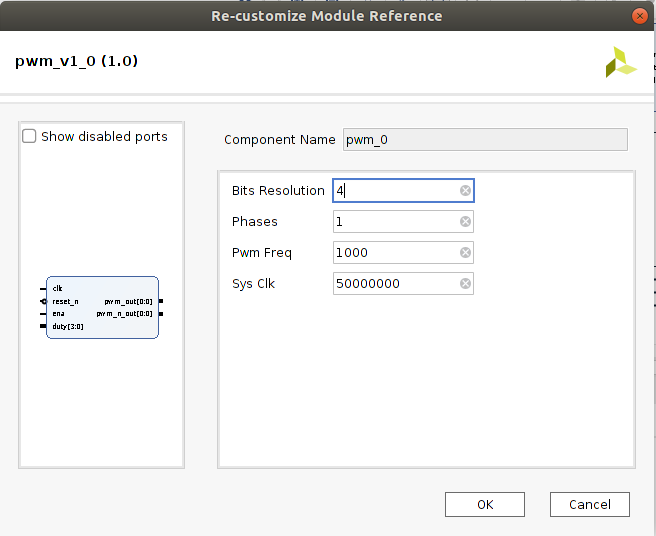

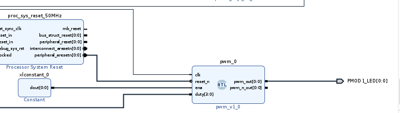

AXI_IIC_1 is the interface between Zynq FPGA and PMOD color module on PMOD1. I add a PWM VDHL module into Zynq FPGA for LED dimming control. The reference design of PWM VHDL is from DigiKey TechForum(Ref[3]).  Digilent PMOD_SWT will be attached to PMOD2 for LED dimming control. Digilent PMOD color module has one dimmable LED for light source. There are 4 switchers on the PMOD_SWT module, so 4-bit resolution is configured for PWM duty cycle control.
The theory of PWM dimming control is well documented at Ref[3]. 50MHz clock is applied as the system clock of PWM VHDL module. 1Khz is configured frequency of PWM signal. The bit resolution defines the resolution of the pulse width. For 4-bit resolution PWM duty cycle control design here, the pulse width has resolution at 16. The finest possible pulse width adjustment is the period (i.e. 1/ pwm_freq) divided by 16. The parameter phases sets the number of outputs and their relation to one another. The number of PWM outputs means phases, and these outputs are 360°/phases out-of-phase with one another.
Figure 4 presents the VHDL module implemented at Vivado 2021 GUI diagram. Figure 5 shows how to configure the parameters for PWM VHDL module.
PWM_VHDL_module
Figure 4: PWM VHDL Module for Dimmable LED
PWM_module_config
Figure 5: PWM VHDL Module Configuration

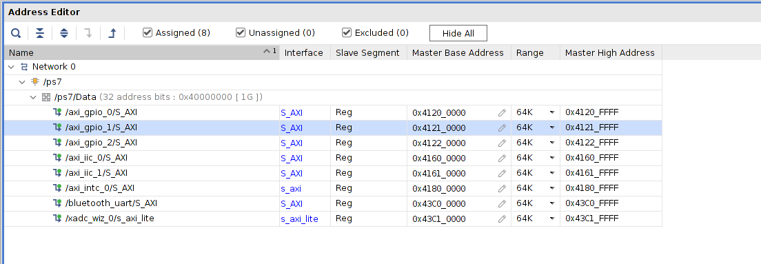

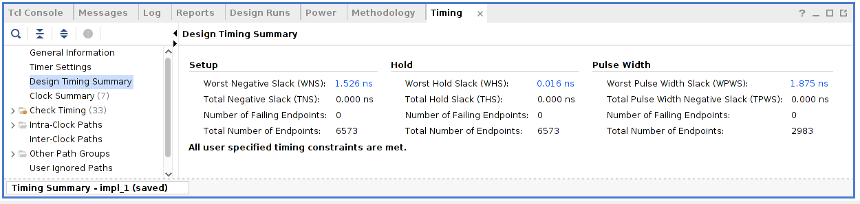

 Final report for MiniZed FPGA hardware report:
{gallery}MiniZed_FPGA_HW_report
MiniZed_HW_Mem_mapMiniZed_HW_Mem_map
REPLACE THIS TEXT WITH YOUR IMAGE
MiniZed_PMOD_Color_Webser_FPGA_resource_report MiniZed_Webser_FPGA_resource_report
MiniZed_HW_TimingMiniZed_HW_Timing

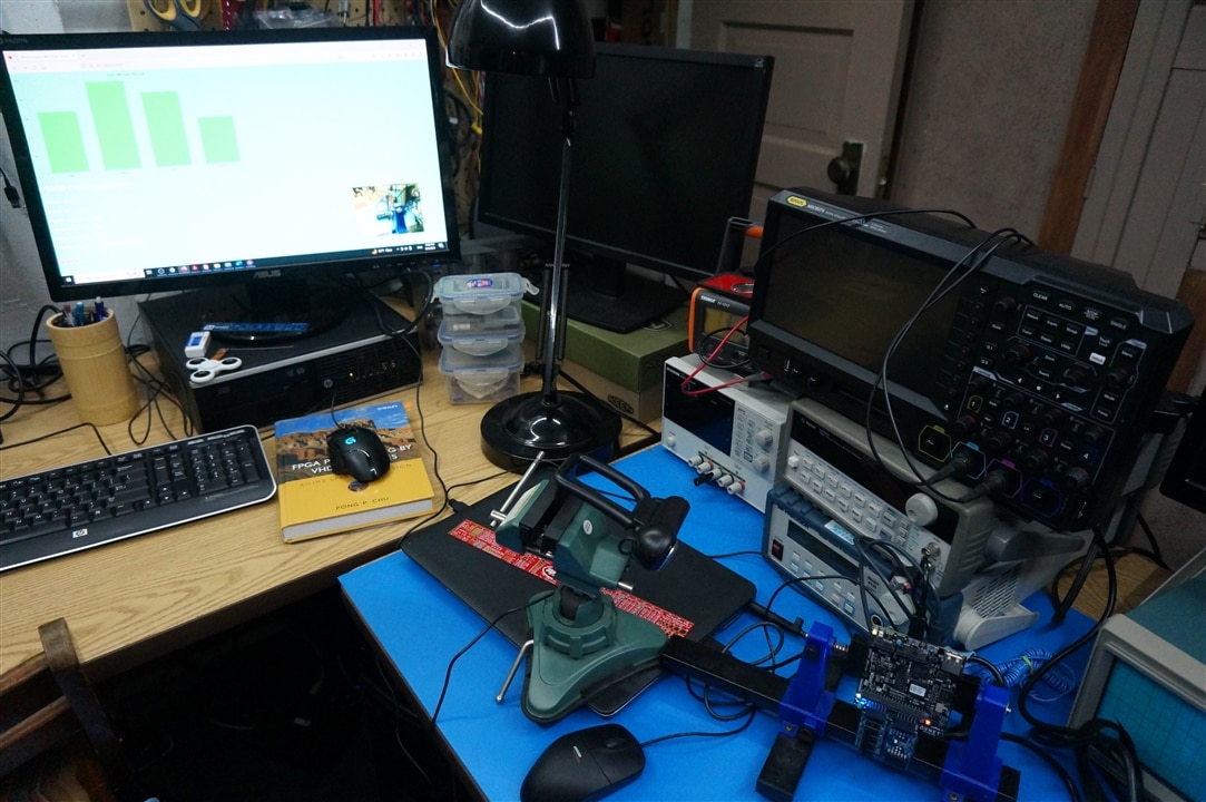

MiniZed prototype bench testing is ploted at Figure 7.
Figure 7: Digilent PMOD Color Module Standalone API Running on MiniZed

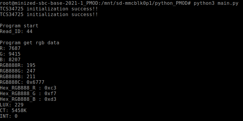

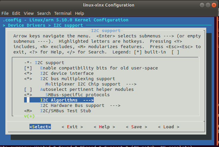

      4.3 Using Python3 to develop Digilent PMOD color sensor API
Xilinx/AMD Petalinux 2021.1 provides a framework for Python3 application development. I configure the kernel with I2C SMBUS for Python3 development as Figure 9.
i2c_smbus_kernel_driver
Figure 9: Configure SMBUS for I2C at Petalinux Kernel
Ref[4] is a good reference to for Python 3 drivers of TCS34725, which targeted on Raspberry Pi platform. I am able to use TCS34725 Python driver from Ref[4] for MiniZed Petalinux tool chain with a little bit tinkering work.

Here is the snapshot of PMOD color sensor up into running on MiniZed under Petalinux 2021.1 build.
PMOD_color_Python3
Figure 10: PMOD Color Sensor Python API Running On MiniZed

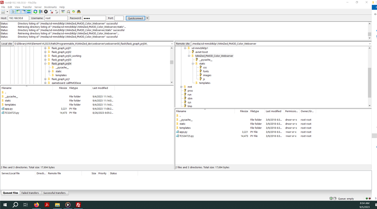

The MiniZed WiFi FTP server is presented in Figure 12. You might find the webserver file system on MiniZed at the right side of the figure.
FileZilla_MiniZed_WiFi_FTP
Figure 12:  FileZilla FTP for MiniZed WiFi

MiniZed Color Sensor Webserver Demo
After more than a month learning, I cannot remember how many iterations I have done to bring all the building blocks together and finally I am able to present you a working Petalinux project on MiniZed with my homegrown webserver.
Bench Testing Setup
Figure 14: Bench Testing Setup
MiniZed_PMOD
Figure 15: MiniZed PMOD Color Sensor/SWT
MiniZed color sensor webserver with LED dimming control is up into running. The detected color from PMOD sensor will be reproduced as the background color on the webserver. The webcam is able to present the color paper on the same screen of the webserver, so the reader can tell the project is working as expected or not.
