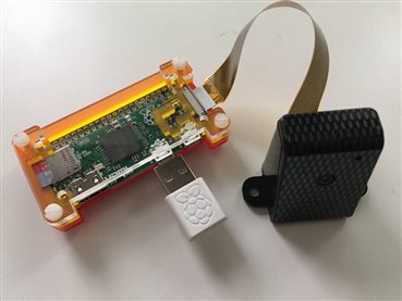

Nothing super exciting on the hardware side of things, as it's merely a Pi Zero with wifi dongle and camera module, but I can perhaps share two interesting gadgets I've used image

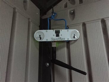

The first one is the ZeroView, which I already mentioned in my [Pi IoT] Alarm Clock #02: Unboxing The Kit. Useful to stick a Pi Zero and camera on any window in a very compact format. Even if you don't attach it onto a window, the spacers can be used to attach a string or similar to attach it somewhere else while keeping everything as one unit.

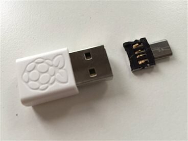

The second one, is this micro USB converter shim. Helps keep things compact as well!

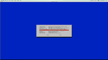

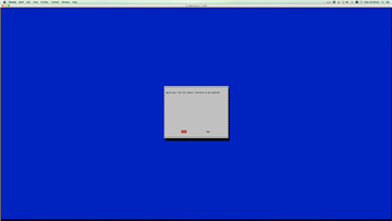

The first thing to do is to enable camera support using the "raspi-config" command. It doesn't matter which type or version of the Pi camera is used.
pi@zeroview:~ $ sudo raspi-config
Select the "Enable camera" menu, and when prompted, select the option to enable it.
Don't forget to reboot the Pi before trying to use the camera!

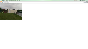

Depending on the selected resolution and frame rate, the result should look a little like this:
I was very impressed by the latency, as it is very low (less than a second) compared to what I've used in the past.

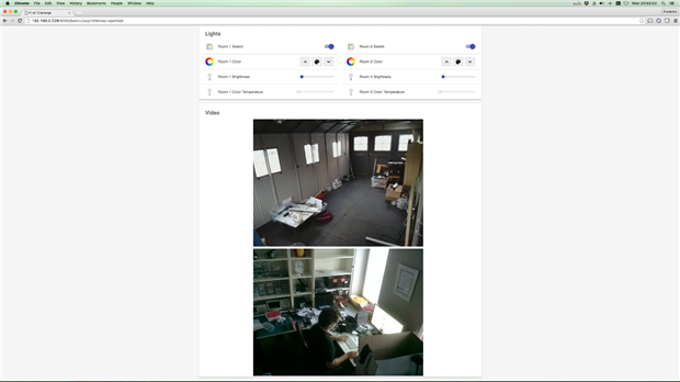

For the final part of this post, I embedded the two image streams in my OpenHAB installation. It only requires a modification in the sitemap, no items need to be defined:
        Frame label="Video" {
                Image url="http://192.168.0.125:8080/"
                Image url="http://192.168.0.166:8080/"
Refresh the OpenHAB interface, et voila, both streams are embedded:

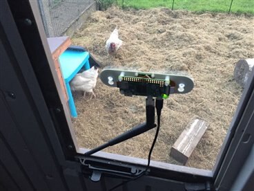

I moved one camera to the shed, and one to my lab. Yep, that's me writing this very blog post in the lower image image (And yes, I still have a lot of cleaning up to do!)
