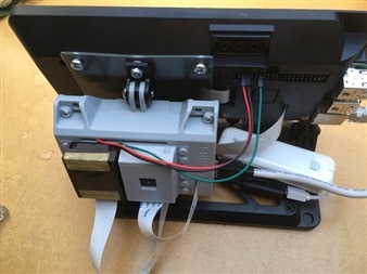

After quite a bit of hard work during the last days, the project reached its end. Of course many improvements can be made, and other features can be added, but that is for later, after the challenge. I had the plan to add humidity, pressure and temperature measurements with the SenseHat, but unfortunately SenseHat, Wi-Pi and PiFace digital were missing from my kit. I this post I will briefly explain the ndvicam.py python code which mainly does all the work. I will finish with a number of example images.

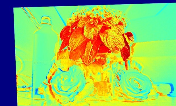

The prove of the pudding

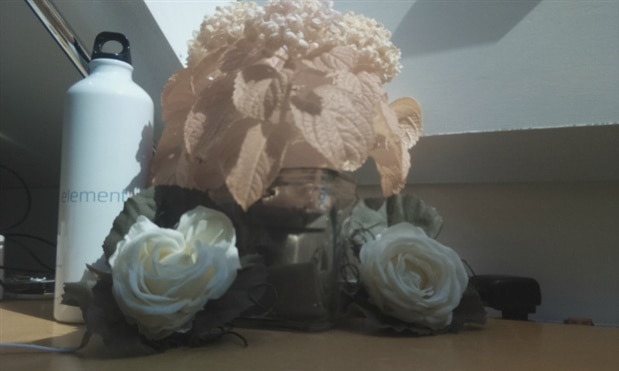

The prove of the pudding is the eating, so here are the images you have been waiting for so long.

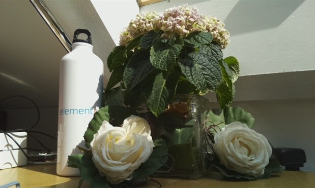

Here is a video of the setup. In front of the camera are a hydrangea plant and two roses.
This results in the following images:
The color image.
The NoIR image, which is the NoIR camera with the infra-blue filter attached. Note the different perspective on this small distance.

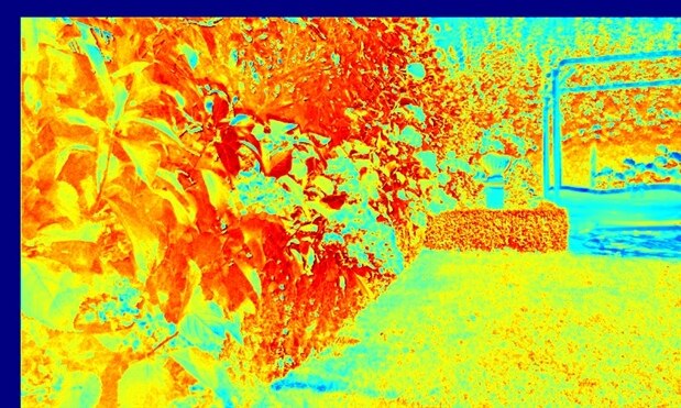

The two images are aligned using the HOMOGRAPHY algorithm, which you can clearly see in the blue border below.
A drawback of the HOMOGRAPHY is that it is quite time consuming. In this case, the ECC algorithm took almost 15 minutes image.
The NDVI image clearly shows healthy plant parts in read, while other stuff is in the blue-green range.
Note that the roses looks like very unhealthy! This is true, because they are fake.

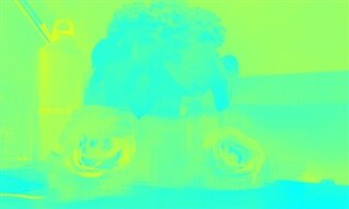

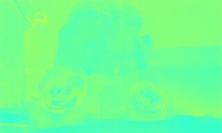

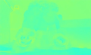

The BNDVI and GNDVI doesn't look very promising, I will investigate in this later.

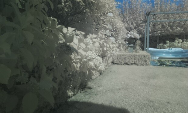

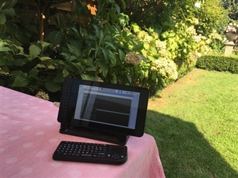

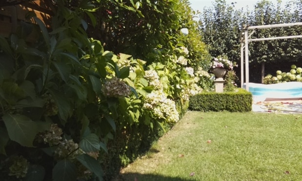

I also took my camera outside, powered by a USB power bank.
With the following results:
Here I used TRANSLATION for the alignment which works pretty well for objects at larger distance from the camera. It also is much faster, less than 30 s computation time in this case.
