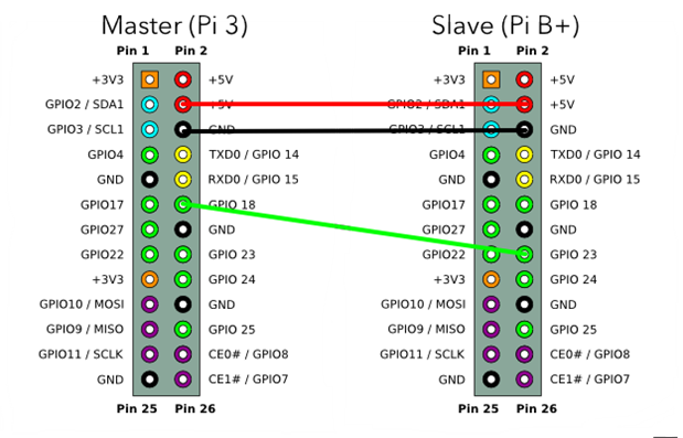

In the previous post I explained how the two cameras are combined, using the master and slave Pi. Here I will show how the two Pi's are connected hardware wise, and how the two images are taken simultaneously from the two systems.
Hardware setup
The power for the Pi B+ comes from the Pi 3's header block, as shown in the image below.
I wrote some python code which will run on the slave system. It will wait for a trigger pulse on GPIO 23 and then take an image and save it on the share as described in the previous post. The master system will output the trigger on GPIO 18.

    DAB , true it's not super time sensitive, but as the plants can move, for instance due to the wind, I prefer to take the NIR and RED image at the same time. Gerrit.
