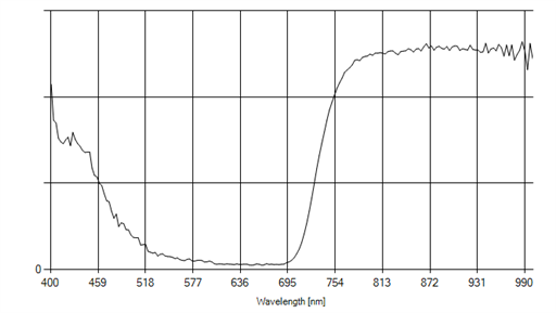

A few words should be devoted to the blue filter which comes with the PiCam NoIR. This filter is a so called ‘NGB’ or ‘infra blue’ filter.
It filters out the red part of the spectrum. I was curious about the transmission spectrum of the blue filter, so for the above mentioned readiest review I measured it with a spectrophotometer. Below is a graph of the measured spectrum.
So you can clearly see that blue (± 400 nm) green (± 500 nm) and NIR (> 700 nm) get through, while red (± 650 nm) is blocked.
So the GNDVI and BNDVI can be calculated from the three different bands of the Pi NoIR camera. Consequently no image registration is needed as the individual pixels of course perfectly match.

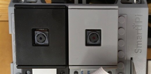

But I also like to have the possibility to measure the ‘real’ NDVI based on the red and NIR channel. In that case the bands come from different cameras (NIR from Picam NoIR and R from the standard Picam) and needs to be aligned. In the next section I explain how to accomplish this using OpenCV.

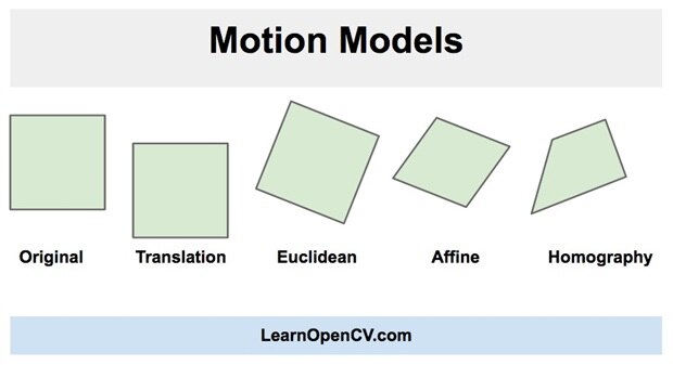

3- We need to define a motion model
(image courtesy of https://www.learnopencv.com/image-alignment-ecc-in-opencv-c-python/ )
We can do a Translation(MOTION_TRANSLATION), where the image only shifted. Only the x and y shift needs to be estimated. The Euclidean(MOTION_EUCLIDEAN) is a combination of translation and rotation, so there are three parameters; x, y and angle . The  Affine(MOTION_AFFINE) is a combination of rotation, translation ( shift ), scale, and shear. This transform has six parameters. The most advanced transformation is called Homography(MOTION_HOMOGRAPHY) which adds some 3D effects to the transformation. This transform has 8 parameters.
Since the cameras are placed next to each other a translation over 1 dimension ( x ) should in principle be sufficient, but since plants are 3D object I expect that the Homography is needed for situations where there is much depth in the images. Luckily using this OpenCV function we can easily test the different options.
