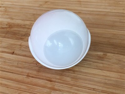

Light when and where you need it
80%
Sensors are placed in both the kitchen and the entrance room. The Core knows about them and as described in Core v2: A Java EE application rules are defined to turn the lights in those rooms on and off depending on movement and time. This works pretty well already!
To-do:
  • Further optimize the rules
  • See if improvements can be made by using iBeacons

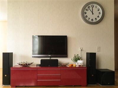

Home Cinema
30%
The Z-Wave hardware for the home cinema is in place (using a 6-socket PowerNode), so they can be turned on and off. As mentioned above the Plex and CEC libraries are work in progress. When these are there we can make a full integration.
To-do:
  • Finish Plex and CEC libraries
  • Set up a Raspberry Pi for the CEC communication
  • Integrate them with the Core
  • Add and integrate a DIY ambilight

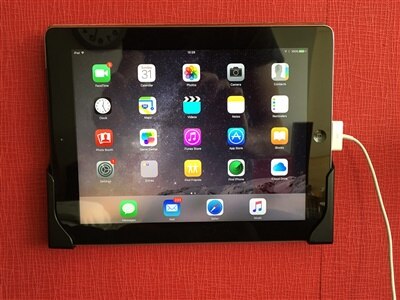

Mobile & On-The-Wall-UI
15%
Work on the iOS UI elements is just started. Further development of the iPhone and iPad apps depends on this. The iPad is already mounted on the wall though!
Todo:
  • Finish MQTT UIKit
  • Create an app for the dashboard (both mobile and On-The-Wall)
    • Provide basic actions (turning on/off device, triggering scenes and providing information)
    • Show the current movie playing in Plex and pause/start
    • Add speech commands
  • Create a custom app for the kitchen (either iPad or web)

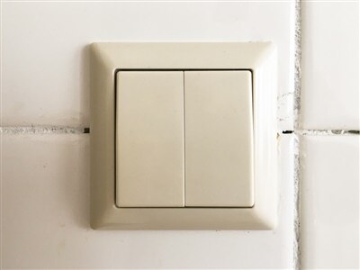

Manual override
80%
Most lights can already be switched manually using the buttons on the walls. Some of them should however be switched using the secondary button, which does a scene activation. I have to add support for this to the Zway-MQTT.
To-do:
  • Add support for secondary buttons in Zway-MQTT
