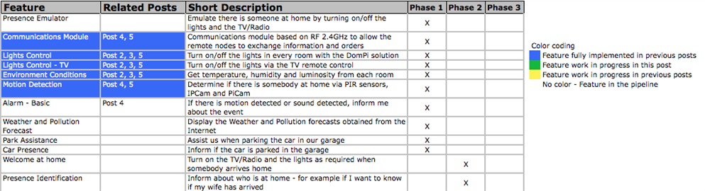

The kit arrived just in time and I have worked on setting up the environment for the Command Center, based on the Raspberry Pi 3. In this post I cover the initial Command Center setup, securing SSH with SSH keys, installing and tunneling VNC through SSH, a post focused mostly on security. But first an index to my previous posts for reference - thanks mcb1 for your suggestion last time - and the project status view.

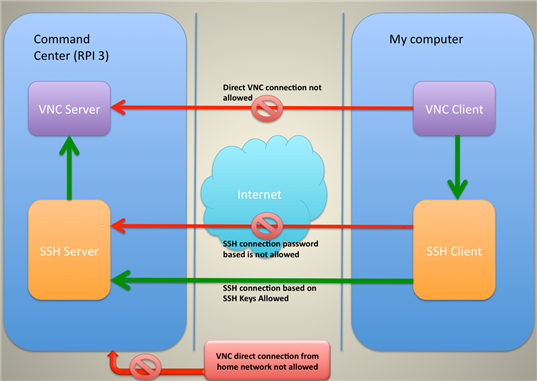

Tunneling VNC over SSH
As said above, it can't be strengthened enough the importance of securing devices exposed to the Internet. The tightvnc version says it transmit between devices without encryption. So the best I can do is to tunnel the VNC over SSH and achieve two goals at the same time:
  1. the data will be encrypted between my Mac and the RPI - specially important when I communicate to it over the Internet
  2. instead of only using a password to connect to VNC, this solution uses first the private-public key encryption as per above and then the VNC password, limiting brute force attacks - as I wrote in the first paragraphs, I learned this the hard way...
There are two parts, on my Mac and on the RPI.
Mac VNC over SSH setup
Starting by the Mac, there are as well two steps, first is a sort of ssh forwarding a local port to the correct RPI port and second is launching the VNC client against the local port instead of the RPI remote port. The ssh command looks like (and an explanation of the parameters can be found here):
ssh -L 5901:127.0.0.1:5900 -N -f -l pi 192.168.1.11
Since it can be challenging to remember the command image I just created an alias as per above:
alias sshvncint='ssh -L 5901:localhost:5900 -N -f -l pi 192.168.1.11'
Actually I created two alias, the internal one (above) and yet an external one that I use when not at the home network - just modifying the ip address and entering the router WAN´s  (remember to configure the routers´ports). When launching VNC, the address of the VNC server to enter is no longer the RPI IP address, but "localhost:5901" or "localhost:1" if you modify the VNC config and specify there the port to use in the Mac.
Force VNC to accept only SSH
In principle avoiding somebody from the Internet to access my VNC server without a SSH tunnel and the right private key should already be protected just by not opening the VNCserver port on the router. However, it does not harm to quickly setup the VNC to just accept sessions originated in the RPI or localhost and ignore the rest. To do so I edit again the file /etc/init.d/vncboot (see again this link ) and modify the appropriate line by:
su - $USER -c "/usr/bin/vncserver :1 -geometry 1280x800 -depth 16 -pixelformat rgb565 -localhost -nolisten tcp"
the -localhost parameter makes VNC to only listen to the port on the local interface and the -nolisten tcp disables the port 6001. Further info here.
To sum up, we have now a VNC server that only listens to connections on the local host, these connections can come from the RPI  or from the outside. If coming from the outside, they have to arrive via the SSH tunnel. To connect to the SSH tunnel, the client has to have the appropriate private key that the RPI will confirm against the public key. Besides that, once the connection with the VNC server is established, the server will ask yet for the VNC password. All in all, I'd say quite a secure communication to avoid exposing our network on the internet. This can still be improved by modifying the default ports of the SSH and VNC if you wish to.
