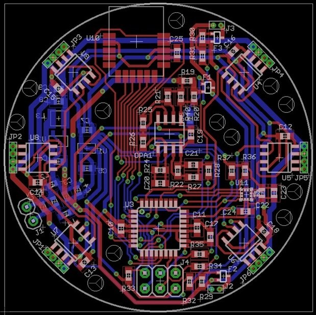

Things have been crazy here lately.  I have been very busy trying to finish out the interior of my new workshop, while attempting to keep my PiCasso project moving.  I have stuck in a re-design cycle, where I have been moving components from board to board, trying to get everything to fit, in a reasonable way.  After multiple re-starts on the design, I think I have a workable design.
There are several different requirements on the design that have made it fairly difficult to find the right approach.  Here are a few of them:
  • uniform LED spacing to allow proper illumination of the orb and to allow some 'animations' based on different LED color patterns and sequences.

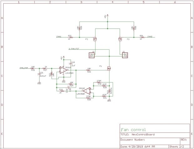

  • relatively high power (LED and Fan power)
  • fan speed control (based on programmable constant current)
  • BLE transciever
  • Magnetic compass and accelerometer
I went through several trade off, trying to keep all of the high speed stuff on a single board, versus the space required for connectors should I distribute the components across multiple boards.  Here is what I ended up with:

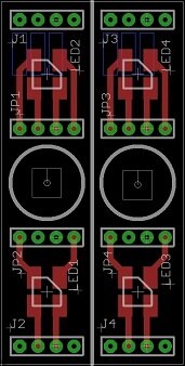

The Main PCB is riddled with 12 - 0.1" holes to allow additional air flow, through the board, into the fans below (there will also be some airflow around the board edges).  I will be trimming the PCB into a circle, as my PCB vendor (lower cost) only allows for rectangular boards.  The LED boards are sort of a universal design that will be connected to the main PCB, providing pairs of  LEDs along the circumference of orb and a single LED providing downward lighting (right angle mounted, hacked LED PCB).  This will provide me with 18 - fully programmable RGB LED to illuminate the sides and bottom of the orbs.

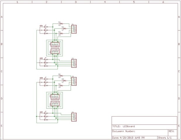

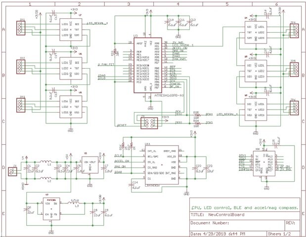

Here are the schematics of the main controller and LED board:

    genebren over 7 years ago in reply to dubbie +6
    Thanks Dubbie. I have been laying out PCBs for quite a while (45+ years). I go back to self etched boards, using resist pens, tape or photoresist film (1970's), through many different design packages.…
