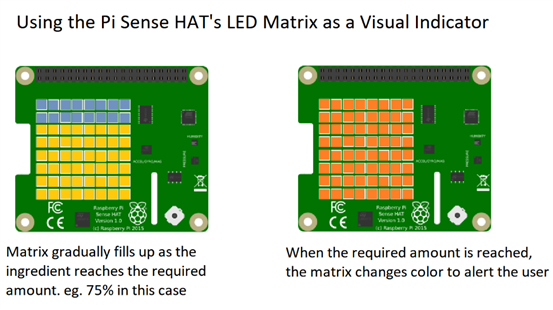

Now, the way I wanted it to work was to slowly fill up the grid with a certain color that correlates to the percent of the quantity added (if 50% of the required amount has been added, fill 50% of the pixels).
When the amount reaches close to the required amount (set at 97% here), the whole grid changes color to alert the user. That is what the outermost 'if-else block does.
  • If the value of percent is greater than 97%, it sets the value of the entire RGB matrix to GREEN
  • If the value of percent is less than 97%, it fills up the grid proportional to the percent - the 'else' block.

Why backwards? It's because the way addresses of the RGB LEDs on the Sense HAT have been defined. The first one (0,0) is the one on the upper-leftmost & (7,7) is the lower-rightmost.
I want the grid to fill from left to right starting at the bottom, which means that the order of reference of the rows needs to be reversed - which is done by running the 'row' loop backwards.
current = ((7-row)*8+col)
This is used to generate a pseudo value of the current pixel. The numbering starts from the bottom and moves left to right - in the same order that the grid needs to be filled.
I'm using this to compare the value of p (scaled percent relative to 64) so that the color of the LED can be decided.
Here's how it works:
The loop starts at pseudo value 0 (which is the lower left most pixel). Let's say that the percent of the ingredient added is 75%, which means that 75% of the grid needs to be filled, or 48 pixels. The color for 'filled' pixels is PALE_RED, and unfilled pixels is PALE_DON. The loops start at the lower left most pixel (pseudo value 0 - row 7, column 0) and increase (they move right along the bottom row). This covers pseudo values 0 to 7  (from the formula of current). The value of p (the scaled percent relative to 64) is 48, so the 'if' condition sets all these pixels to PALE_RED (since they're filled because pseudo value is less than 48). The loops now move to row 6 and move left to right from column 0 to 7 and set all the values to PALE_RED.
This continues till the value of the pseudo value of a certain pixel exceeds the value of p (scaled percentage), and the remaining pixels get set to PALE_DON
This video illustrates how it works. I wrote two consecutive loops that call the drawPercent() function with the value of the loop counter. The first one counts from 0 to 100 (therefore it fills the grid from 0 to 100% in steps of 1%), after which the second loop runs, which counts from 100 to 0 in steps of 1 (causing the grid to 'un-fill'). Whenever the value of percent passed to drawPercent() is more than 97, it turns the entire matrix green.

    Nice simple user interface. Have you considered having the display go red should the user put too much of something in? DAB

    Very nice display usage.  Giving the user feedback will make the weighing process more intuitive.  I think that the color changes are an added bonus.  I did not notice if you showed what would happen on an over-weight condition, do you show how much over you are in a similar way?

    I'm working on the over-weight: anything more than 105% (or any other percent) will make the display flash yellow. Though, it'll need to work well enough that the user doesn't exceed 100% in the first place - removing ingredients from the mixing bowl isn't convenient at all.
    Instead of waiting till 97% to make the display flash green, I'm think of automatically switching the display to a 'detailed' mode at 92%. After this, it will change to a different set of colors and continue filling till 100, except now the full RGB matrix will cover 10% (instead of the original 100) - giving the user more detail than before.
    There are so many different ways of doing this, and I'm open to suggestions! image
