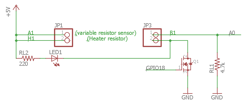

The sensor itself uses a negligible amount of current to run the voltage divider. However, each sensor include a heater circuit. The idea is to run the heater circuit every so often to burn off anything which has accumulated on the sensing element. According to the datasheet, the heaters consume about 1 watt of power. At 5 volts, this is 200 mA. If all four sensors' heaters were run at the same time, this would require 800mA, which is a considerable amount, even given the 2.5 amp power supply from Newark. To get around this, I am using N-Channel mosfets to switch the ground side of the heater circuit; and cycle through each heater one at a time. This will spread out the power consumption from being one large spike to one longer plateau.
Reading the sensor - circuit diagram
In order to get the data from the sensor, there are a few things that must happen. First of all, the sensor(s) is analog. It is designed to run at 5 V DC. It functions like a variable resistor; with lower resistance when the target gas is present; and higher resistance when the gas is not present. This means a higher voltage V(rl) with higher gas concentrations. The exact value of the load resistor can help 'tune' the sensitivity of the sensor within its sensing range. The datasheet specs out a 4.7k load resistor and they provide a graph showing the ppm versus voltage across the sensing range.
Schematic as shown in the datasheet:
For my use, I will be supply 5VDC to the sensor's heater circuit and switch the ground side with an N-Channel mosfet (IRLB8721PbF). That will look more like what I have pictured here:
The heater will run when I activate GPIO18 to complete the ground circuit. This will also let LED1 turn on to show that the heater is currently running. A0 will feed into that analog to digital sensor detailed below. RL1 4.7k is the load resistor. This is required to create the voltage divider circuit.

    aspork42 over 8 years ago in reply to DAB +1
    Hi DAB, The four gasses that I have sensors for are all lighter than air according to their specific gravity. They should all rise up into the hood and up towards the celieng of the room. If I had chosen…
    Hi DAB,
    The four gasses that I have sensors for are all lighter than air according to their specific gravity. They should all rise up into the hood and up towards the celieng of the room. If I had chosen a CO2 sensor then I would need a sensor on the floor since it is heavier than air.
