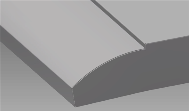

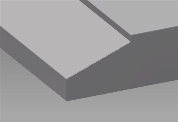

Most of what was done in Inventor started with a very basic sketch. They say if you're drawing more than rectangles and circles, you're over-thinking things. I started with a rectangle which was 40.25" x 12". Then I used the "flange" tool which makes a bend in the sheet metal, and dictated that it be ~5" tall to create the rear panel. Then another flange was created on one end of the rectangle for the right side of the hood. The process continued of creating flanges and bending the part usually at 90 degrees and that got me through most of the design process. I created the bolt patterns using a "point" then creating a "hole" with them. This allows precise placement, and the hole feature allows many useful features such as counterbores and chamfers.
I spent a lot of time in this design process thinking about how to make the sheet metal easy to manufacture. I am only planning to make a single piece, so want the fabricator to be able to easily create it. I need to know that they probably won't make a lot of money on a job like this, and if they make any mistakes and have to start over then they will likely lose money. If I was creating this commercially I could think about it much differently - the fabricator would probably make a nice jig and the could afford to waste a few pieces here and there across the 1000's or more units they build.
Probably very difficult to make "one" copy of:
Probably much easier to make "one" copy of:

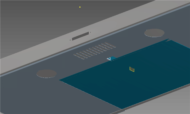

Another area I spent a lot of time on is relative to the placement of the sensors - I officially have the following which require being able to "sense" the range top - GridEye IR sensor, Raspberry Pi 8mp camera, DHT22 Temperature/Humidity sensor, and a total of four "MQ" air sensors.
I was considering using a replaceable panel on the insert which could have custom holes or a 3D printed section to hold the sensors. I later changed this to just some slots. This would be quite incognito for the current iteration as it will hide all the sensors; plus later on wouldn't look strange when this becomes a normal "dumb" range hood.

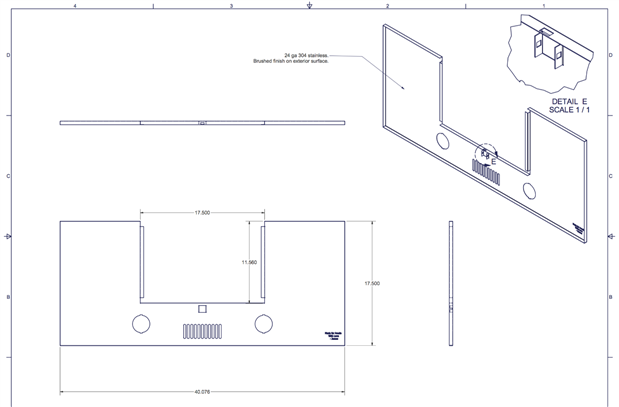

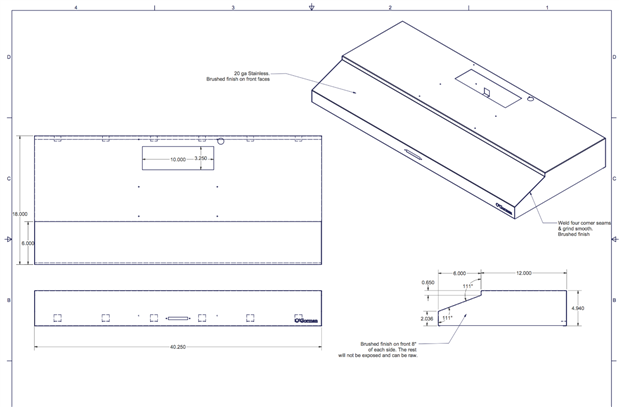

Final major mechanical components -
Here are the final components - I have attached the .iam, .ipt, .pdf, .stp, and .stl files for all of this to the post (archive.zip). If you want anything else, please let me know. I sent the PDFs and also created a .dxf file for the manufacturer. The PDFs attached to this post show all the major dims of this component.
More information / Use caution when doing a project such as this!!!
Please keep in mind that a project like this requires working with mains voltage. In the US this is 110 volts AC - that is more than enough to maime/injure/kill a person, or burn down their house while they sleep. Besides the obvious of crossing wires or forgetting to shut off mains when installing, improper grounding can cause a voltage between the hood and the stove which could kill someone. I do not recommend anyone else perform this modifications themselves unless they are or consult a licensed electrician. If you die or burn down your house, this is not my fault but your own.
imageHood7.pdf
imageBottomInsert2-1.pdf
Archive.zip

    Hi James, Very nice work you have done there with the design of the new hood. One thing that got me thinking was the positioning of all your sensors behind the cut-out slots at the very front, between…
  • beacon_dave
    beacon_dave over 8 years ago in reply to aspork42 +2
    This 32x24 Melexis sensor about to be released goes up to 300degrees for the object temperature, but the device itself is still is only rated at 85degrees operating temperature: https://www.melexis.com…
  • gecoz
    gecoz over 8 years ago
    Hi James,
    One thing that got me thinking was the positioning of all your sensors behind the cut-out slots at the very front, between the 2 spotlights. I'm not sure that will be an ideal position for the GridEye. Judging from the marks left on your mat, the 2 spotlights generate quite some heat. Those 2 heat emitting sources are mounted quite close to the GridEye, and will likely interfere with it when switched on.
    Another possible issue could be due to the proximity of the GridEye with the fan and the hobs: the aspiration system will probably cause an air flow to hit the sensor, and vapour/fumes/grease might end up on the sensor's lens. Protecting the lens is not a trivial task, as you need to find the right material that is transparent to the IR spectrum the GridEye is sensitive to (5 to 13μm - Far IR). I remember trying placing the GridEye behind a common glass pane during the 1-WireRegistered Grid-EYERegistered Sensor w/Arduino-Compatible PCB Roadtest, and it completely obscured the sensor.
    Perhaps, before finalising your desing and commit to its production, it is worth try testing the sensor, placing it in different spots and check its response during normal operation (i.e. while cooking on the hobs).
    Keep up the great work.
    Fabio.
  • aspork42
    aspork42 over 8 years ago in reply to gecoz
    I ran into the same issue when I did my Smart backsplash - https://youtu.be/M_df6y9scc4  - I wanted a PIR motion sensor hidden in the wall so it would provide pathway illumination. The glass tile blocks most IR light. I settled for just the capicitive touch sensors and a light sensor (Which ended up with greatly reduced sensing ability).
    The bigger elephant in the room is the sensing range of the GridEye which only goes up to 80 C so even a lot of boiling water will saturate the pixels. I am hoping this doesn’t damage the sensor. I am choosing to pursue using it anyways as a proof of concept and will keep in mind that the sensor isn’t exactly suited for the task. I will reach out to some friends who know optics and see if they have any recommendation.
