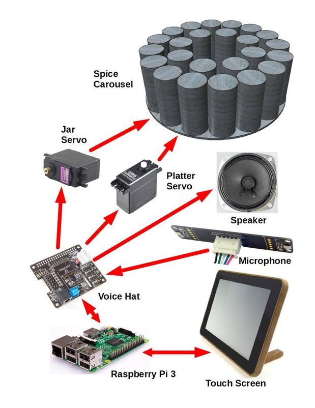

Spice of Pi Hardware Block Diagram

The Voice Hat has connectors for 6 servo motors, 4 of these will be used for the spice carousel. Each of the two servo motors will require a servo channel plus an extra channel to turn off power to the servo motor when there is no activity.
