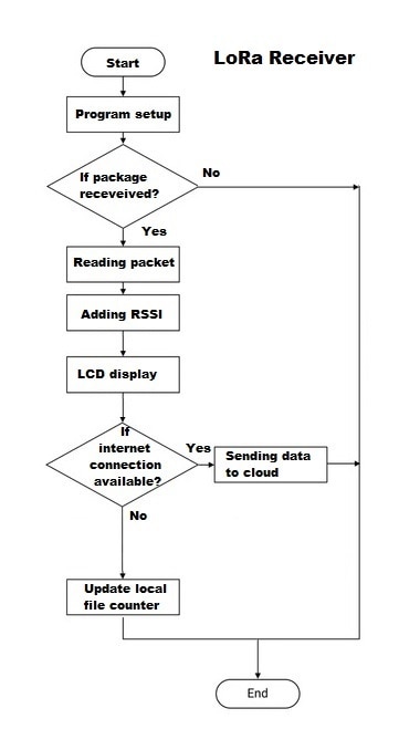

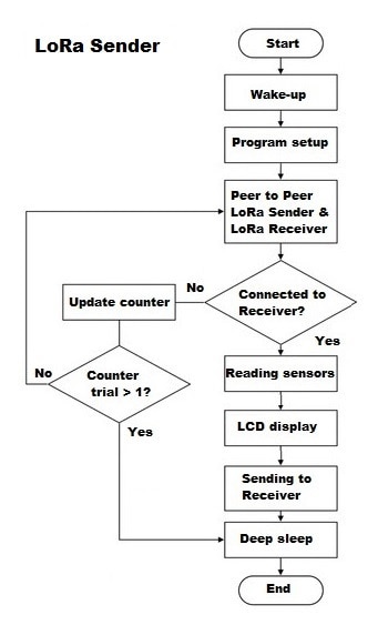

Here I show you a description of my project, goals, schematic diagram, necessary hardware and software. If you have read all the chapters, you should know that my project was divided into two parts: 1) Bees Monitor With Predators Repellent, and 2) IoT Ambient Monitoring System. Below I show you the flowcharts.

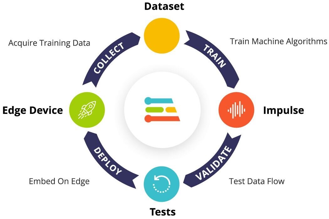

  • Here I take the first steps to use the Edge Impulse platform, which helped me to make my artificial intelligence model. To start, I followed the steps in this arduino tutorial: https://docs.arduino.cc/tutorials/nicla-vision/image-classification
  • This tutorial shows you the basic steps in image classification with Edge Impulse, however it uses very simple objects (fruits) with few features and for this reason they got a precision of 100% and loss of 0.06 which are perfect values.
  • Bees, spiders and wasps have many features such as color, size, shapes, weight, texture, etc. In my case I had to make three models because the first two didn't work for me.
  • The first model gave me an accuracy of 70.5% and a loss value of 0.89. Here I used 1200 images of bees, spiders and unknown.
  • In the second model I added more images to increase the accuracy up to 98.8% and loss value to 0.05. However, I discovered that the model used up to 2.7 MB of Flash memory and the Nicla Vision only has 2 MB.
