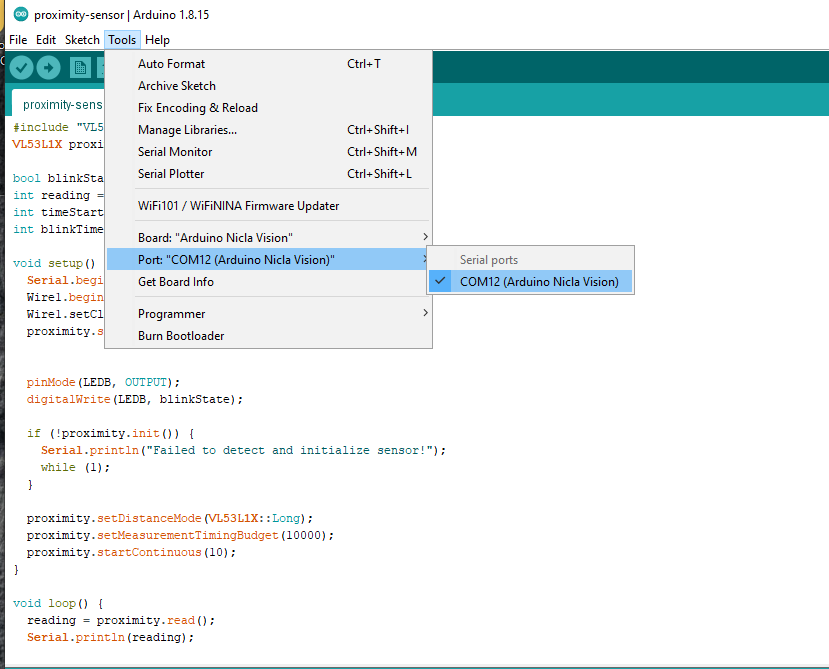

In my case I configure my board with Arduino IDE version 1.8; wow we need to navigate to Tools > Board > Board Manager.
This will open up a new window, with all available cores. Find the one named Arduino Mbed OS Nicla Boards and install it.
When it is finished, it should say  "INSTALLED"  under the title. Exit the board manager, and go to Tools > Board > Arduino Mbed OS Nicla Boards. Here you can see all the Mbed boards listed, where you can select the board you are using. You have now successfully installed the core.
On Nicla Vision you can test an example code. So when you have selected the USB connection port of your board, please use the File > Examples > Nicla_Sense_System > Blink_Nicla
In my case, I successfully tested the Proximity Detection with Arduino Nicla Vision example. Below I show you the code:

Here the VL53L1X library for Arduino
In my case the connection was via USB 2.0 through the COM12 port

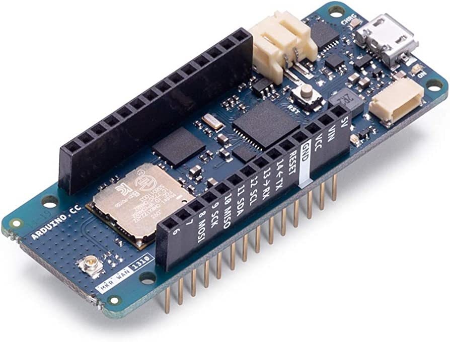

Arduino MKR WAN 1310 Setup
The Arduino MKR WAN 1310 provides a practical and cost effective solution to add LoRa connectivity to projects requiring low power. This open source board can connect to the Arduino IoT Cloud, your own LoRa network using the Arduino LoRa PRO Gateway, existing LoRaWAN® infrastructure like The Things Network, or even other boards using the direct connectivity mode.
Here we need to navigate to Tools > Board > Board Manager.
This will open up a new window, with all available cores. Type in "samd"  in the search field, and install the Arduino SAMD Boards (32-bits ARM Cortex-M0+) core.
In my case update the library to version 1.8.13
Exit the board manager, and go to Tools > Board > Arduino SAMD Boards (32-bits ARM Cortex-M0+). Here you can see all the SAMD boards listed, where you can select the MKR board you are using. You have now successfully installed the core.
When you have selected the USB connection port of your board, you are now ready to start using your board! The easiest way to check that everything is working, is to upload just a simple blink example to your board. This is done by navigating to File > Examples > 01.Basics > Blink.
