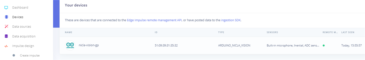

In the "Devices" tab I have connected the Arduino Nicla Vision board as shown below.

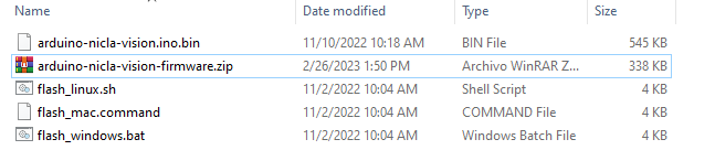

Here I show you the downloaded files:

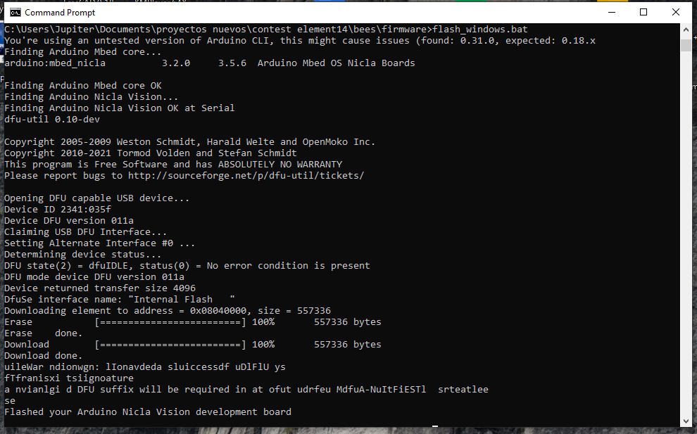

Open command prompt and run "flash_windows.bat".
We can check the installation by running: "arduino-cli" as shown below

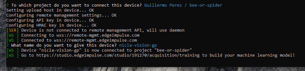

Once the Arduino CLI is installed, you can connect to edge impulse with the command edge-impulse-daemon. I type my username and password, and once the Nicla Vision device is connected I choose the "bee-or-spider" project.
Finally, the system asks me what name I want to give to the connected device? I wrote "nicla-vision-gp"
Now the device is ready to use the Arduino CLI.

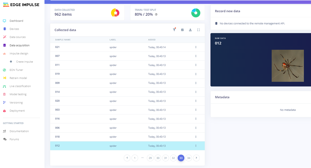

Data Acquisition

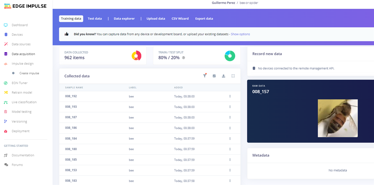

A good training model with Machine Learning needs a lot of images, hundreds or maybe thousands of photos. In addition, the images must be different, and its not possible to put repeated images. I got a lot of dataset bee and spider images on the kaggle website

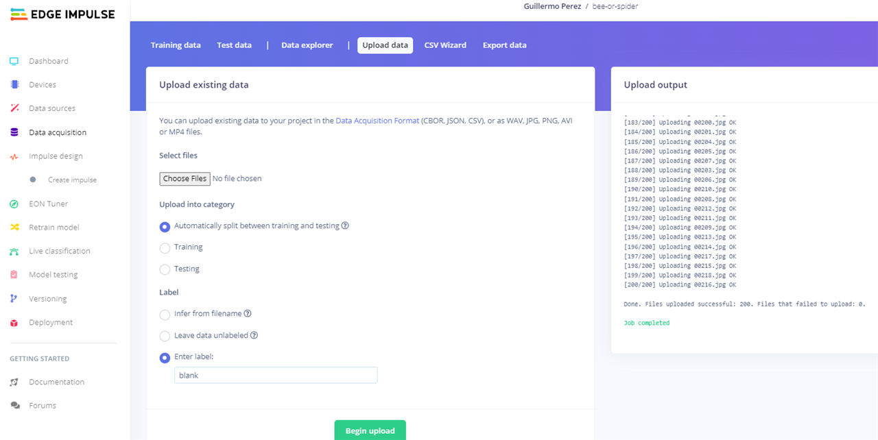

There are two ways to upload images to the project created in Edge Impulse, the first is using the tab tool: Upload data - Upload existing data
The other method is to use OpenMV with the tab: Tools - Dataset Editor - Export - Login to Edge Impulse Account and Upload to Project
Here I show you the image class called: bee
Now, the image class called: spider

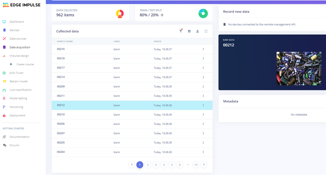

And finally the image class called: blank, which helps us to identify any object that is not a bee or a spider.
In total I uploaded 1200 images as follows: 500 images of the bee class, 500 images of the spider class, and 200 images of the blank class.
For the system to generate a good model, it is necessary to use 80% of the images as training and 20% as test.

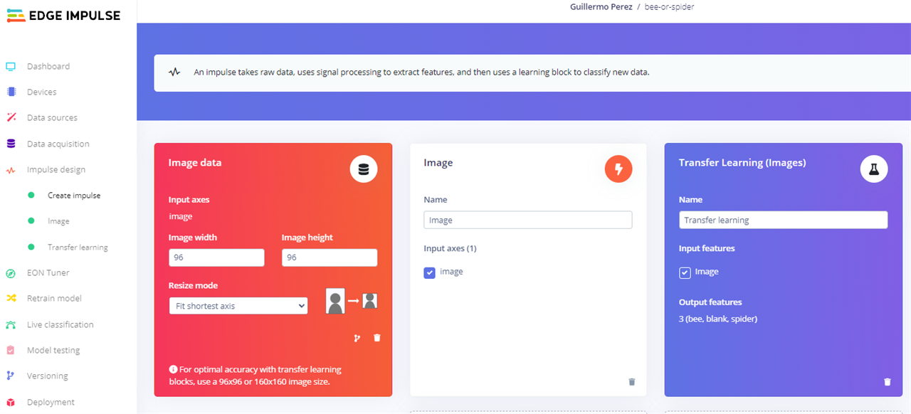

Impulse Design - Create Impulse
In the "Impulse design" tab, we open the "Create Impulse" section. We leave the default values of the Image data resource of 92x96 pixels. Add the resources "Image" and "Transfer Learning (Images)" as shown below. Finally click on the "Save Impulse" button

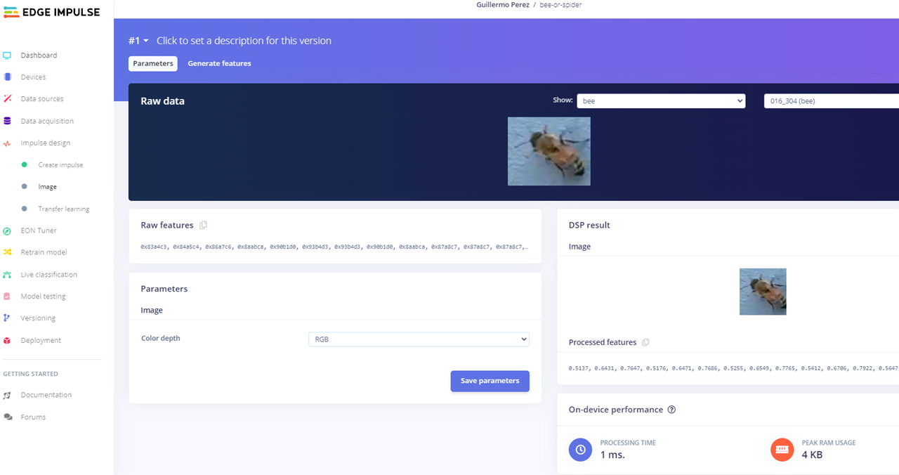

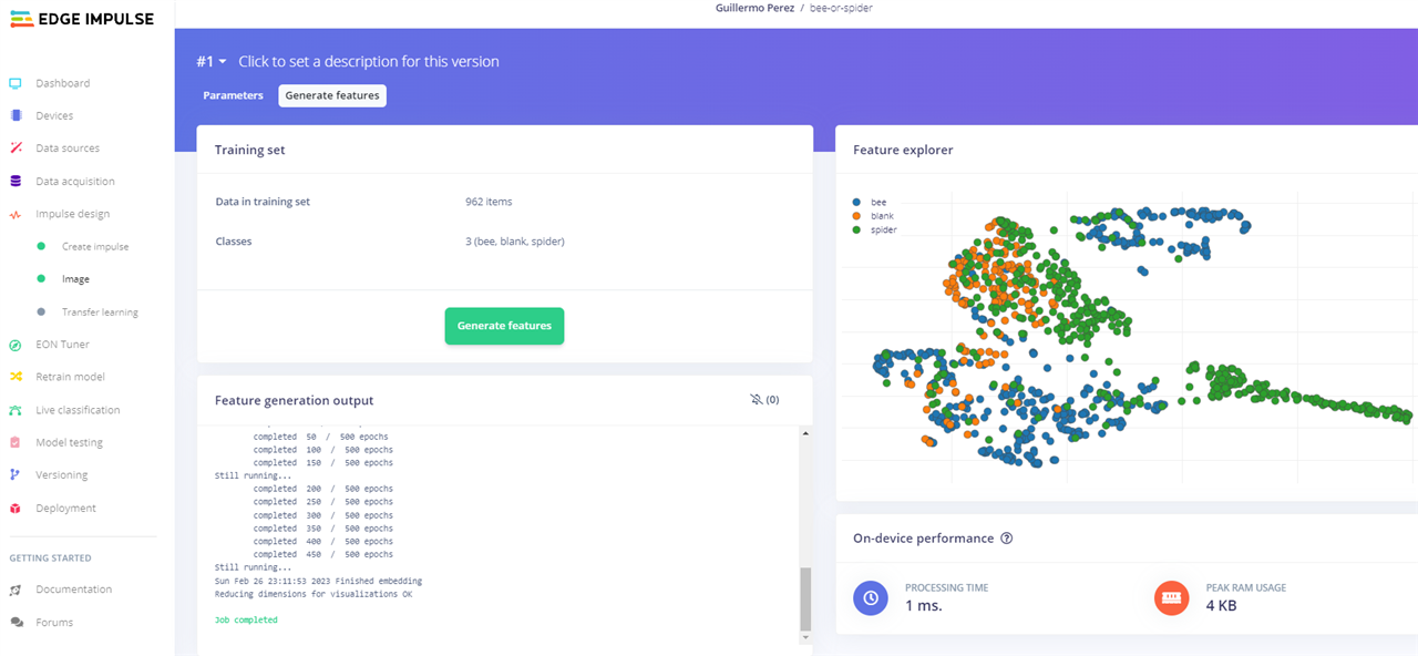

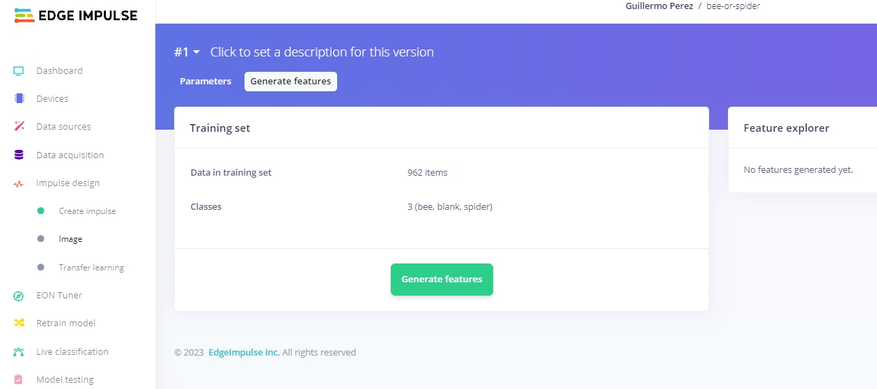

Now we open the "Image" section to verify the images of the classes and click on the upper section "Generate features"
Click on the "Generate features" button
After a few minutes the next features are generated.

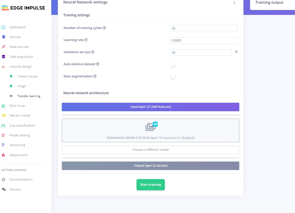

Impulse design - Transfer learning

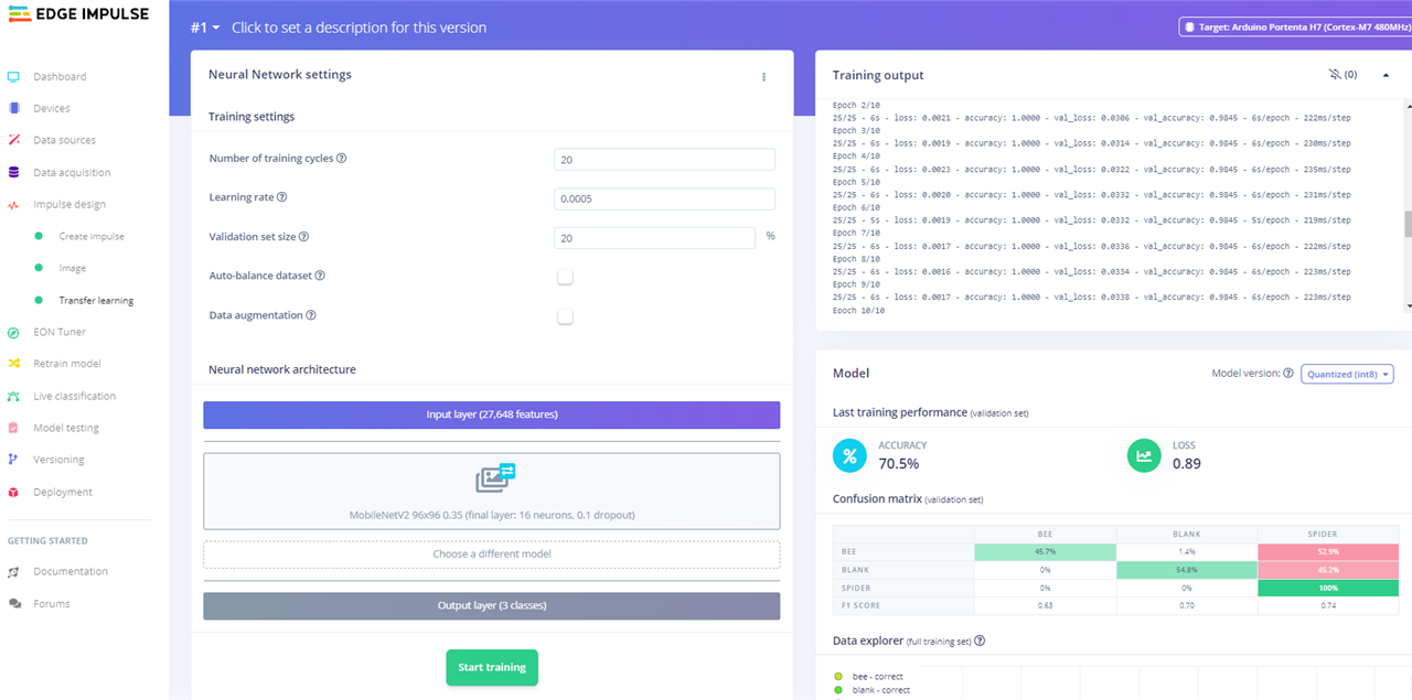

Now we open the "Transfer learning" section and leave the default values.

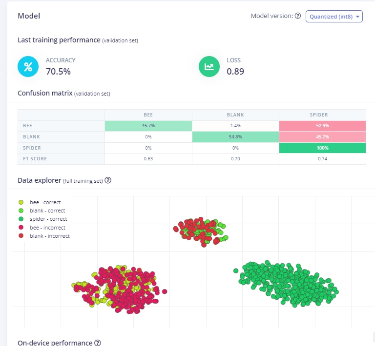

Click on the "Start training" button and after a few minutes the following training model is generated.
As we can see there is a precision of 70.5% and a loss value of 0.89. This means that its an average model, that is to say that its not good but its not bad either, so it needs changes to improve the model, and I will make these changes later. In the confusion matrix describes the performance of the classification model, and I can figure out where changes need to be made to improve the model.

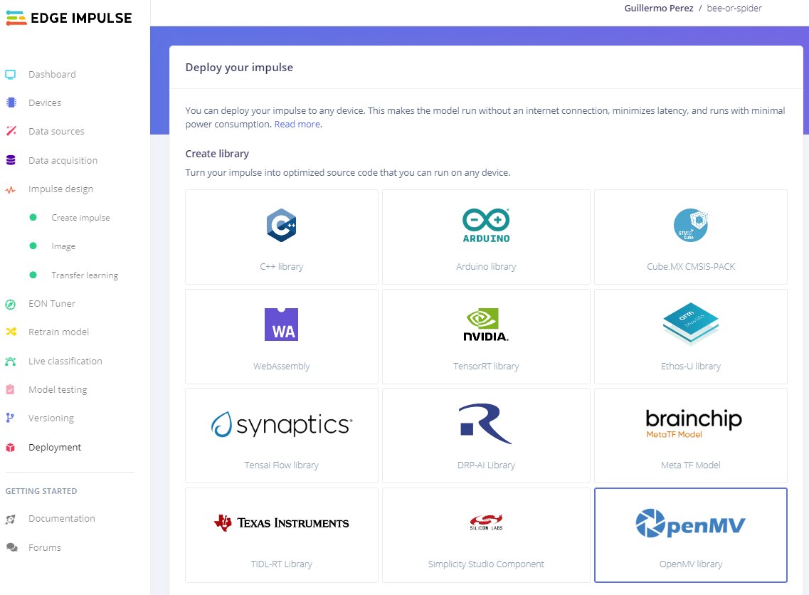

Deployment

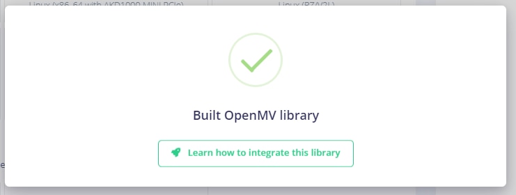

Finally we go to the "Deployment" tab. Here I select to create the "OpenMV" library and click on the "Build" button.
After a few minutes, the library is successfully generated and the next message opens:
The library is automatically downloaded to our PC computer (ei-bee-or-spider-openmv-v1.zip).
