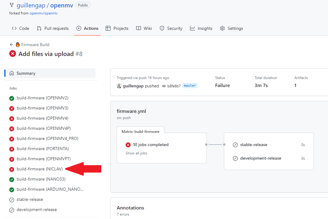

Reporting a Bug in OpenMV
If I increase the number of images samples, we can increase the accuracy scores and reduce loss value, however the size model will be increase above 2 MB. Remember that the flash memory of the Nicla Vision is 2 MB. The idea is to load the model in the flash memory because if we use the ROM memory to load the model and run the code, this will not work.Below I show you an error report that I had when I increased the number of samples.
So that you understand me, here are the details of the bug that I reported to technical support of OpenMV: https://forums.openmv.io/t/openmv-cant-build-a-new-firmware-for-nicla-vision/8200
