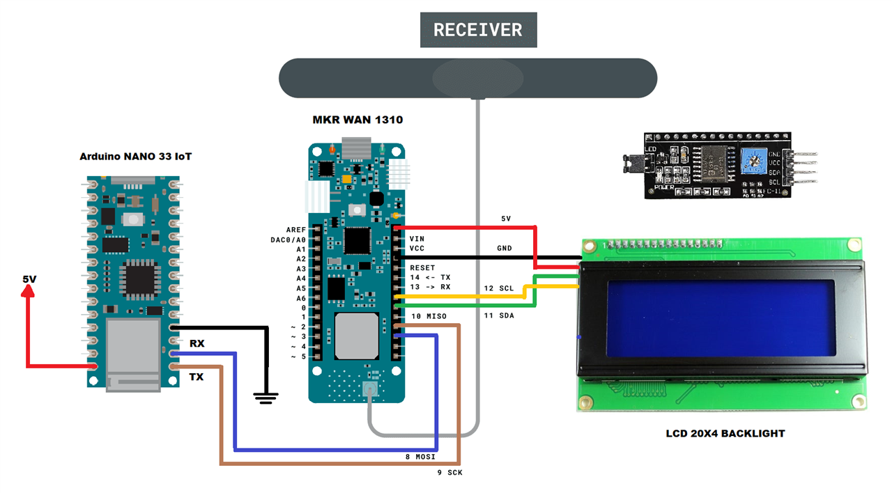

LoRa Receiver
How does it work?
  1. First you have to receive the data in a character string;
  2. I separated the data from the three sensors by means of a comma;
  3. The data is printed on the 16 x 4 LCD screen;
  4. The data is transmitted through the SERCOM 1 serial port to the Arduino Nano 33 IoT board;
  5. The Arduino Nano 33 IoT board sends the data to the ThingSpeak IoT service provider;
  6. Finally, these data can be consulted through the PC or through an IoT application;
Below I show you the code for the MKR WAN 1310 board.

Note: I have verified the SERCOM ports of the MKR WAN 1310 board, and they are compatible with the MKR WAN 1300 board: https://github.com/arduino/ArduinoCore-samd/blob/5dced38e81e6001a4b6e237e3462bc8db962127a/variants/mkrwifi1010/variant.cpp
Finally, below I show you the code for the Arduino NANO 33 IoT board.

Below I show you the assembled receiver module.
Now the two modules are ready for a test.
