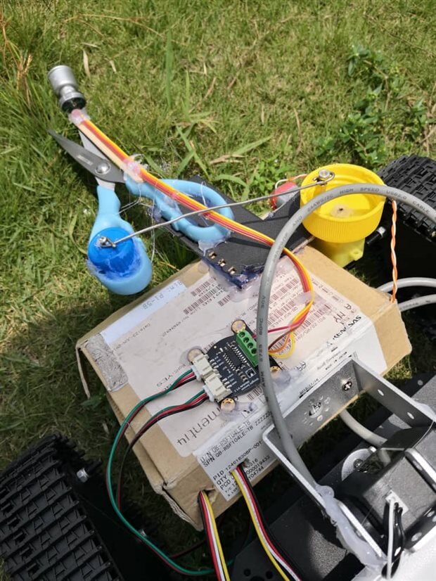

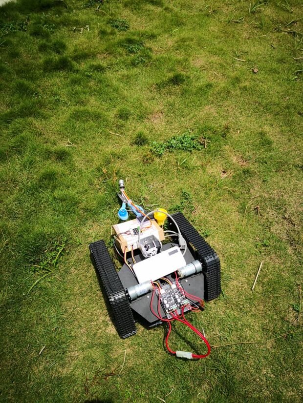

Really did a last minute rush to complete it, although very much scaled down in term of operation from what i originally envision
The bot with power bank to power up the Nucleo, load cell and Hx711 based board that utilize the load cell FX1901
the board is SEN0160

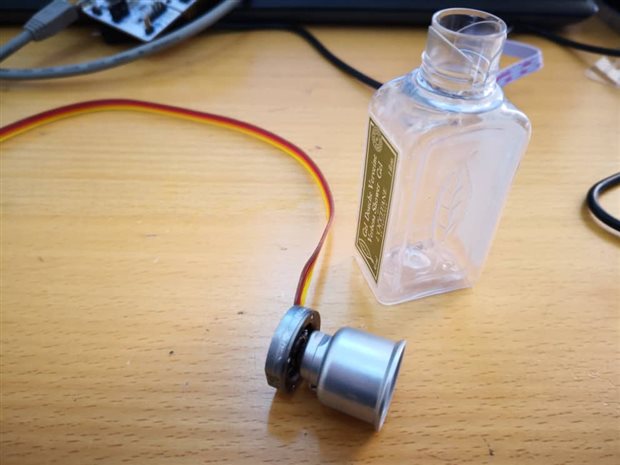

load cell FX1901 is mount in front of the scissor to sense any grass (hitting a big enough weed will give a reading to load cell)
The load cell is glued to an ice cream stick to extend it all the way up to the end. And a shampoo cap is mounted in front as 'finger'
see its testing in house at the video towards the end at Sensortile-Automatic Weeding Robot #14
it is a bit challenging to take video on the few occasion when it is actually working           this video shows testing without the front portion attached properly
What is working
it can run on grass with the 13A motor driver
sometimes the scissor successfully cut grass according to logic (sense grass only cut)
Shortfall
-it can run on grass but doesn't really follow any good logic. it just go ahead, sense the grass, and cut. Problem, is success rate is also 50% at best. the scissor easily runs out of power (due to driving it with F411RE pin)
-it cannot differentiate whether it is touching a grass or plant (well, originally i want to use camera to do that)...but lack of time
-the motorized scissor is too heavy, so i got to fix the entire RC servo with glue to hold it in certain position
-not manage to use SensorTile to connect directly (non BLE) to Nucleo
