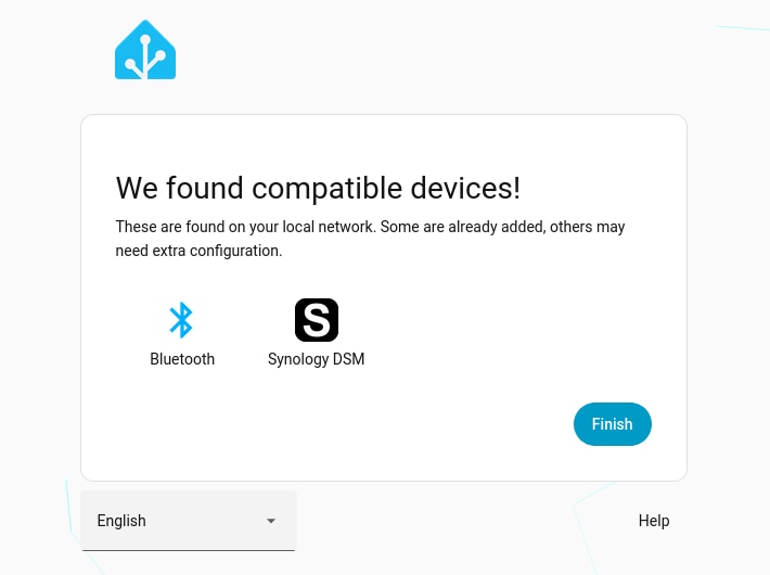

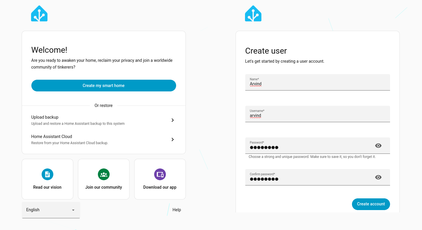

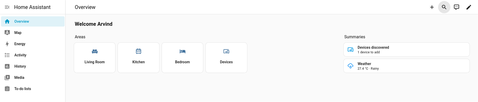

Once the pull finally finished, docker compose up -d came back in about a second and onboarding started right away - welcome screen, then account setup:
Then this, still inside onboarding, before I'd touched any integration settings myself:
HA had already found the Bluetooth integration as a compatible device on its own, off the UNO Q's onboard adapter. Perfecto

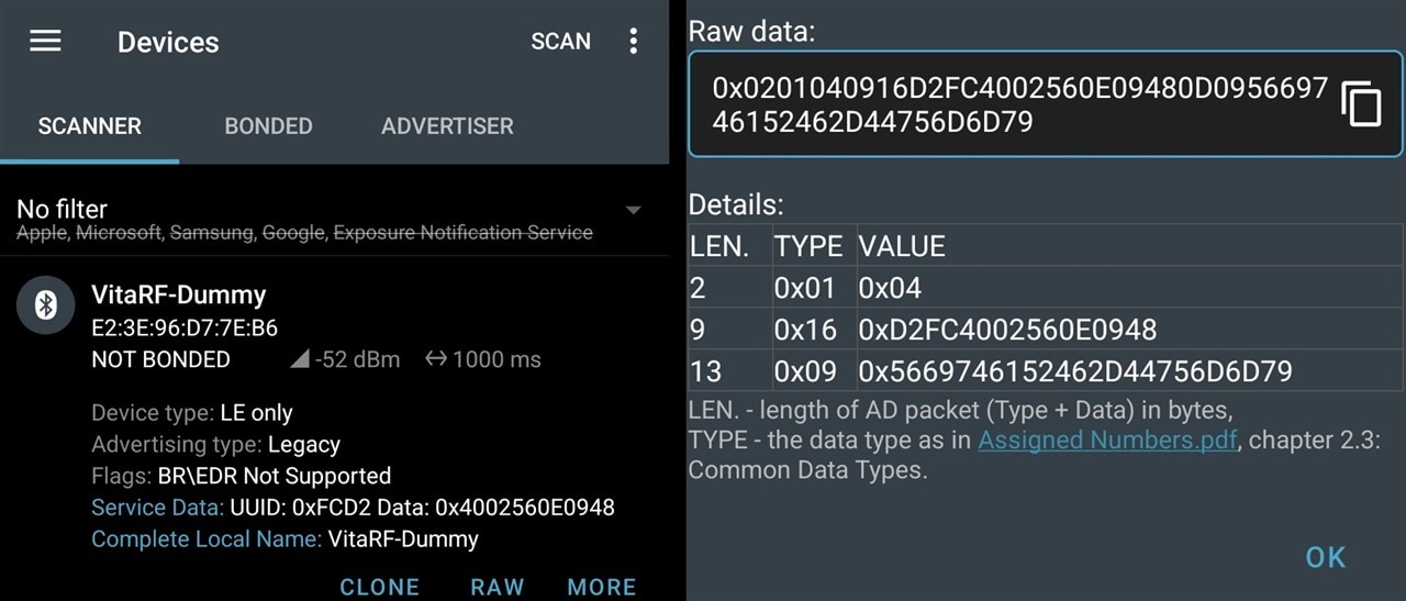

I checked the beacon data using nRF Connect on my phone - the live scan on the left, the raw AD structure breakdown on the right, Sweet - Working on the first try. Well, Actually my first try was to send a static value, Only in the next step I added the random generator.
VitaRF-Dummy, MAC E2:3E:96:D7:7E:B6, service data UUID 0xFCD2, 1000ms advertising interval - matches the firmware source. Three AD structures, exactly as built: Flags (0x01, BR/EDR not supported), Service Data 16-bit UUID (0x16, UUID 0xFCD2 + payload 40 02 56 0E 09 48), and Complete Local Name (0x09, "VitaRF-Dummy"). Decoding that payload by hand: 0x40 is the device-info byte, 0x02 56 0E is the temperature object (little-endian 0x0E56 = 3670 = 36.70C), 0x09 48 is the count object (0x48 = 72). Matches the firmware's startup constants exactly.

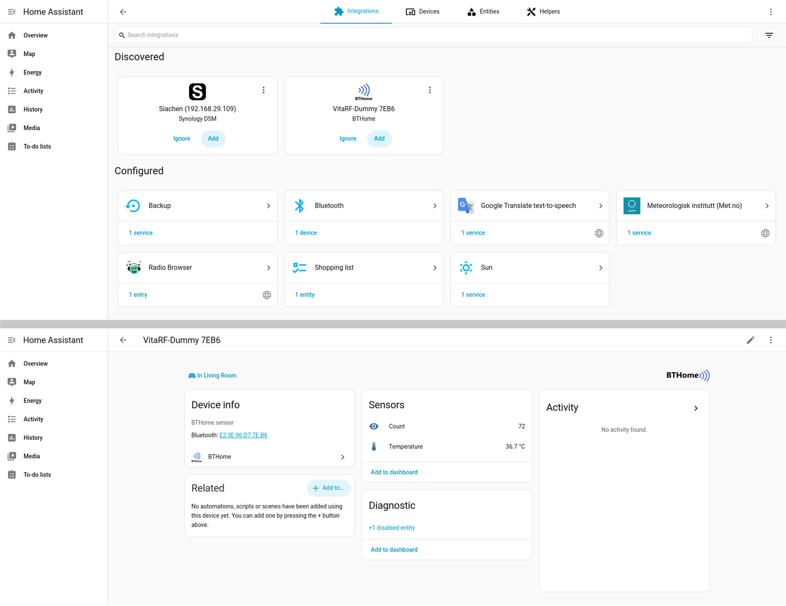

It shows up in Home Assistant
Settings -> Devices and Services -> Integrations, under Discovered: VitaRF-Dummy 7EB6 under BTHome, sitting right next to the Bluetooth integration that was already configured. Hit Add, and it's a device with real sensor readings:
Temperature 36.7C, Count 72. Straight out of the box picked up by the UNO Q's onboard hci0

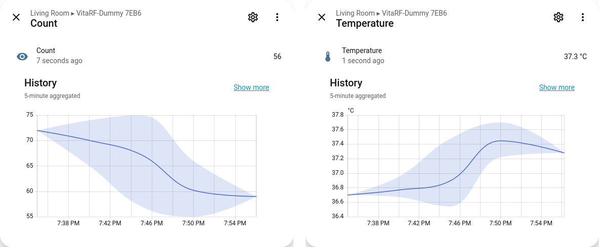

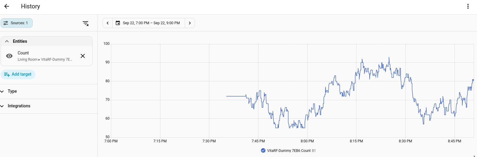

Left it running for a bit and checked the history graphs afterward, Count on the left and Temperature on the right:
 The Graph above shows Count (heart Rate) walking 72 down to 56, Temperature walking 36.7C up to 37.4C and then down. Now for a longer 2-hour window:
The Values kept changing regularly for the full two hours, no flatlines, no gaps
